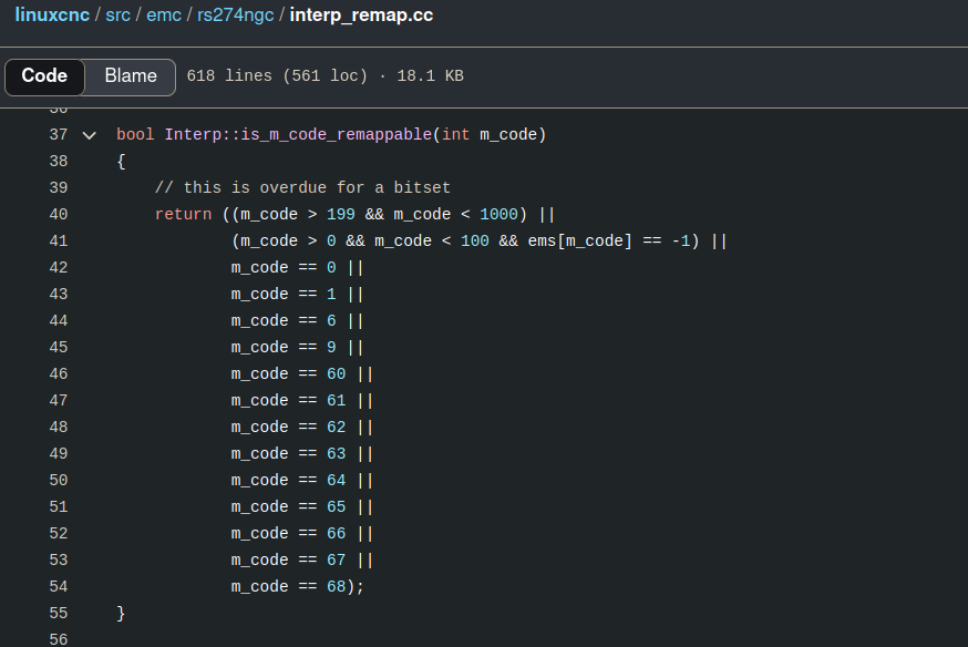

Replied by Aciera on topic Time to revisit coolant mapping of M-codes in Linuxcnc
I cannot test this right now but looking at this makes me wonder if it could actually be this easy to add 'M7' and 'M8' to the list of remap-able Mcodes (considering that according to the documentation 'M9' should not be a remap-able Mcode somebody already seems to have done or at least tried to do something like this) :
- Posts: 4819
- Thank you received: 2177
18 Oct 2024 14:50 #312547
Nor should M61 .. M68 be remap-able
linuxcnc.org/docs/devel/html/remap/remap...ng_codes_s_m0_m1_m60

18 Oct 2024 15:08 - 19 Oct 2024 02:45 #312549
Found the relevant commit, looks like the change would need to be done here (also)
'src/emc/rs274ngc/rs274ngc_interp.hh':
github.com/LinuxCNC/linuxcnc/commit/d731...f8b87d773bc7868288b2
I'll try tomorrow.

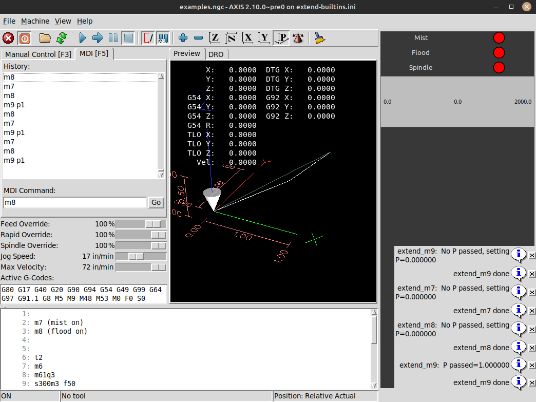

19 Oct 2024 05:29 - 19 Oct 2024 05:32 #312588
After a bit more effort it seems to work now with recursive calls as well. I modified 'configs/sim/axis/remap/extend-builtins/extend-builtins.ini ' in current master as an example for remapping the built in 'M7', 'M8' and 'M9' to be callable with an optional P word and recursively calling the built in Mcodes.
The patch looks like this:
This has been lightly tested. Maybe somebody finds this useful.

block->remappings.insert(STEP_M_9);This has been lightly tested. Maybe somebody finds this useful.
