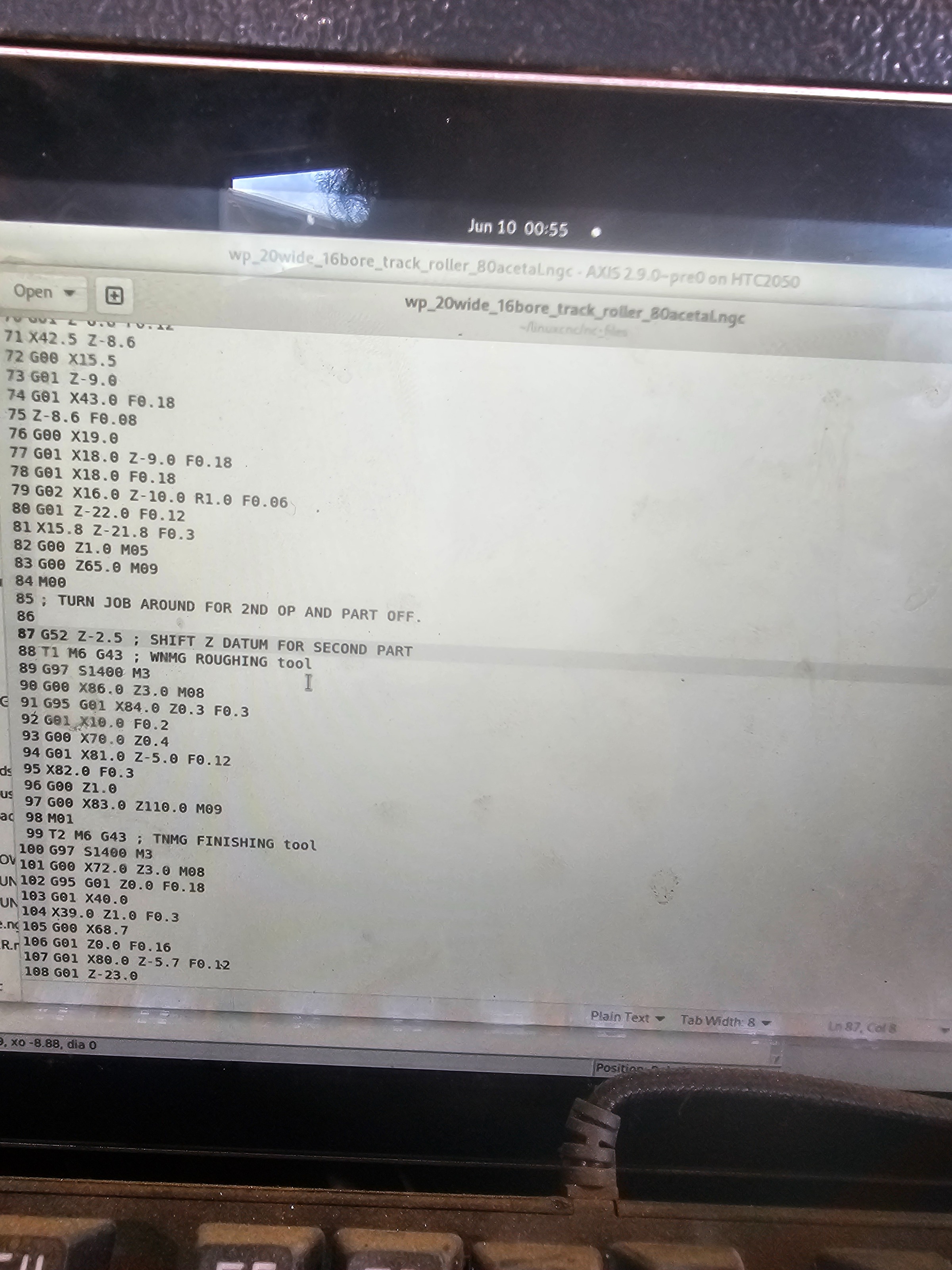

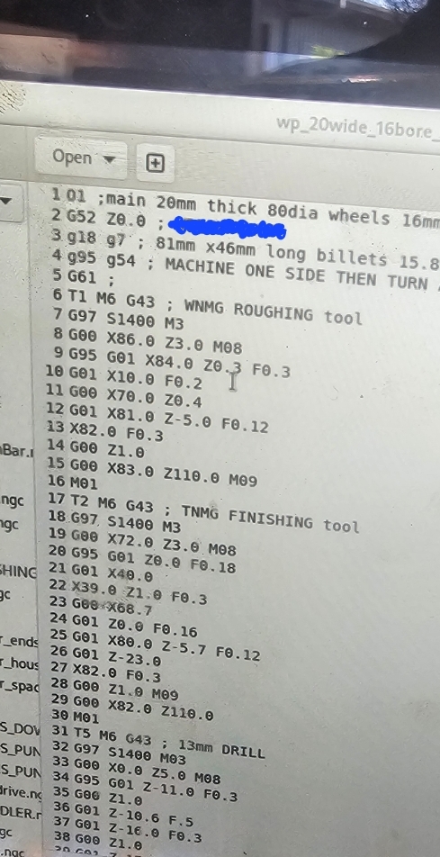

When I do a program restart (run from here) halfway through the program it looses the g61 command and radiuses everything shouldn't g61 be modal?

I generally measure on setup and restart at the m00, of course after setting g52 to z0 in mdi. The following pic is the problem.
