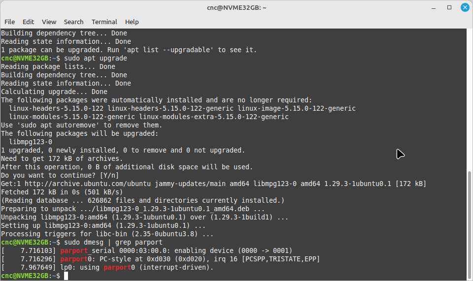

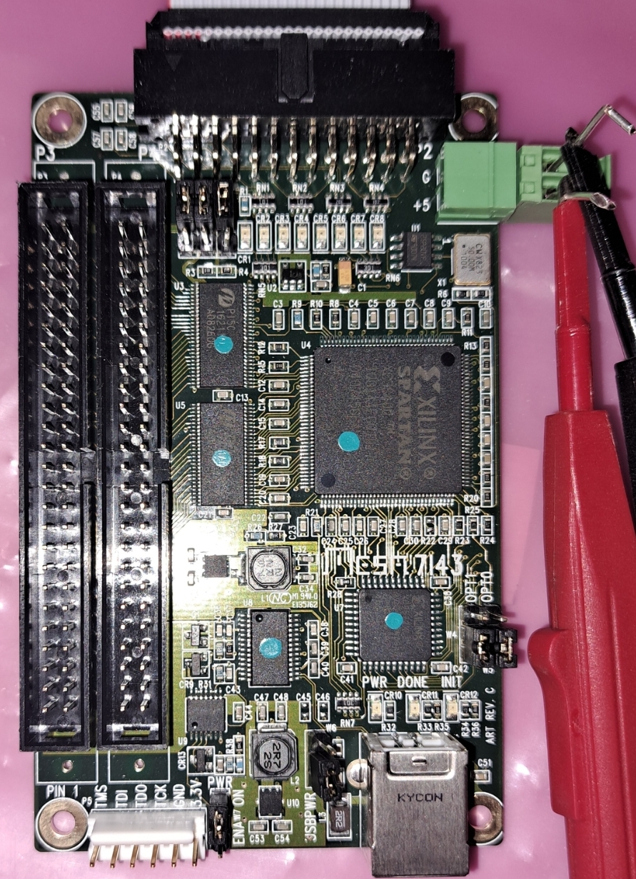

09 Nov 2024 13:19 - 09 Nov 2024 13:25 #314139
by juliankoenig87
Replied by juliankoenig87 on topic Suggestion for a PCI EPP card for 7i43
The card arrived. PCI to parport Sunix. Looks like it works.
But I try to power the 7i43 and it looks like it is faulty. With W4 and W5 down I can make the 3 leds on the bottom light a little bit at 2,9V and 0,5A. But at 5V and around 0,4A nothing shines anymore. Looks like somithing is wrong.
Last edit: 09 Nov 2024 13:25 by juliankoenig87.
- Posts: 18122
- Thank you received: 5337
09 Nov 2024 16:23 #314148
Replied by PCW on topic Suggestion for a PCI EPP card for 7i43
If you don't get a power LED at 5V, that's not a good sign
as it may indicate a 3.3V power issue (bad chip?)

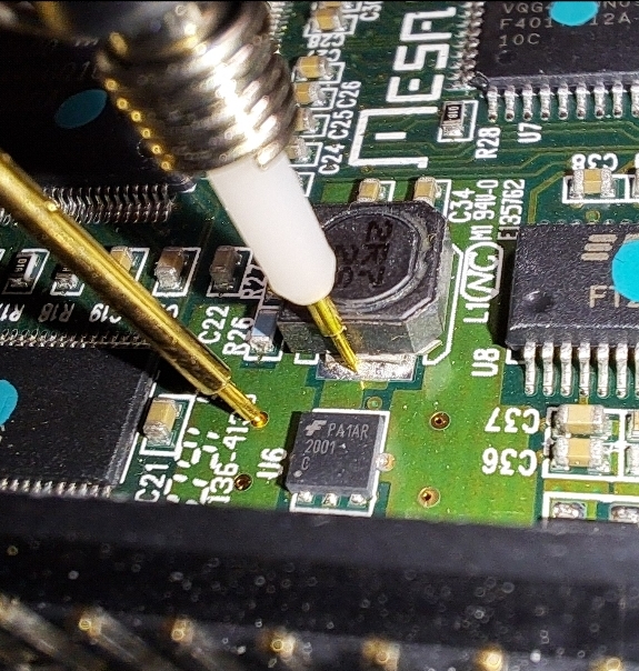

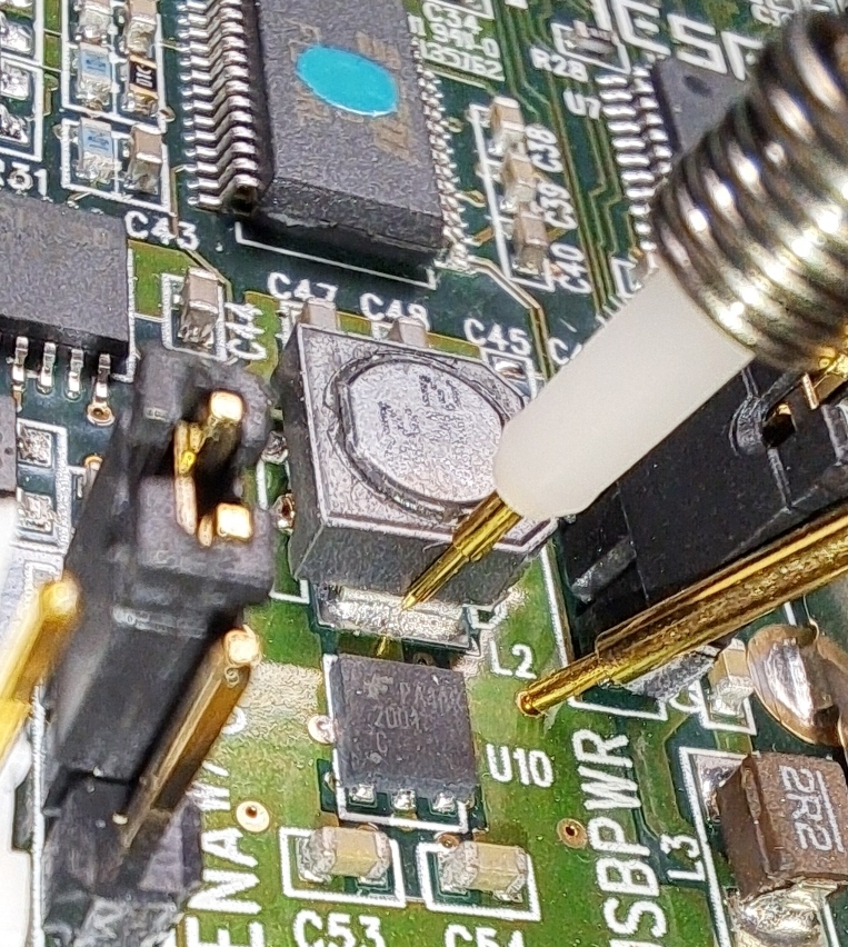

09 Nov 2024 17:25 - 09 Nov 2024 17:27 #314154
by juliankoenig87
I dont know. I bought it used.
U6 aprox. 1,23V
U10 aprox. 0,60V
Supply each 4,87V
3,3 V header also 0,6V.
So yes. Looks like a short in any chip.
U6 aprox. 1,23V
U10 aprox. 0,60V
Supply each 4,87V
Last edit: 09 Nov 2024 17:27 by juliankoenig87.
- juliankoenig87
- Posts: 119
- Thank you received: 55
09 Nov 2024 17:37 #314155
by juliankoenig87
Checked with ice. Maybe U9 gets a little to hot. Dont know yet.
- juliankoenig87
- Posts: 119
09 Nov 2024 18:02 #314158
by juliankoenig87
Ok. To me it looks like that the voltage regulators are fried. Maybe an overvoltage damage.
- Posts: 18122
09 Nov 2024 18:37 #314161
Could also be an almost dead short on the 3.3V rail.
If you have a lab supply you could set it to 3.3V,connect
it to the 3.3V rail and ramp up the current to see what
part(s) get(s)s hot.
Where are you located?
