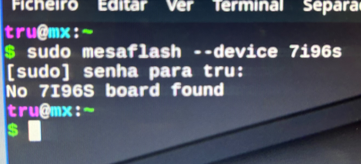

Hey everyone.

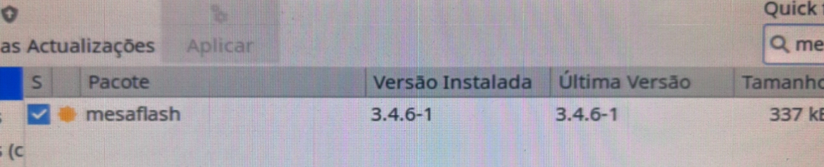

im trying to mesaflash the 7i96s_dpl for multiple encoder use. but I get consecutive errors of not finding the card. the card is connected at 10.10.10.10 and the lcnc works perfectly , 0.100 ms of ping, but i can’t identify it with mesaflash which is up to date.
any suggestions?thanks in advance.

1. do not use sudo, i do not think it is required
2. try this
mesaflash --addr 10.10.10.10 --device=ETHER --readhmid
If you did set the jumpers for 10.10.10.10 and the PC network accordingly.
2. try this

Hey. This isn’t working. I have disabled the IRQ coalesce so I’m using eth0 at 10.10.10.100 fixed IP address.
The ETHER card is not found
Neither is ETH0 or other names I tried typing

What does
ip a
report?
Also, you do need the --addr 10.10.10.10 if the card is set for 10.10.10.10
(or --addr 192.168.1.121 if the card is set for 192.168.1.121)
mesaflash --device ether --addr 10.10.10.10
ip a
report?
