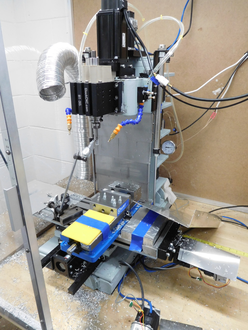

Oh, it is a little baby machine by many measures- 1 kW spindle, 12x6x10" XYZ travel or so, etc. Weighs, I dunno, maybe 500 lbs? I built it with a welded steel frame filled with epoxy granite, with proper linear bearings and ballscrews (to be fair, I got nice THK linear bearings, cheaped out on the ballscrews), so hobby bench mill sized, but with way more rigidity. The BT30 spindle is probably overkill, but it was available, and there's a lot of tooling options. TTS didn't seem like a great option, and ISO20 seemed too small.
Aside from this issue popping up, it's been a great experience coming from the gantry-style machine I'd been tweaking for years. The rigidity, Z height, and toolholders are the huge upgrades, but the MPG, touch probe, covered ways, coolant control, spindle/axis stall-detection, and servos are very nice as well. Having a spindle with enough torque at reasonable RPMs to actually handle (small) drills is still blowing my mind.
Sorry for the crappy picture- literally just walked over to snap it, so you can see it's a bit disassembled for debugging (and with random scrap taped over the t-slots so I didn't have to clean them out). That's a Kurt 4" DX4 vise for scale.

So... I go to reattach the Y servo so I can run the tests mentioned above, and... the bloody nut retaining the screw is loose?!?!? Apparently I somehow missed that despite specifically checking it earlier AND pulling on the axis and not seeing motion on an indicator. Not seeing a beating-head-against-wall emoji, so you'll have to imagine one.
This might be an easy fix... well, the machine at least. The operator/debugger might be a lost cause.
Still going to try to mitigate the electrical noise and replace the ballscrew either way, still going to run tests.
