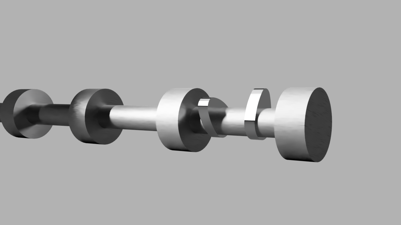

I have actually found 4 companies that make software, 1 of them is relatively affordable. The issue again becomes generating tools path. I am curious about the Freecad work offset bench however. does freecad support 4th axis or C axis work ? I was considering adding a indicator with a radius foot that could act as a encoder onto a set of centers I have laying around with a encoder to grab the pertinent data. Very open to ideas on all of this BTW. the air cutting issue isn\t that big of a deal. If I can figure out how to generate the roughing profiles on the C axis, I can add a spindle to my lathe, rough turn the camshaft and then rough in the cam lobes. Stand it up and drill the ends or do it as a C-axis drilling open for the locating pin or bolt up.
I am very open to suggestions on all of this BTW

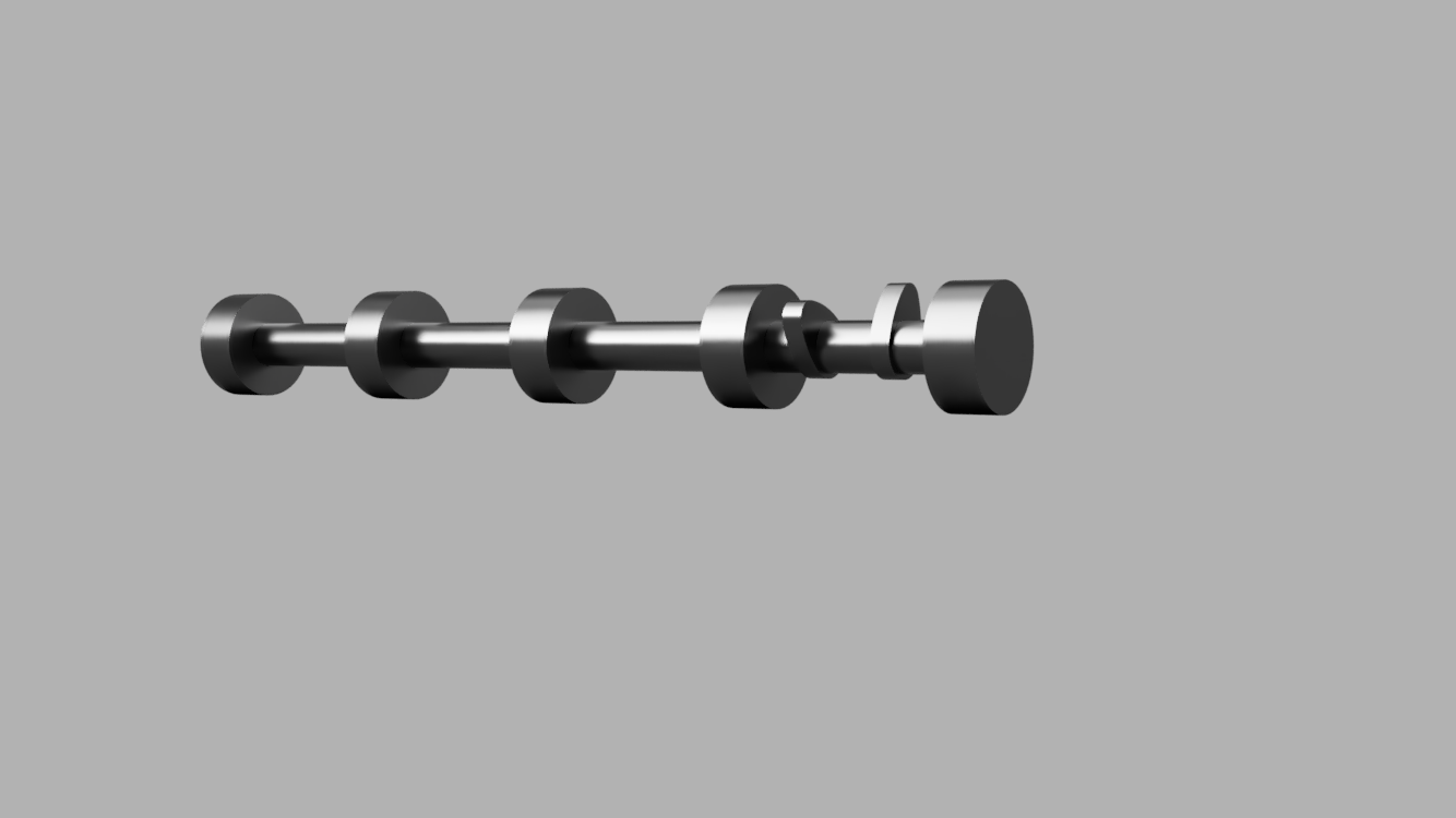

To have some 3d model, just to get the thinking going, would be nice.
Provided it is not "top secret" material.

29 Nov 2024 18:37 #315596
by smc.collins
Replied by smc.collins on topic Jones and shipley cylindrical grinder CNC conversion, grinding camshafts, cranks
attached object file in zip
