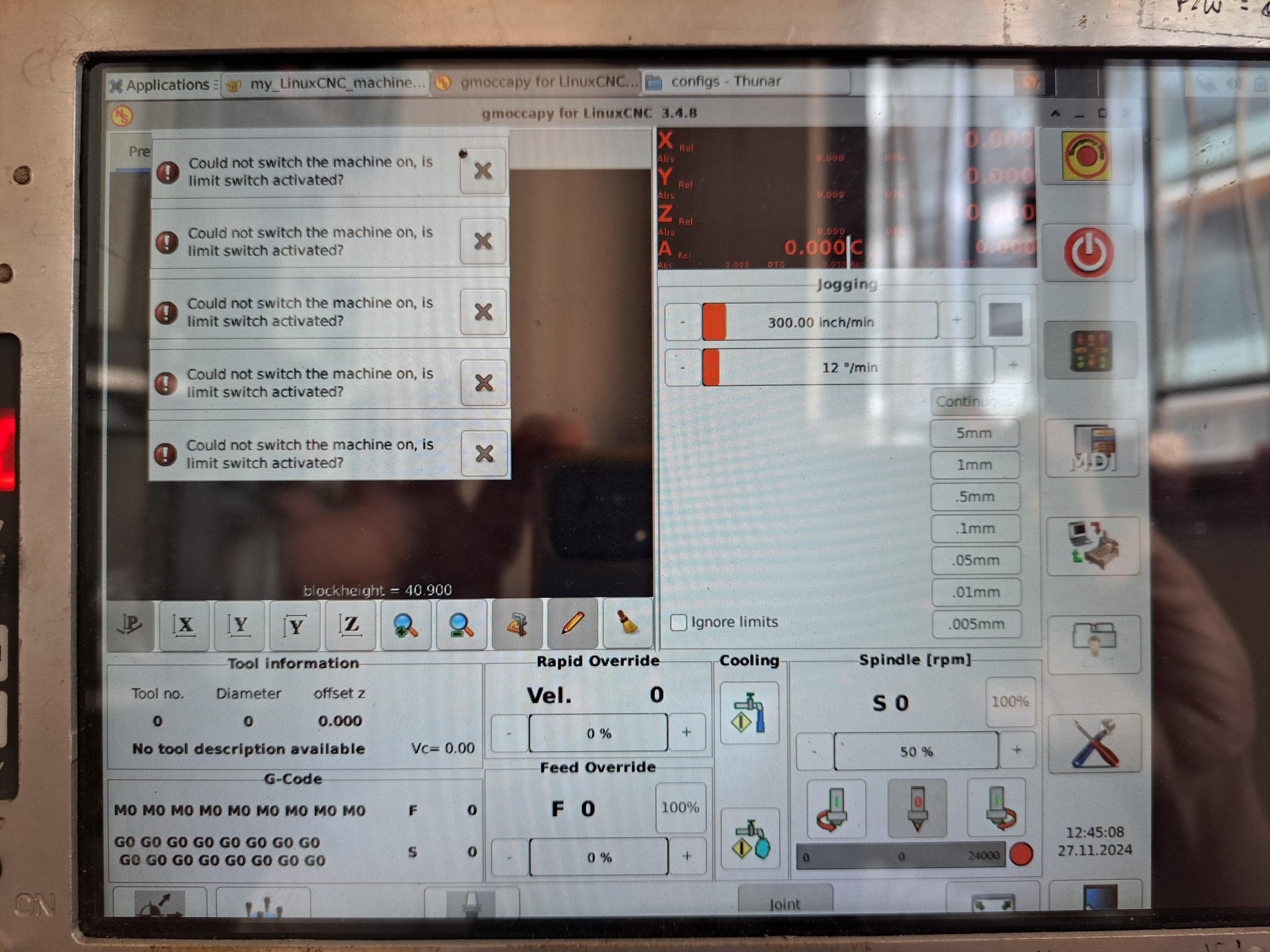

Hello,
As shown in previous message...
Recently, I wholly upgrade my Linuxcnc the the lastest version, after putting my orignal config files to the new Linuxcnc system, when Gmoccapy screen opens, all the original settings disappeared, what's the problem, how can it be resoved?

Replied by Aciera on topic Original Gmoccopy setting all gone
Which version did you upgrade from?
Last edit: 27 Nov 2024 06:44 by Aciera.

27 Nov 2024 06:53 #315369
by raychar
Replied by raychar on topic Original Gmoccopy setting all gone
upgrading from linuxcnc 2.8.4 and Gmoccapy version 3.0.91
to linuxcnc 2.9.3 and Gmoccapy version 3.4.8

27 Nov 2024 06:59 #315370
by raychar
As well, I replaced with a new mSATA drive in my mini computer for doing the whole update....just in case i can go back to old version. Will this afftect?

27 Nov 2024 07:32 #315372
Since you seem to be loading some custom panels you may have a Python/Gtk version issue. Linuxcnc version 2.9 and up no longer supports Python2 /Gtk2 but only Python3/Gtk3.
I would suggest to open a terminal (Ctrl + Alt + t) and start linuxcnc from the comand line:Choose your config and check the terminal output for errors.

27 Nov 2024 09:09 #315382
by raychar
I think I did the stupid thing that I copied old LinuxCNC startup icon from the old computer screen and paste to new one, I haven't create a new one instead. Let me check all the things first

27 Nov 2024 09:52 #315384
by raychar
Then, the Linux CNC Configuration Selector appears, on the left hand side, when I click all the showed ini files, the right hand side shows "No details available". Obviously, it didn't refer to mine one ? The path location of my ini. and other files are : /home/my_user_name/linuxcnc/config/my_LinuxCNC_machine. Are there something wrong?Since you seem to be loading some custom panels you may have a Python/Gtk version issue. Linuxcnc version 2.9 and up no longer supports Python2 /Gtk2 but only Python3/Gtk3.
linuxcnc Choose your config and check the terminal output for errors.

27 Nov 2024 10:43 #315389
Not sure but what you can do is this:
1. Open you config the way you are used to.
2. Close linuxcnc
3. open terminal and run (note the minus + letter 'L' which should automatically open the last config you used):
2. Close linuxcnc
linuxcnc -lPlease Log in or Create an account to join the conversation.

27 Nov 2024 12:06 #315397
by raychar
Not sure but what you can do is this:1. Open you config the way you are used to.2. Close linuxcnc3. open terminal and run (note the minus letter 'L' which should automatically open the last config you used):
linuxcnc -lPlease see attachment, afterwards, the came out Gmocapy screen still not okay
