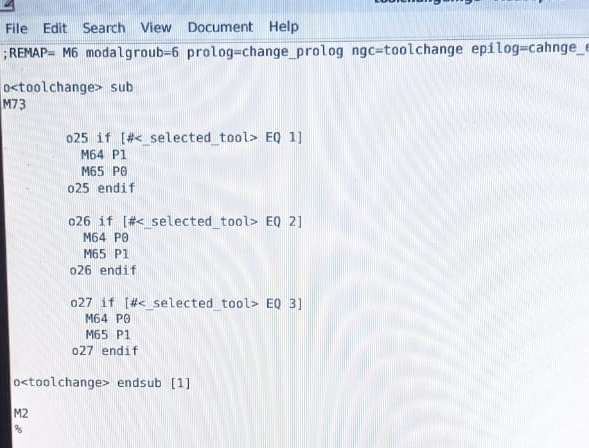

Hi,I have a router with 2 spindle, each spindle can be engaged to the machine by an air solenoid, I wire each solenoid to digital outputs P0, and P1, I tried to make a tool change file "toolchange.ngc" and I put it into the configuration folder...

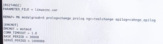

and I use the REMAP as follow in the ini file:

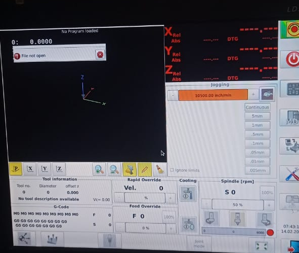

when I try to open LCNC it take a long time, and probet that file not open
how to fix this problem?
thanks

Replied by Aciera on topic REMAP M6 problem
I would suggest to open a terminal (Ctrl + Alt + t) and start linuxcnc from the comand line:
Choose your config and check the terminal output for errors.
linuxcncChoose your config and check the terminal output for errors.
