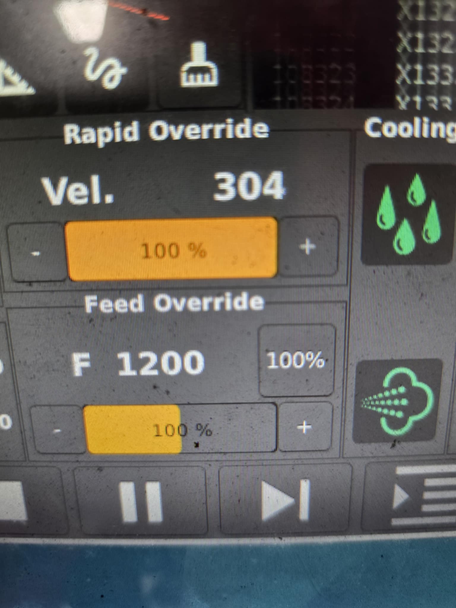

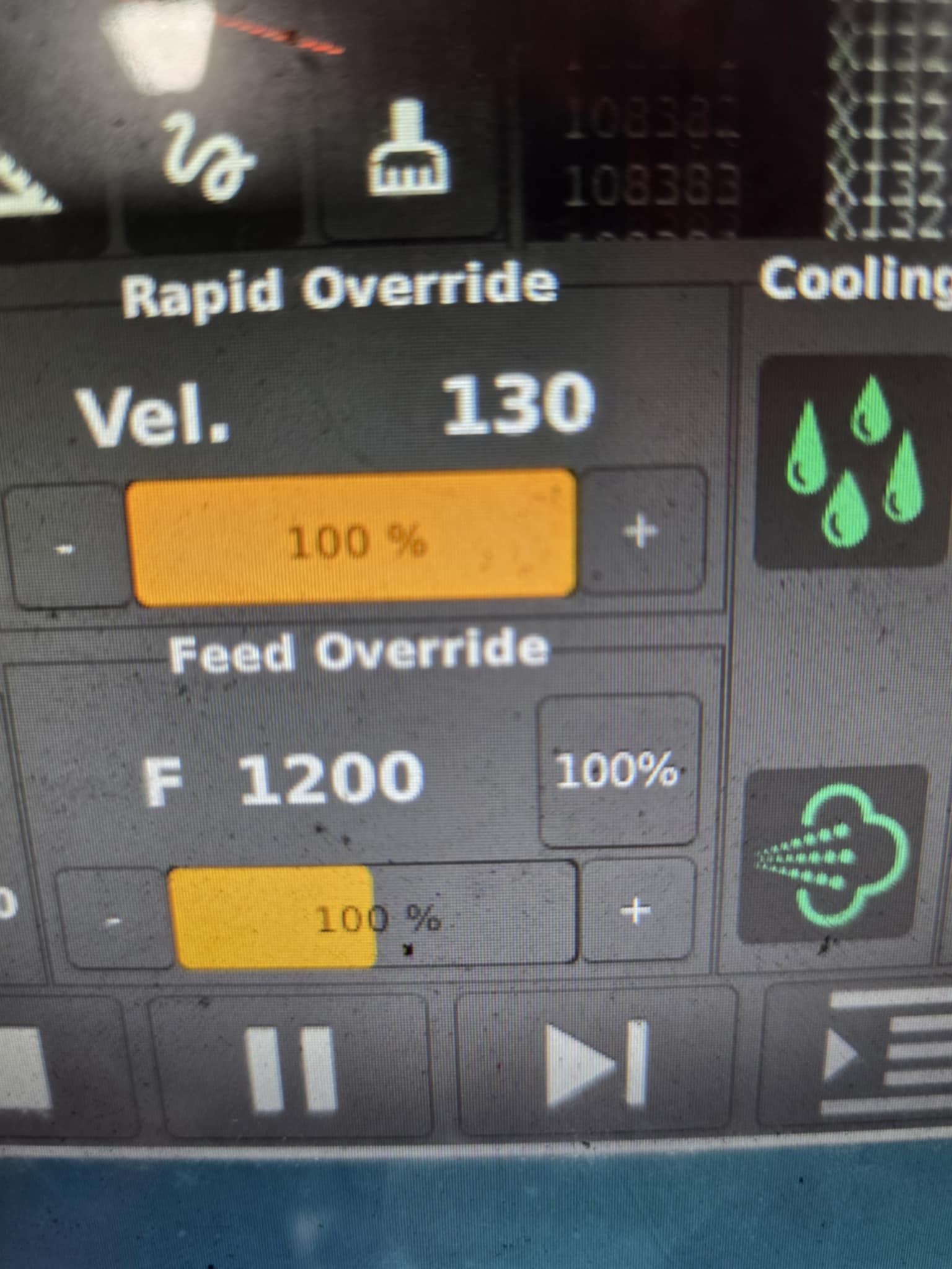

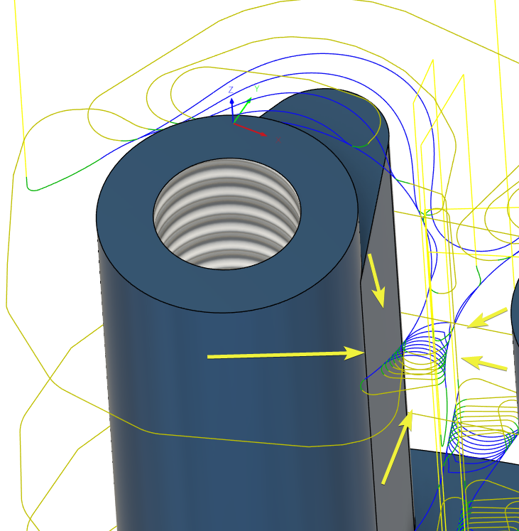

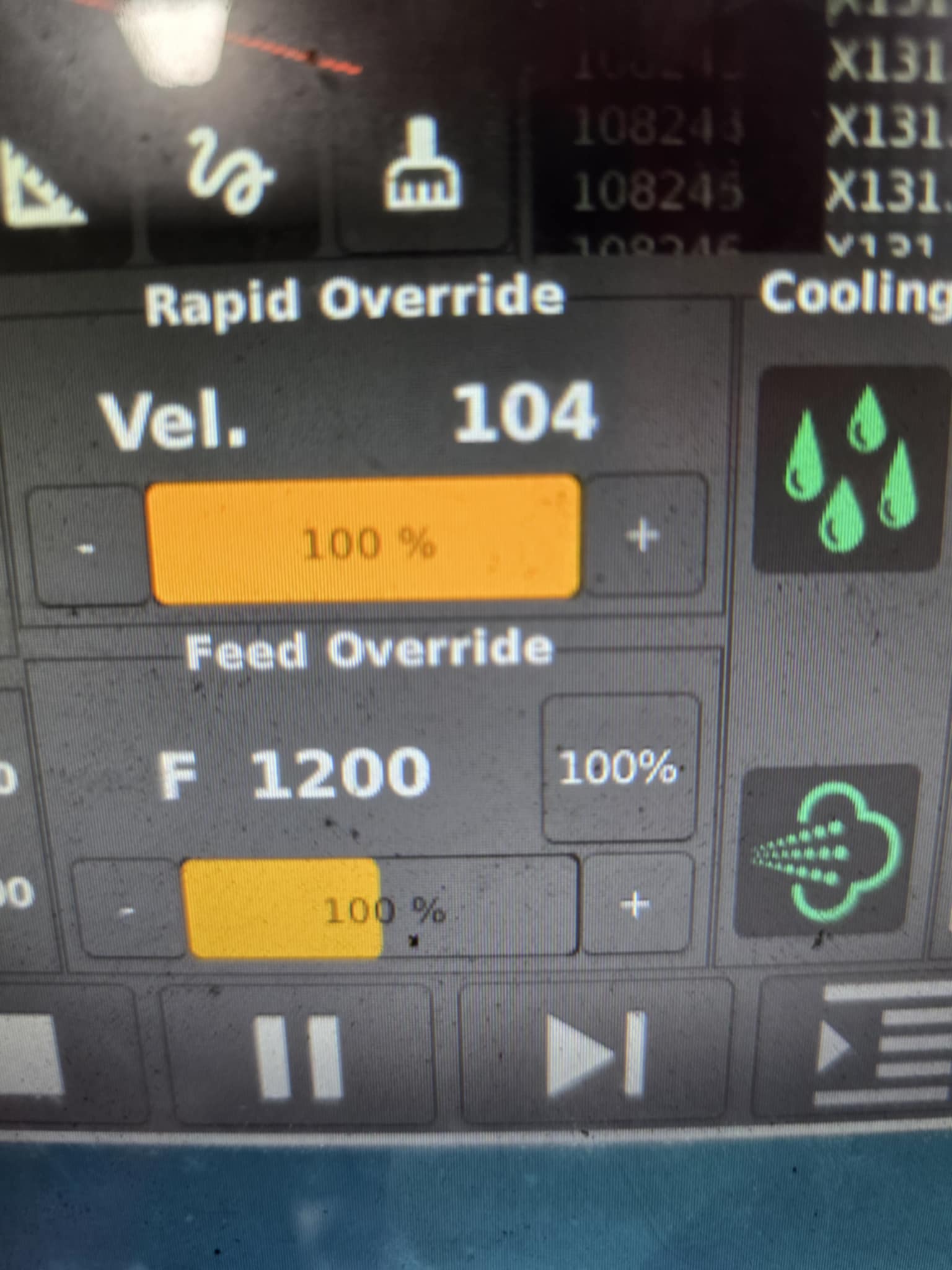

Hi
I use servo motor 750W and encoder from motor connect to 7i77 X and Y axis Feedback control
I use fusion360 for CAM and option G64 P0.002 Q0.002
when my cnc run process Adaptive clearing toolpath is curve or Arc I few cnc base little jerky and feed in Gcode(G1) is 1200 mm/mins but CNC just run 100-300 mm/mins
How to fix this problem ?
I don't know where setting wrong.
Thank you
Asis
Thank you
Asis

08 Dec 2024 17:34 #316261
by abdulasis12
Replied by abdulasis12 on topic Feedback control XY not full speed run G1 when curve or Arc
Hi, MR.ACIERA MR. TOMMY
Thank you for reply and sorry in weekend slow reply.
This below post file gcode problem.
example about in gcode file at N15 to N3900
**Also, what acceleration is set in the ini file?**
Tomorow at workshop I will check and told again.
Thank you
Asis,
Thank you
Asis,

09 Dec 2024 08:55 #316314
by abdulasis12
- Posts: 21959
