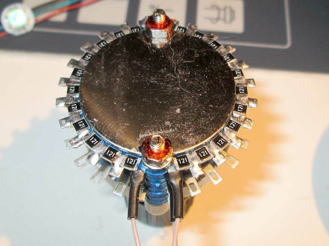

I just purchased
1N4148 diodes
0,1μF capacitors
, and
12-position switches
, to build some multiplexed rotary switches. I have no idea if this is going to work, but this is where I will start.
Unfortunately, the information needed to accomplish this is scattered all over the internet, with no solid how-to guide for LinuxCNC. If I am successful, and I have the patience, I may make such a thing when the time comes.
Once I have that part figured out, I will move on to rotary encoders for feed and speed overrides. And then after that, matrix keyboards. Hopefully the 7i73 has enough inputs for all of this, because I do not want any HMI inputs connected to the 7i96s board - only sensors.
I have also read about Arduinos being used for this kind of thing. I have an R4 Minima that is capable of emulating a keyboard through its type-c port, so I may use that for buttons. I don't know yet if that's a good idea or a bad idea.

Most things in LCNC are digital (on/off) inputs. Thats why we suggested you use a binary switch. Additionally, dealing with digital inputs with a MUX component uses less pins. eg MUX4 only needs 2 pins for 4 seperate states. Here is part of my build thread that deals with using binary switches and MUX4 for scale selection. The same process applies if using a MUX8 or larger

I just need to know how to build the switch, physically. Peter recommended the diodes I linked to, offline, and I got the capacitors for debounce. I had problems in EdingCNC with the selector switch not behaving, when I wired it to the UIO-10 with one input per position. I supposed debounce caps would probably help in the transition between positions.
I found your page earlier, but your photos aren't very clear and the thread is 76 pages long. Is there a page there that is especially relevant to my goal?

Here's a 4 --> 2 diode encoder with polarity adjusted
for 7I73 inputs that have built-in pullup resistors
(so read high if unconnected)
Note that mux_generic has built in debouncing so the capacitors should not
be needed if you use mux_generic to select jog increments etc.

if you can write a little bit in c - just make a one-liner custom component... something like
select THRESH values somewhere in between values you get in corresponding switch positions.
the resistor thing should work fine. i did that for 24-pos switch, though with stm32 adc (12bit?)..
pin in float vin;
pin out float factor;
function _;
if (vin < THRESH1) factor = 0.1;
else if (vin < THRESH10) factor = 1.0;
else if (vin < THRESH100) factor = 10.0;
else factor = 100.0;select THRESH values somewhere in between values you get in corresponding switch positions.
The following user(s) said Thank You: fully_defined

I guess the thing that confused me was what exactly it's doing; checking for continuity? Like, "okay, I see a path through bit 0 to ground, but not through bit 1, so I recognize switch position 1, and now I will do what I am assigned to do when I see that scenario." Right? That wasn't a mystery so much as just needing to visualize it. It didn't help that there are exactly zero photographs of such a thing labelled as such in the wild, at least that I could find.
Again, thanks for the print. It was genuinely helpful.
Now I've got to figure out if Mux8 is worth taking up 4 inputs, instead of doing the resistor thing, for the mode selector switch. I just did a Google search for "LinuxCNC mode selector switch," and the pickings are slim. Here is a Fanuc-style mode selector switch taken directly from the console of the Mitsubishi M64s control I used to run on a 3-axis mill:
Obviously I don't need DNC, but I want to be able to access the rest of these modes with a hardware switch. That's my goal.
Replied by fully_defined on topic Rotary Selector Switches & Resistors
This was helpful. I got the diodes and switches and took some pictures and built a little graphic:Here's a 4 --> 2 diode encoder with polarity adjusted
