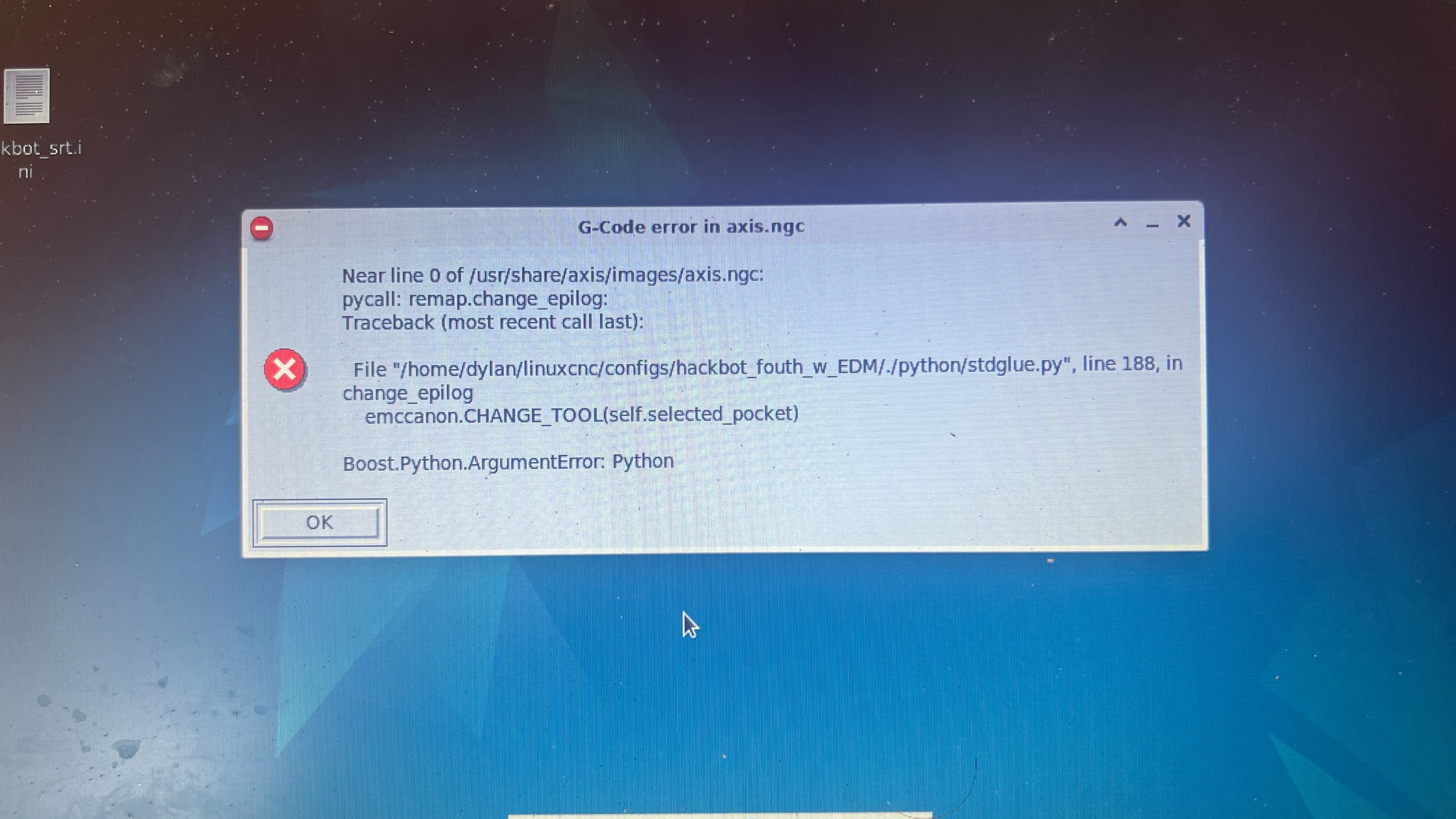

28 Dec 2024 14:41 #317567
by IronManDylan
Replied by IronManDylan on topic How do I Update to 2.10
Hi Aciera,
Yes, that was a pretty silly mistake I made. I figured that out and closed it. I didn't want to post again until I was really stuck. I was finally able to get 2.10 downloaded. It was a little painful and I fed a lot of data from the other forum post into chatGPT and we had to update a key and make a file. But it seems to be working.
It did give me an error when I opened the GUI, I think this is related to gcode image that it loads up during startup as that is now missing? I am able to open the GUI after exiting the warning though. Hopefully this warning does not cause issues.
For now I am going to call this a success unless someones has a concern about said error.
Thank you.
Best,
-Dylan
