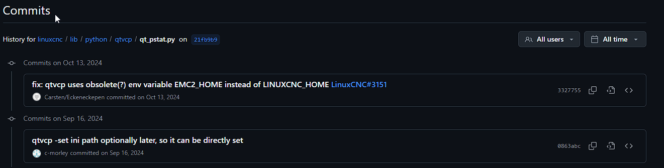

LINUXCNC_HOME is not set. I thought that I saw in the "linuxcnc" script where it was set upon execution when starting?
This may be why I had so many problems in the past. I prefer to run RIP but, I may have accidentally/inadvertently installed the uspace version
and perhaps not knowing the difference. I recently removed the uspace version however not totally sure that is what caused DESIGNER to
fail.
Additionally, what's a mystery to me is the use of paths in the INI file. Should be using FULL paths or ABSOLUTE paths or other?.......

09 Jan 2025 00:27 #318508
Replied by cmorley on topic QTDesigner PATH issue
That is the problem. I now notice my designer works because I too have an installed version of linuxcnc. I'll fix this soon.

09 Jan 2025 01:47 #318513
I pushed a fix.
It was cause by RIP and Installed versions looking for a different environmental variable for the same info (LINUXCNC_HOME and EMC2_HOME)
This should fix the errors you see.
The following user(s) said Thank You: tommylight, gardenweazel

09 Jan 2025 11:23 #318557
by gardenweazel
Replied by gardenweazel on topic QTDesigner PATH issue
Thanks Chris! Designer now detects the linuxcnc plugins!
