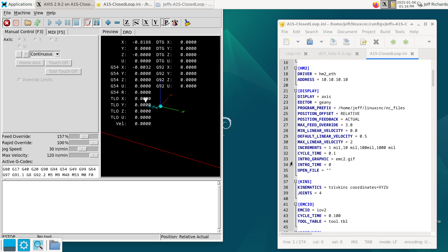

Whenever I start Axis, I see a bunch of G-Codes, just below where is shows Active G-Codes.
Where are these defined (I'm guessing in a file somewhere?), and can I change them?
Google search led to OPEN_FILE in .ini file however as shown below just closed quotes there so looks like no file specified.
I'm a little confused.

You can add to the ini file to change the startup nc codes.
linuxcnc.org/docs/stable/html/config/ini...sub:ini:sec:rs274ngc
The default codes for each modal group is programmed into LinuxCNC.
JT
JT
