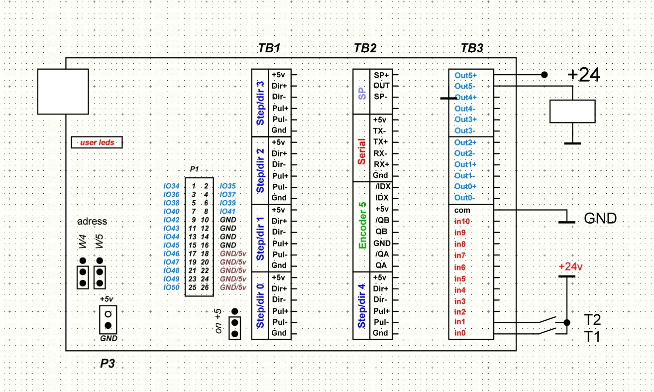

- Yaroslav
- Posts: 22
14 Jan 2025 02:51 #318922
by Yaroslav
Replied by Yaroslav on topic M6 Remap Lathe (Remap T & ignore M6)
I created two configurations for 7i96s. One on the carousel component, the other on the ladder. The ladder works fine with Remap T and Ignore m6, just like when changing tools manually. When working with the carousel component, Remap T throws an error "M6: no tool prepared". Remap M6 = Ignore M6 - does not work at all, since Remap M6 is already used. In the configuration, these functions are disabled in the ini file.

I've been trying to explain this for sometime, what would really really help, is if you shared your configuration, wiring diagrams and setup files. I really can't help you unless you post these things up. No one here can help you without seeing all of those things.
- Yaroslav
- Posts: 22
21 Jan 2025 02:21 #319515
by Yaroslav
I have placed a simplified version of the configuration on the example of one of the most common 7i96s boards, as well as a diagram. They work just like the more complex options.
