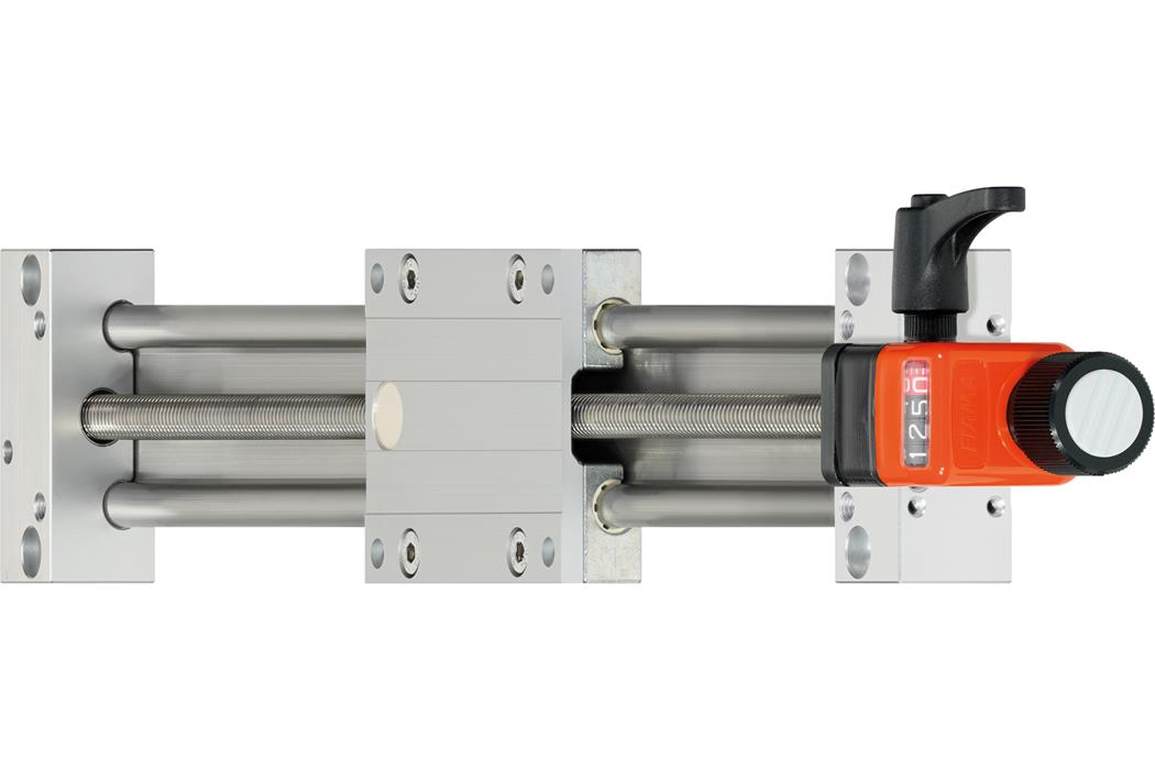

I'm facing an issue with my Z-axis linear guide, and I could use some advice.The axis is mounted upright, and I’ve noticed significant vibrations. At higher speeds (10,000 mm/min), the vibrations are less pronounced, but at lower speeds (3,000 mm/min), they are much more noticeable. Interestingly, the issue becomes more severe when the block on the linear guide moves farther away from its mechanical fixing point.I’ve already tried changing the motor stepping settings, but it hasn’t resolved the problem.If anyone has experienced a similar issue or has suggestions for troubleshooting, I’d greatly appreciate your input.Thank you in advance!
Ini for reference.

What is the actuator - do you have a picture? If it's only doing it in one direction there may be an issue with the actuator or related mechanicals.

The one attached is similar.

Perhaps I'm still misunderstanding, but the actuator you showed looks like it has a leadscrew with a pitch more like 5mm, not 50mm.
Just to make sure we're talking about the same thing, 'pitch' to me means the spacing between the screw threads. 50mm is an abnormally steep pitch unless it's a multi-start screw.
In other words, does the carriage really move 50mm for a single turn of the screw?

The attached image is not the exact one but it is looks the same but pitch is 50mm.

3000 mm/min with 50mm pitch = 60 rpm
10000 mm/min with 50mm pitch = 200 rpm
You need to add some gearing or change your lead screw pitch so you move the resonance RPM zone out of the operating range.
Replied by rodw on topic Help Needed: Z-Axis Linear Guide Vibrations at Specific Speeds
I think stepper resonance is confirmed.The attached image is not the exact one but it is looks the same but pitch is 50mm.

I'll second rod's conclusion. At that RPM steppers can vibrate like mad.
Change the screw pitch and you'll get the rpm out of the vibration range, as well as gaining some resolution and thrust.
