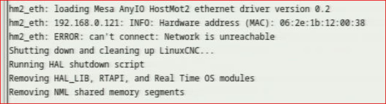

12 Jan 2025 12:33 - 12 Jan 2025 13:08 #318810
by nicton
Replied by nicton on topic How do I configure the connection of two mesa 7i92 via ethernet?
The boards have different ip addresses, on a separate switch without wi-fi and without internet. There are only three elements in the network: the host and two boards, all have different static ip addresses. I noticed that the LAN is completely blocked when linux cnc is running with one board, even ping does not work.
An error occurs on this line from hal:
loadrt hm2_eth board_ip="192.168.0.121, 192.168.0.122" config="num_encoders=6 num_pwmgens=1 num_stepgens=5, num_encoders=2 num_pwmgens=2 num_stepgens=10 sserial_port_0=0xxxxxxx"
From log:
hm2_eth: 192.168.0.121: INFO: Hardware address (MAC): 06:2e:1b:12:00:38
hm2_eth: ERROR: can't connect: Network is unreachable
The first board connects, the network is blocked, and the second board cannot connect.
From log:

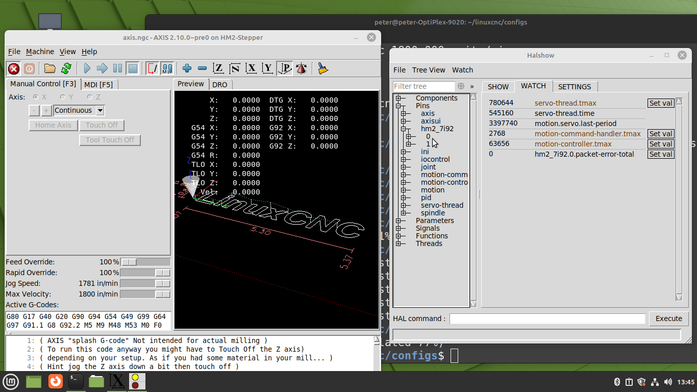

15 Jan 2025 10:02 - 15 Jan 2025 18:22 #319034
Replied by PCW on topic How do I configure the connection of two mesa 7i92 via ethernet?
That's odd, I have run up to 4 hm2 cards from one switch
I will try and duplicate this.
I cannot duplicate this error, here's a screenshot of LinuxCNC running with two 7I92T's,
one at 10.10.10.10 and the other at 10.10.10.11, both running from a single Ethernet
port going to a switch:
and here are the hal and ini files for the test setup:
