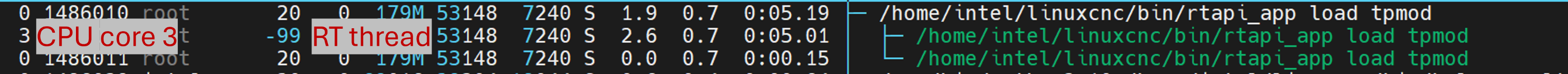

Hi, I am new to LinuxCNC and have some questions about how LinuxCNC find the RT CPU (isolate CPU core) on PREEMPT_RT.
It seems the find_rt_cpu_number() function in uspace_rtapi_app.cc either choose the environment variable RTAPI_CPU_NUMBER (which is NULL if not set manually) or choose the last CPU core regardless of whether there is an isolated core.
e.g. The isolate core on my Preempt_RT is core 1, but find_rt_cpu_number() returns 3 and the RT thread is running on core3 in the attached images.
My test version is LINUXCNC - 2.10.0~pre0. Thx for your time :-D

This isn't an answer to your question, but it looks like you can override it with an environment variable:
github.com/LinuxCNC/linuxcnc/blob/master...ce_rtapi_app.cc#L984
It might be interesting in your case to do that and see if latency improves.
Are you using Linux and not BSD or similar? (I see a comment about it only working with Linux in one of the commits.
Otherwise, looking at the code, I have no idea how it works, it looks very odd.

At line 996.call to retrieve the number of available CPUs
at line 1006. It runs over the cpu list.
then it sets the priority 0-100% for each used cpu.
sysconf(_SC_NPROCESSORS_ONLN)at line 1006. It runs over the cpu list.
