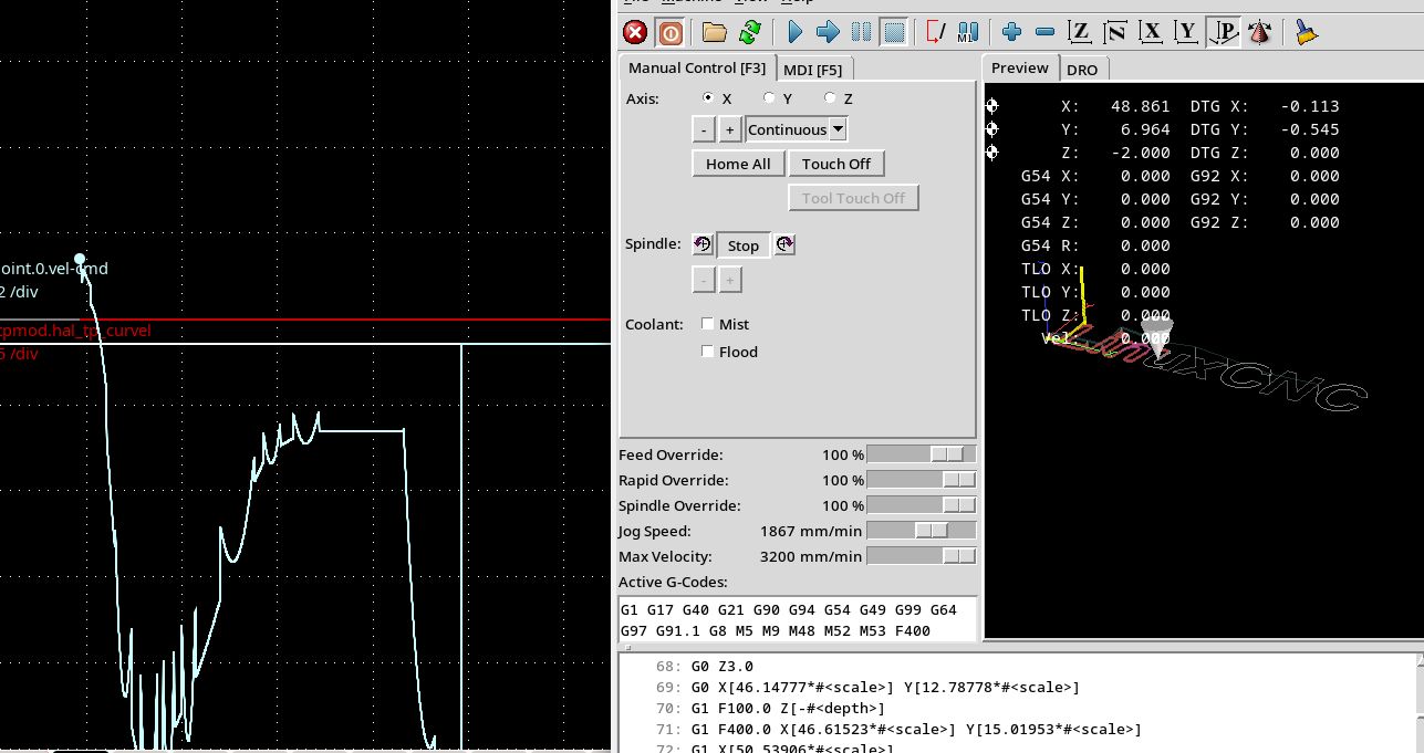

Get same results when calculating vel for joint.0 inside the planner. Havent figured it out yet. I thought maybe split cycle. But have to dive deeper into it. Will do a motion test tomorrow.

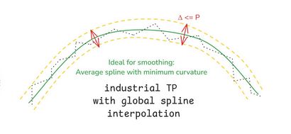

In this example no scurve is active. The traject position is incremented 0.01mm each cycle.
The spikes are caused by bspline interpolation.
Even when the bspline has a high resolution like 1000 points. It wont change.
So maybe change it to a linestrip. and then interpolate the linestrip. See what happens.
The following user(s) said Thank You: Darium, Beef
- Grotius
- Posts: 2419
- Thank you received: 2349
24 Jan 2025 16:24 #319766
by Grotius
Replied by Grotius on topic scurve trajectory planner
The spikes are solved. Problem was found. Not havely tested, just one video.
1. Using a linestrip derived from a bspline seems to work ok.
2. Slightly changed the scurve algo.
Code is updated.
Code is updated.

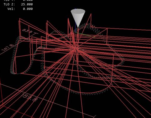

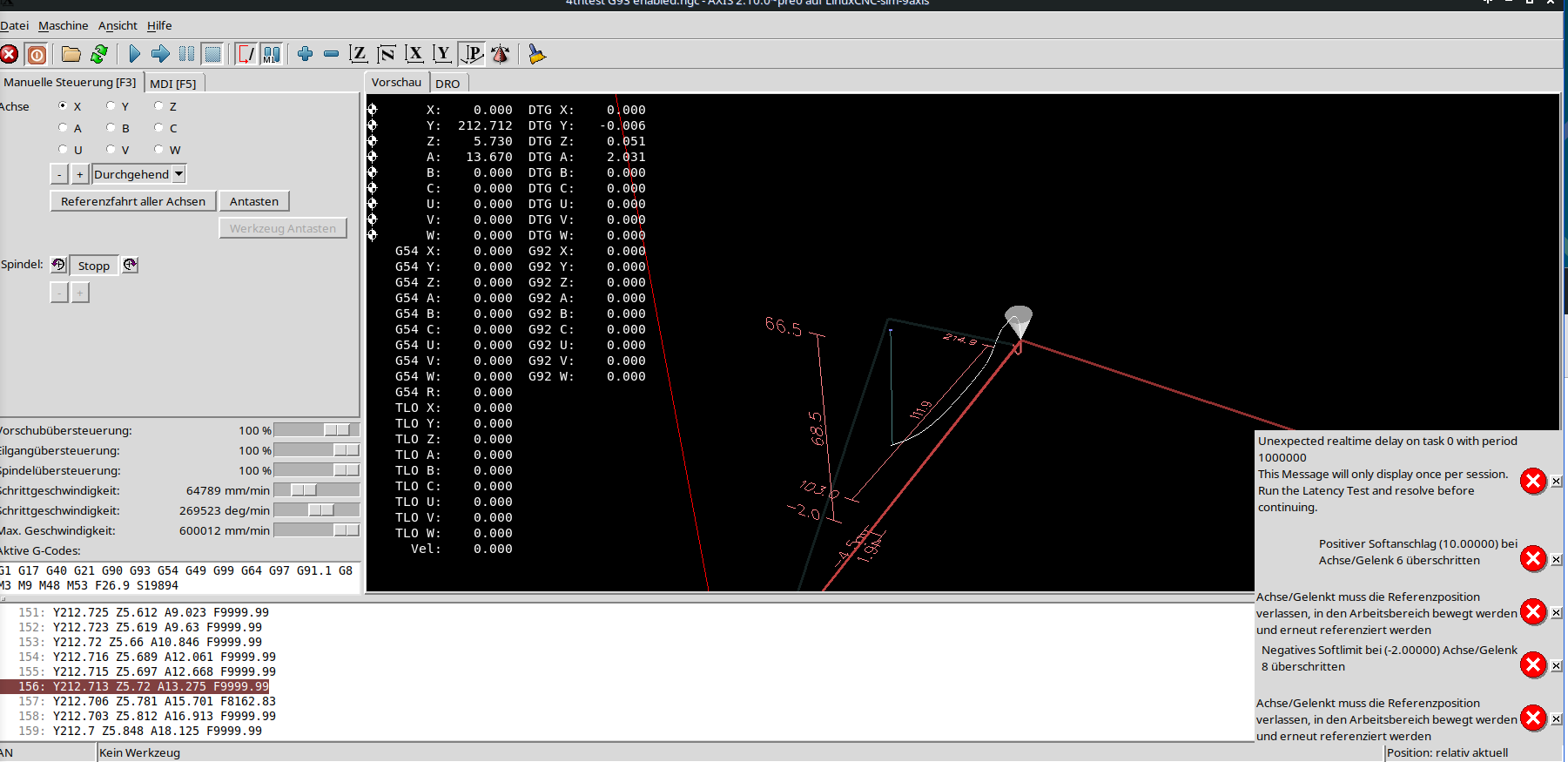

Hi Grotius. I can also provide a non functional code. Works as it should with the standard tp with 2.9.3.
With scurve tp it jumps all over the place. 9axis sim machine or a self configured machine is no difference. Also your given 3axis mm machine with a added 4 axis is the same.

@Julian,
Thanks for the interesting file.
The first problem is solved :
1. Buffer overflow.
-> cause : tcqFull() function was not used.
-> solution : tcqFull() function now uses a max buffer size to prevent buffer overflow. Default = 1000.
The second problem is not solved today:
2. It run's up to ca 1000 lines. Then it hang's.
-> cause : tiny segment length's : 0.007mm.
-> solution : review, recode the abc, uvw part of the planner step by step.
1. Buffer overflow.
