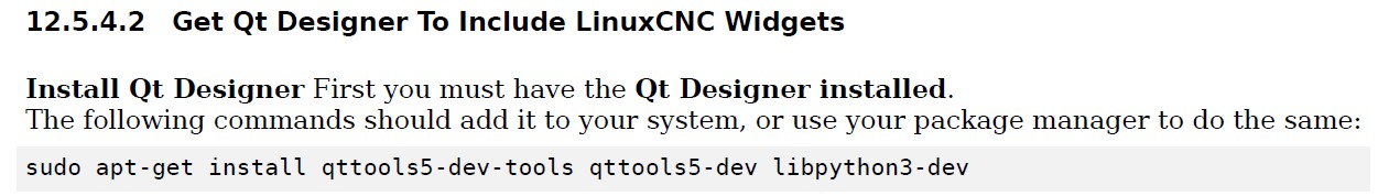

Problems to install QT Designer - Linuxcnc 2.9 was created by cncforfun

I installed via USB:
www.linuxcnc.org/iso/linuxcnc_2.9.3-amd64.hybrid.iso
linux distribution Debian 12
Following errors:
qttools5-dev-tools not available
qttools5-dev can`t be found
libpython3-dev can`t be found
Following errors:

I found an issue in my file source.list. This is now correct.
Installed QT Designer with success.
2 issues I have to fix due to:
How can I add a symbolic link and create the plugins/python folder in detail, so that qt designer can find qtvcp_plugin.py?
Tried to create python folder with command mkdir, but it isn`t possible in folder /designer to get:
’/usr/lib/x86_64-linux-gnu/qt5/plugins/designer/python’

Fixed with thread:
