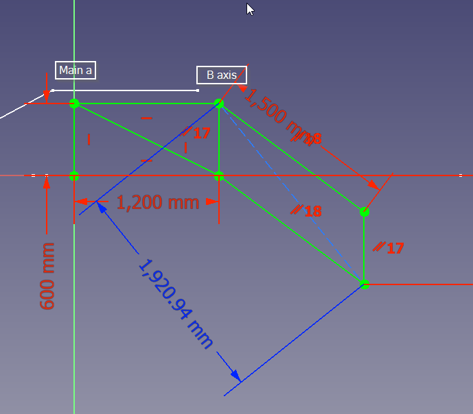

Hello. Could some-one point me how to implent non-standart kinematic for robots ?
As in photo below - scara with one arma at 1200 length and other with 1500, but able to swing up and down for some z movement ?
And yes - due to z movement of outer arm, project length is chaniged and needs to be recalculated for each z position. I did all math side for both forward and inverse kinematics.
[attachment=67048]2025-01-1918_53_54-_scara-FreeCAD1.0.0.png[/attachment]

And Z axis should be controlled by some rope wire tensioning paralelogram part.

19 Jan 2025 12:11 - 19 Jan 2025 12:14 #319391 by tommylight
Replied by tommylight on topic Custom scara kinematic.
The attachment is inside the code section, hence it does not show.
Here is the image from the above post, just in case.
