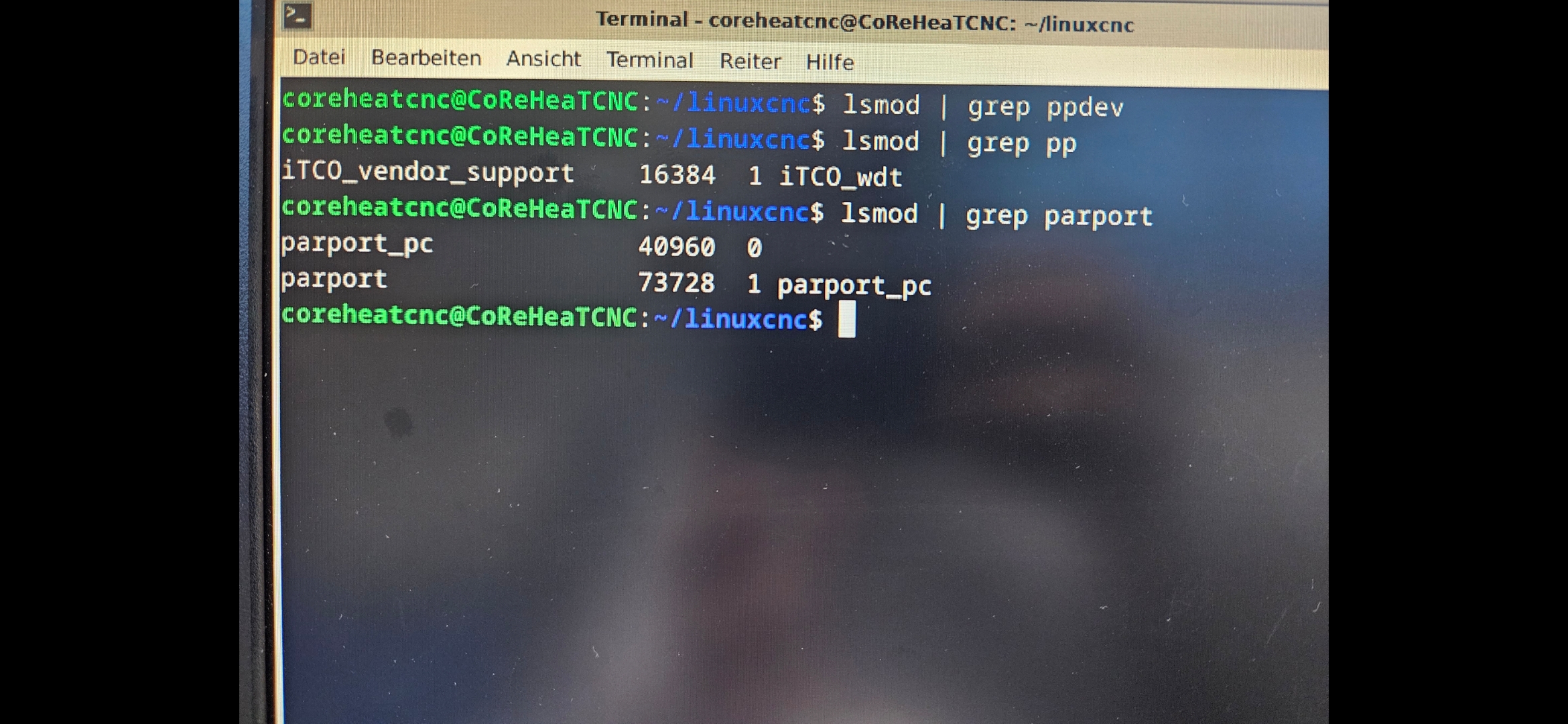

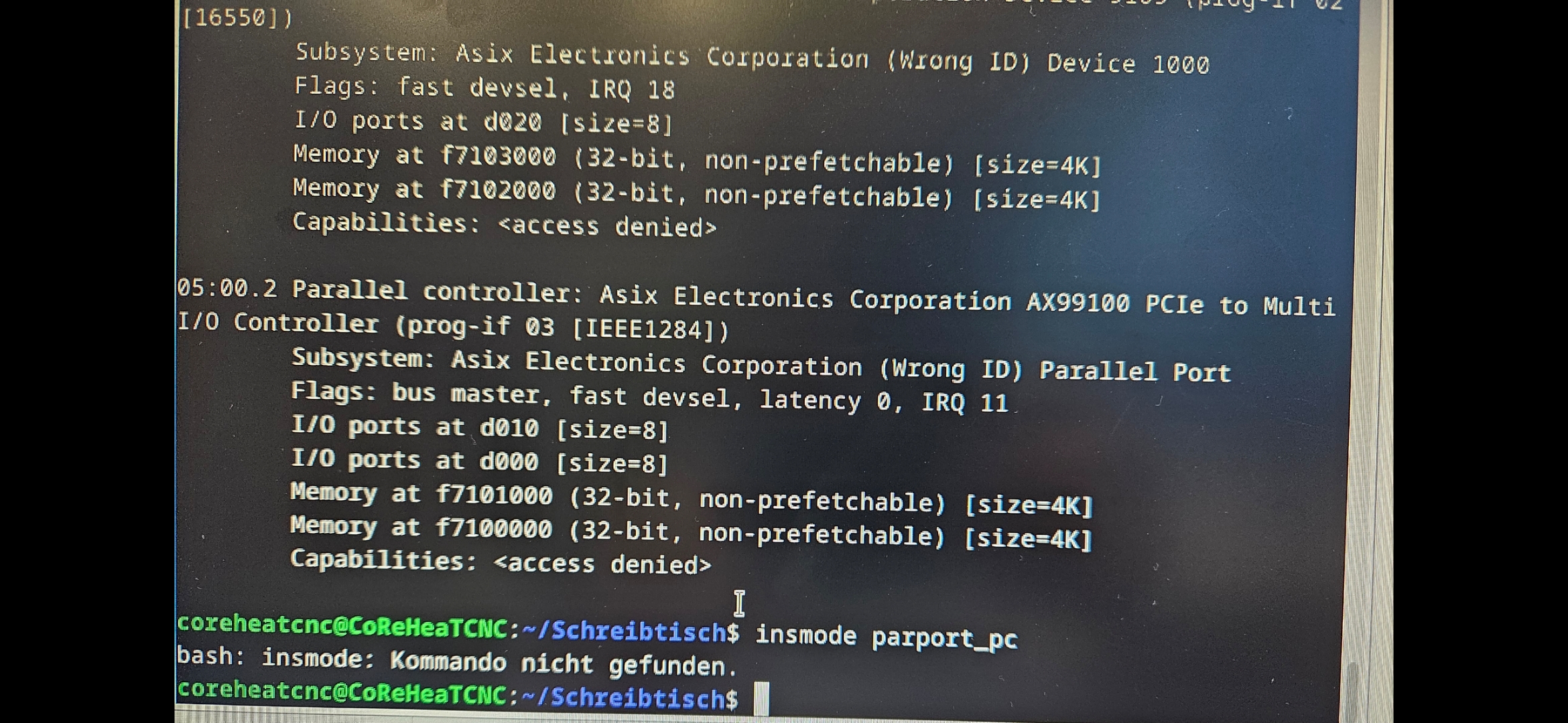

30 Jan 2025 08:05 - 30 Jan 2025 08:06 #320147
by sk_linuxcnc
Replied by sk_linuxcnc on topic how to run PCIe Parallel Port in mode x with 9 inputs?
Last edit: 30 Jan 2025 08:06 by sk_linuxcnc.
