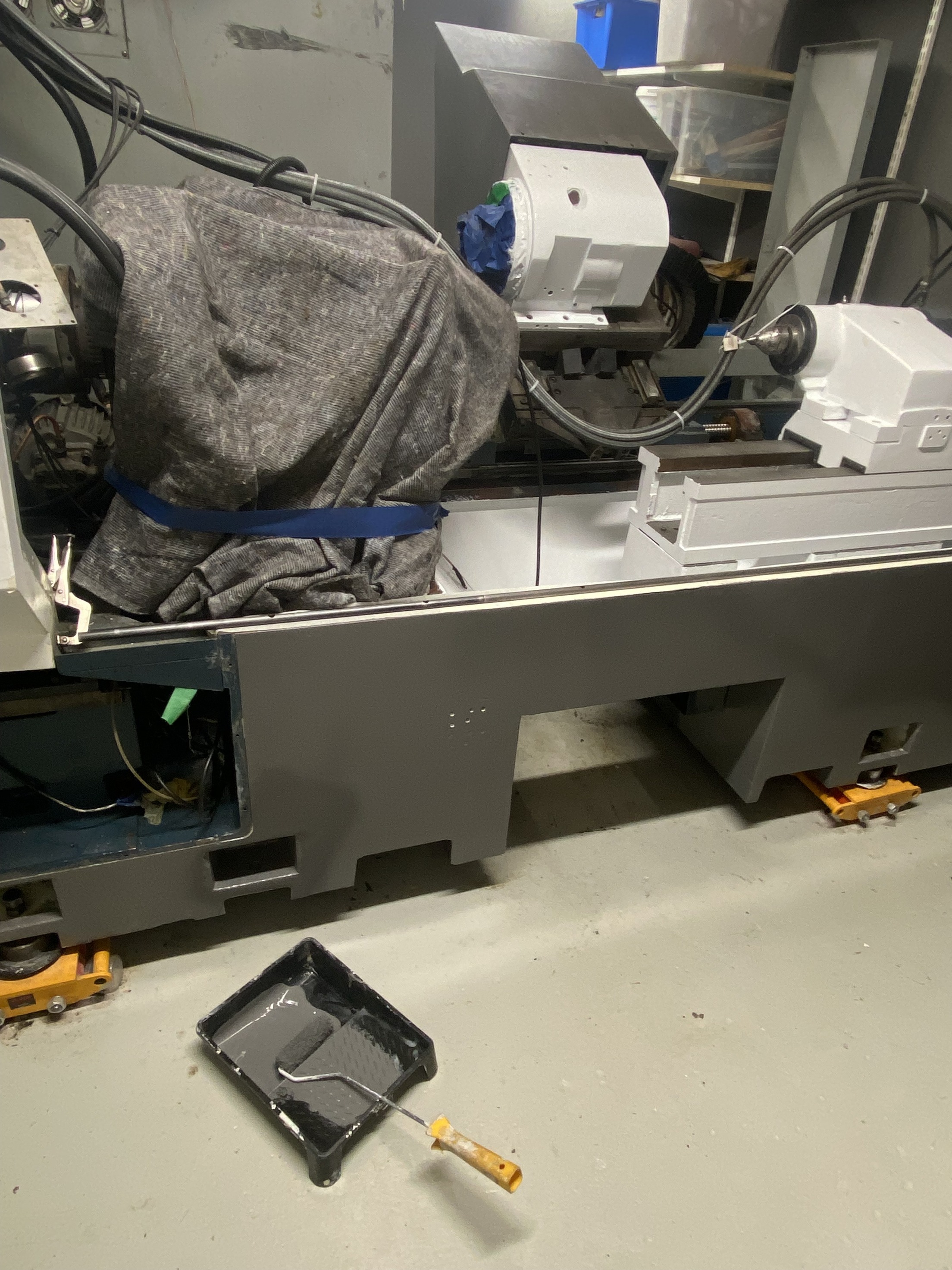

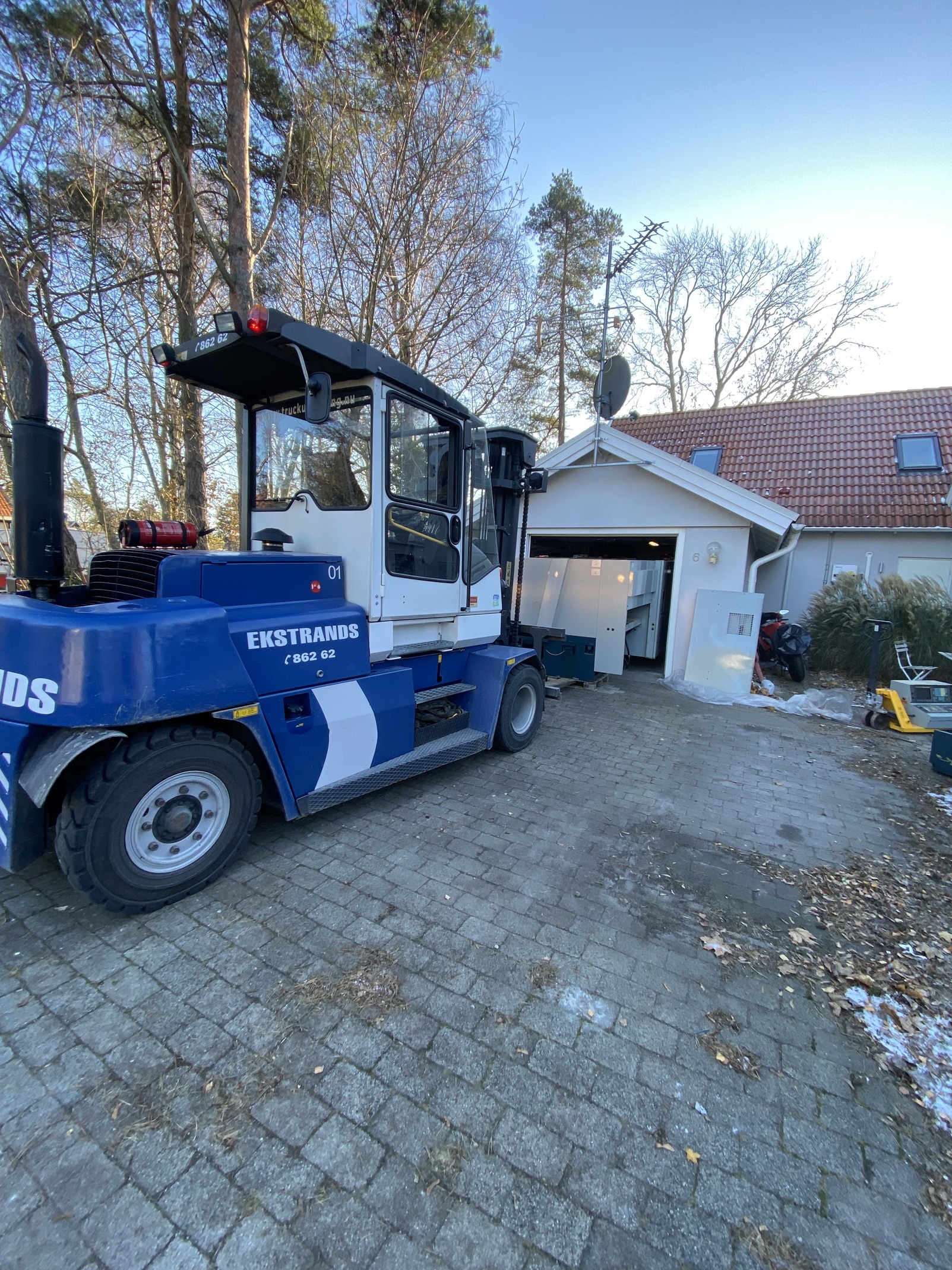

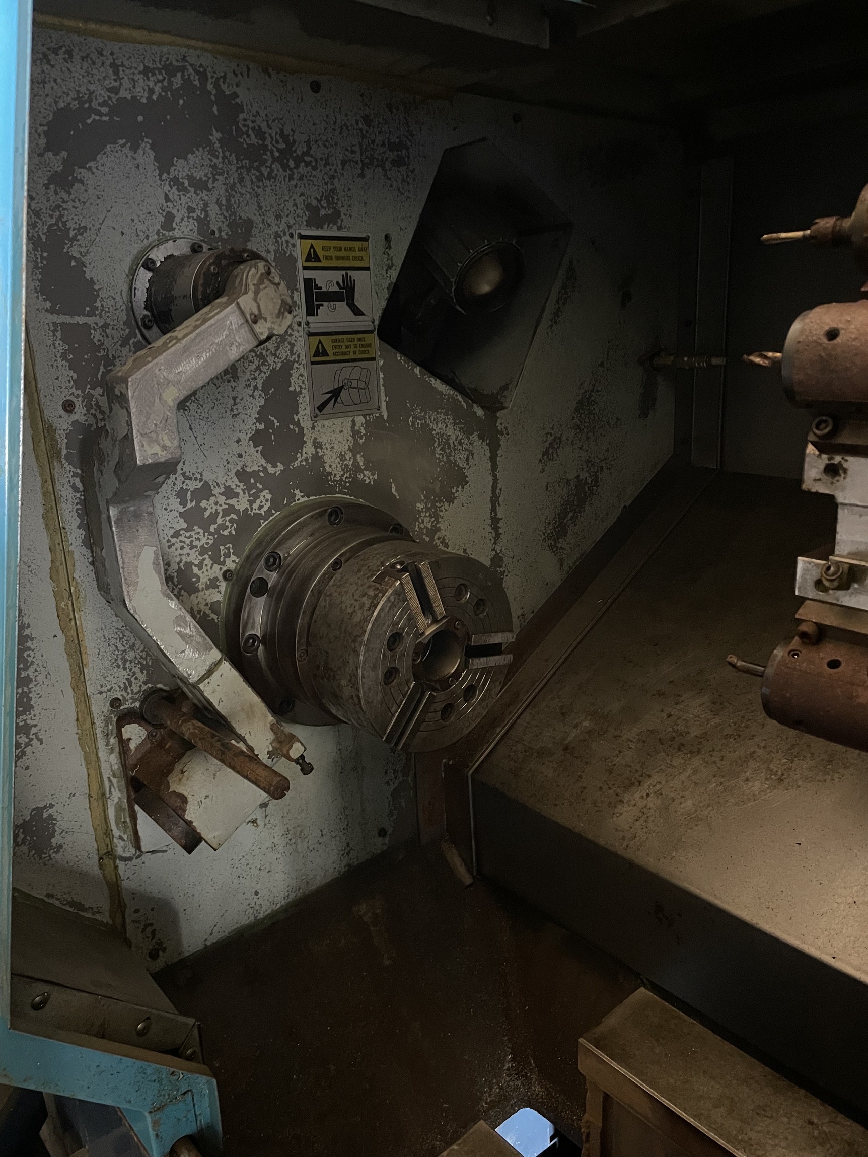

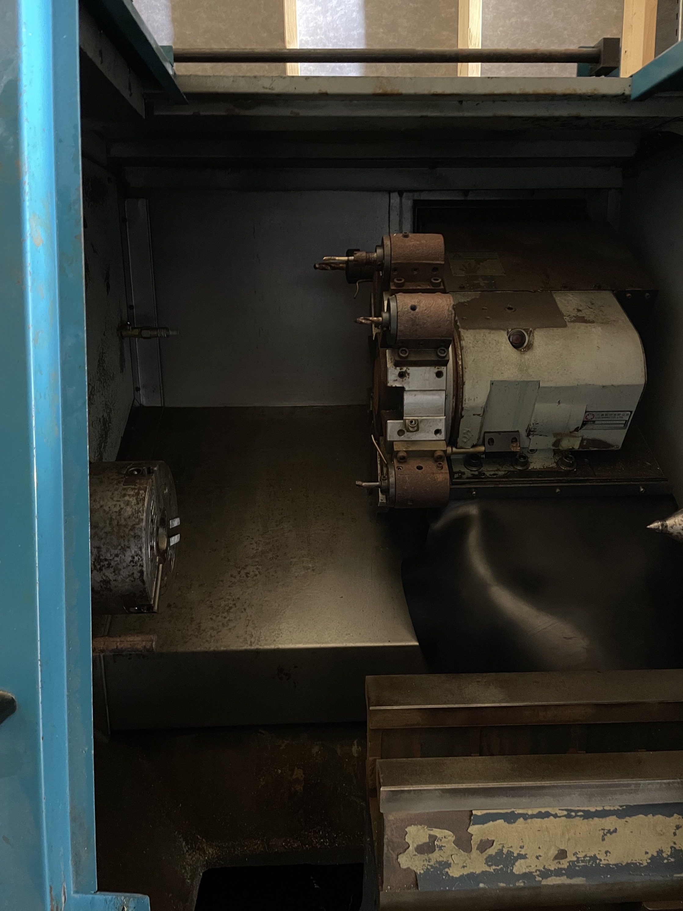

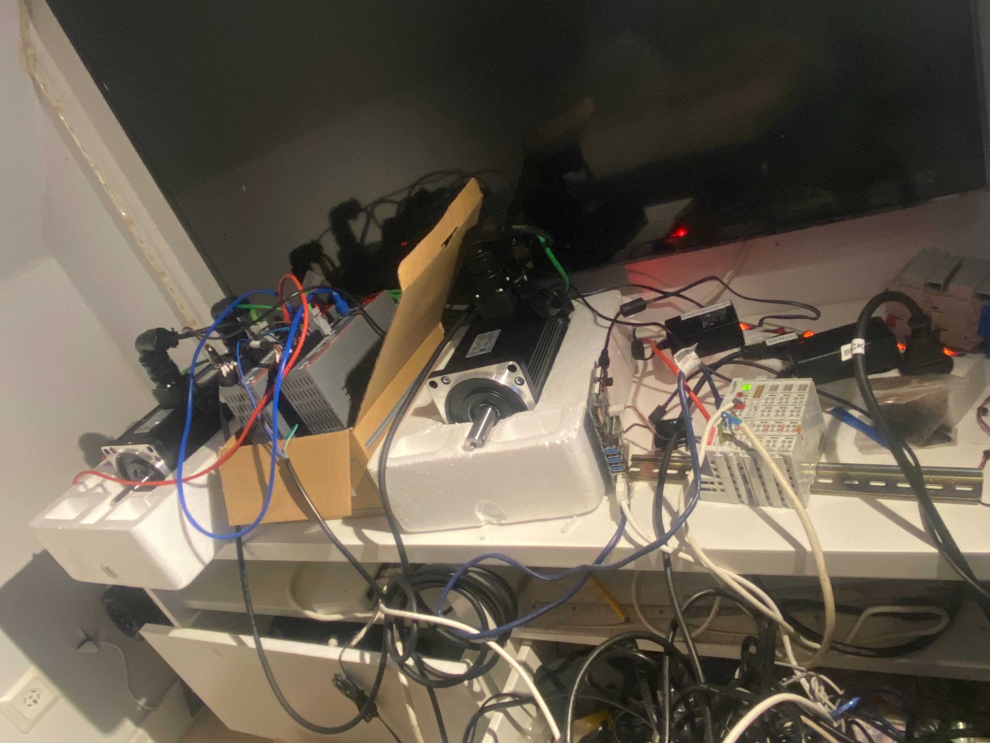

Hello i have a Feeler Ftc-280 which im currently retrofitting from its fanuc OT controller to a ethercat system. Some specifications so you know what im working with: 11kw fanuc main spindle (i will run it on a regular vfd with modbus ), 1.2kw x axis servo, 1.8kw z axis servo, 2.2kw hydraulic pump (for driving the turret, tailstock, probe arm, parts catcher and chuck). It´s a quite rigid machine weighing 5 tons with some 50mm thk ballscrews. I have purschased most electronis and have gotten the lichuan servo motors and beckhoff devices up and running. I already bought a raspberry pi so i will not be able use probe basic. Is there another nice gui for lathes?

After a couple of hours fiddiling with my vfd to get it working using modbus my pi4 died on me... not really sure what happened it just suddenly went black so i purschased a mini pc witth a celeron j4125 with dual ethernet ports.
