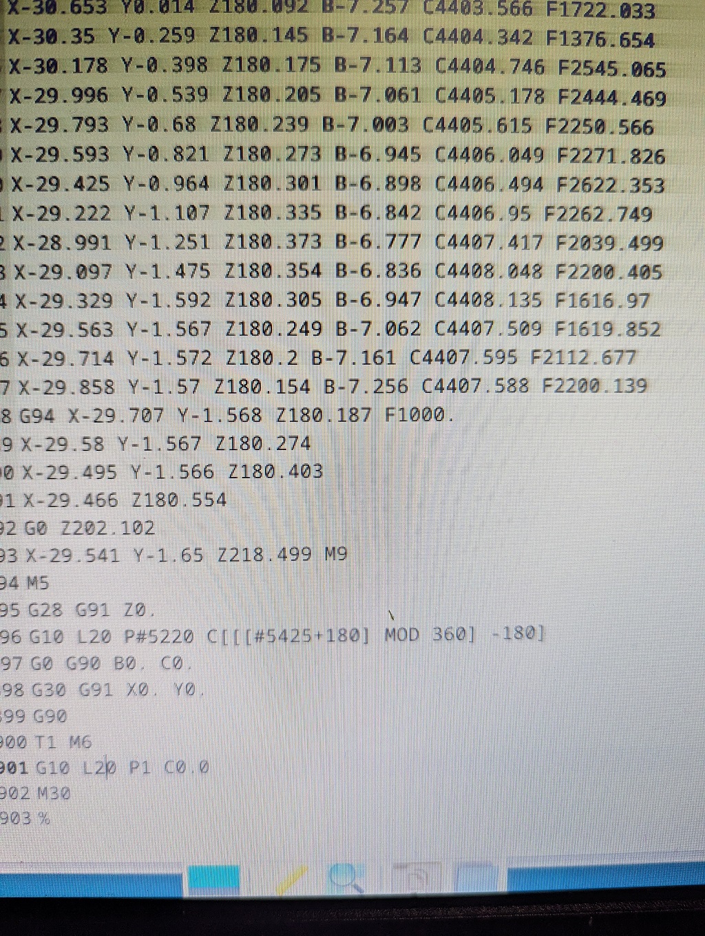

when i am running a job and it incolves some 5 axis moves so C axis becomes quote a large count. as there is no unwind code i do a quick G10 L2 calc and run the next part
after running 5/6 parts i get a following error on C axis every time, if i rehome the joint (c axis) and G10 L20 to zero the joint error problems go awayi and i can carry on running parts untill the next 4/5 are done same joint error right at the same program point each time
ia this todo with some max count being reached?

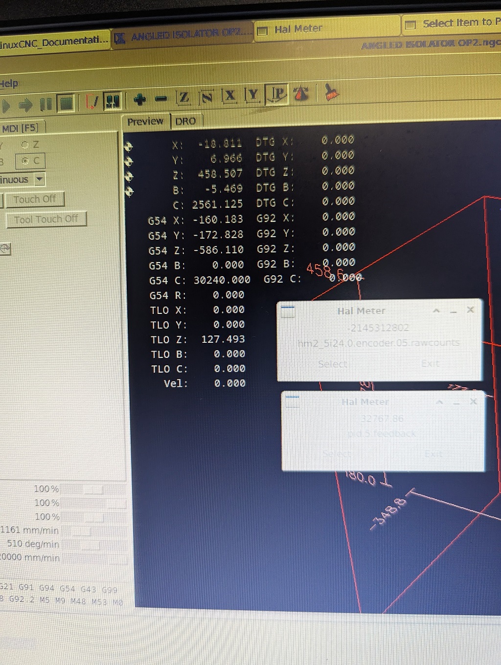

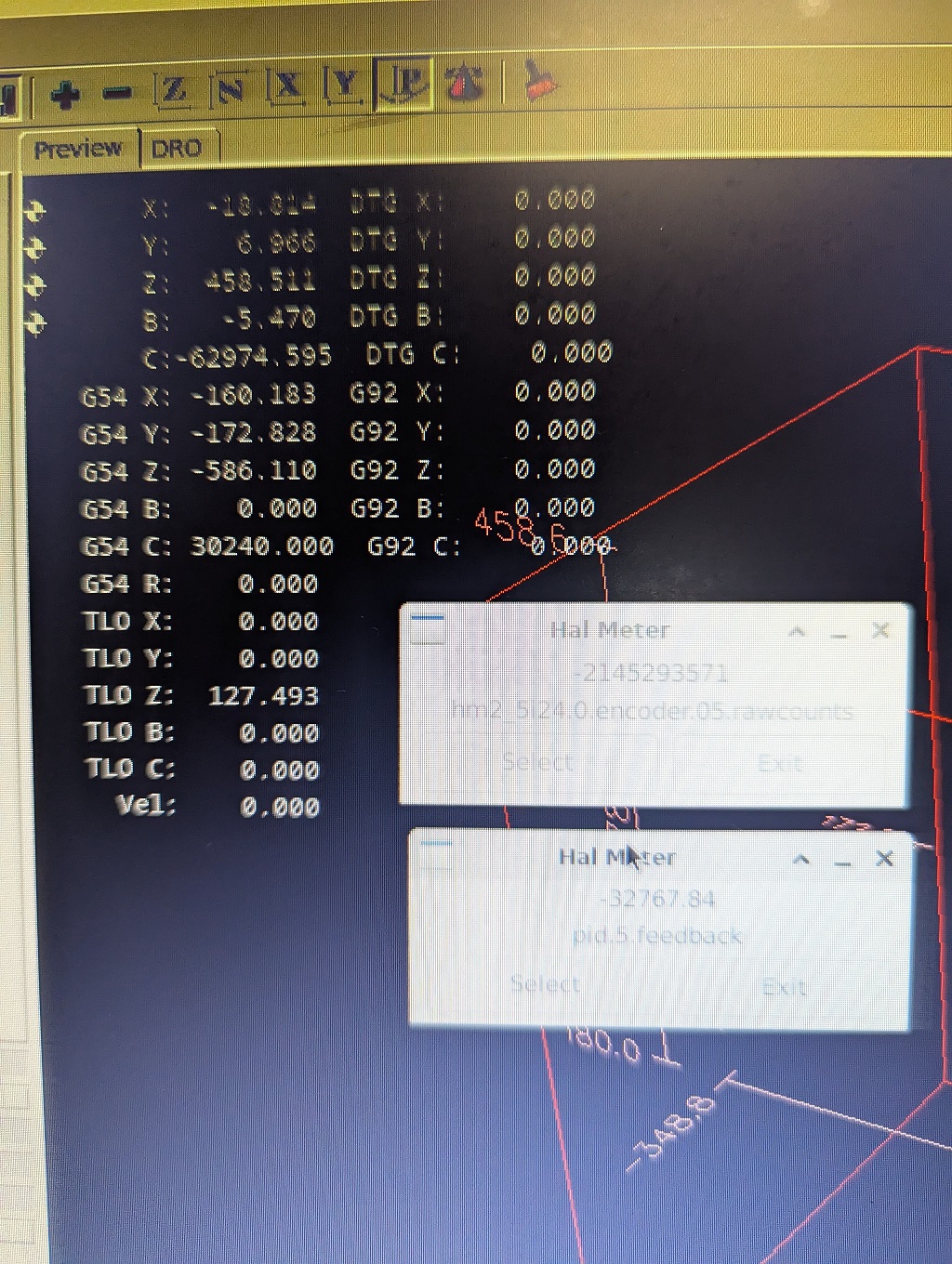

what i have noticed is the raw count pin is counting right but the PID feedback is going from a - number jumping to a + number giving the joint error trigger,
-32767.84 to +32767.86

If you end up doing ~91 full turns (@65536 counts per degree and 360 degrees per turn)
the 32 bit signed position number used in intermediate encoder calculations will wrap, I suspect
this may be whats happening. Are 91 turns possible?

91 turns is possible very much so ,
this is just a simple small part so a complex job would very much be way over that turn number.
wrapping sounds right as number does a odd sign change in the feedback counts
