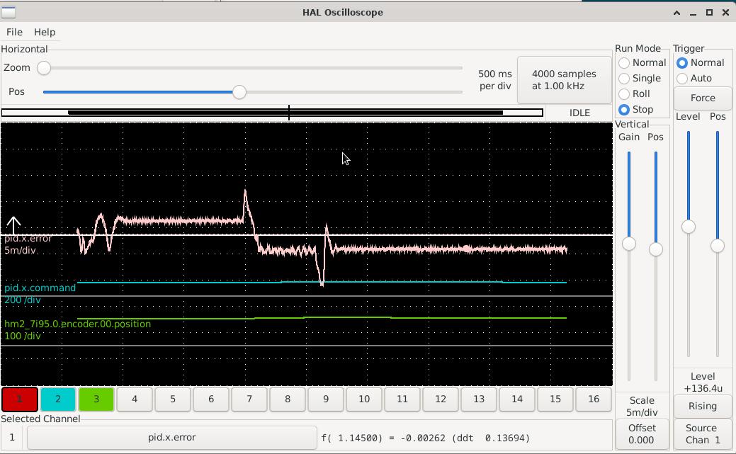

I'm trying to reach 10000mm/min max velocity on three axis, but lowering STEPLEN and STEPSAPECE below 1000 nanoseconds, following error shows up immediately.
Based on driver specs Maximum frequency of input is 1MHZ (Differential motion).
I believe mesa 7i95T isn't limiting factor here!?
My current values:
DIRSETUP = 200
DIRHOLD = 200
STEPLEN = 1000
STEPSPACE = 1000
SCALE = 2000
My current values:
DIRSETUP = 200
DIRHOLD = 200
STEPLEN = 1000
STEPSPACE = 1000
SCALE = 2000

- Posts: 18122
- Thank you received: 5337
16 Mar 2025 09:34 #324054
Replied by PCW on topic STEPLEN STEPSPACE time for Bergerda AC servo driver
You may have to increase the following error limits a bit and plot the
commanded and feedback positions and joint following error with halscope
to determine why you are getting a following error:
Possibilities:
Drive does not work with shorter step signals
Encoder feedback does not work at higher speeds
Instability/tuning issues
Possibilities:

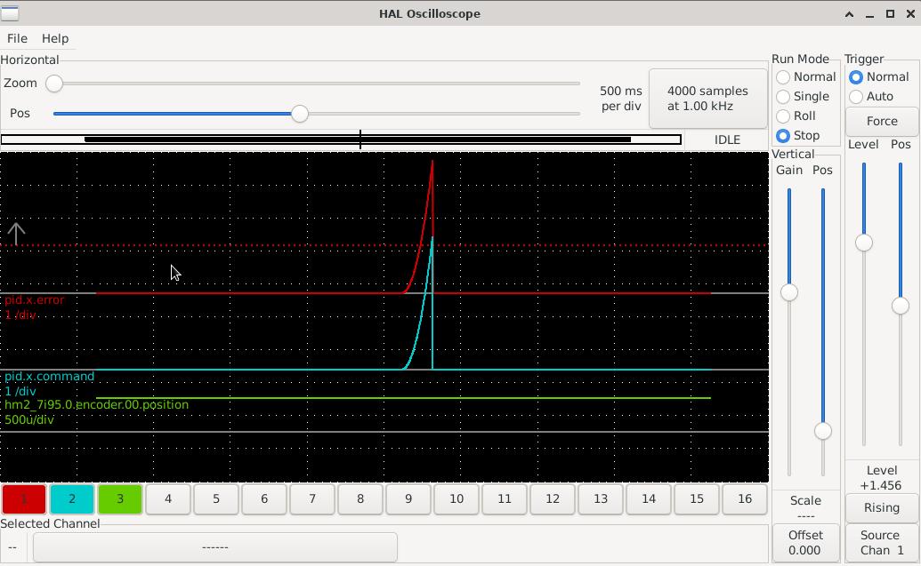

- Posts: 18122
16 Mar 2025 13:16 #324065
Looks like the drive is not responding to shorter step pulses (no motion at all)
Is is possible there is a digital filter in the drive so it rejects shorter than 1000 ns step pulses?

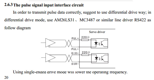

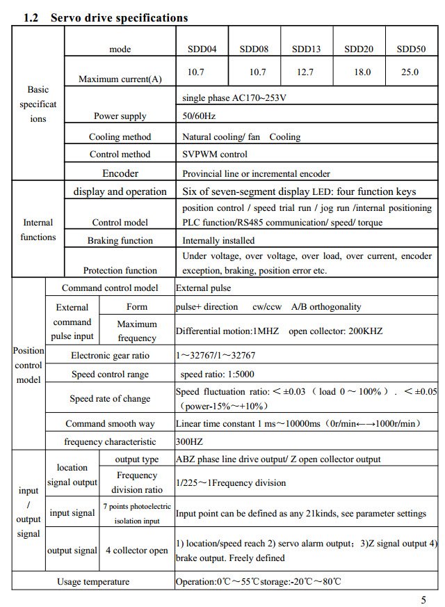

16 Mar 2025 16:28 - 16 Mar 2025 16:29 #324071
by tommy
Replied by tommy on topic STEPLEN STEPSPACE time for Bergerda AC servo driver
Driver manual can be downloaded here: en.bergerda.com/download/31.html
I checked, there is parameter P82 - Input pulse filter frequency, which default value by manual is 800, but need to check tomorrow what number is actually set!

17 Mar 2025 11:20 #324125
by tommy
Parameter 82 did the trick! It was set to 600 by default, now I set it to 1000, and works perfectly up to 170mm/s velocity.
