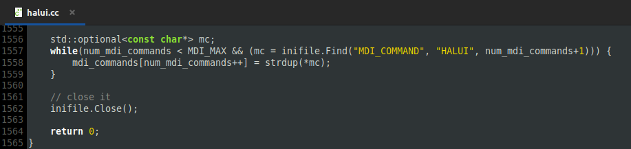

I suspect the answer to the Subject's question is "no", since I've found no reference anywhere (except on a very old sourceforge thread) to "MDI_COMMAND0", "MDI_COMMAND1", etc.
But is there any reason the HALUI section, and the code that reads it, couldn't be enhanced to allow that? It would be nice not to have to worry about ordering. It would also make the .ini file more "standards compliant" -- it's highly unusual to have multiple values with the same key in an ini file. The crudini command, for example, will toss all but the last such entry.

This seems to be the section in halui.cc that parses the MDI_COMMAND entries in the ini file:
It basically adds the commands to an array in the order they appear in the [HALUI] section. I guess it would be possible to parse each entry for the number and place it in the appropriate element of the array but I'm not sure if it's really worth the effort as there are other keys that can occur multiple times (eg 'REMAP' or 'HALFILE').
