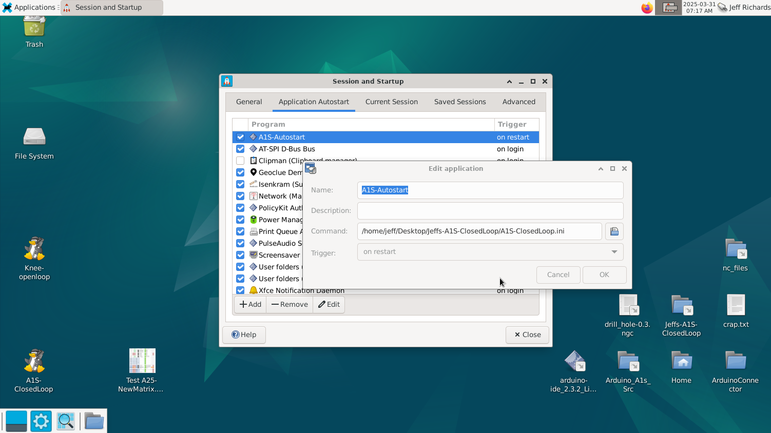

Autostart Axis

31 Mar 2025 07:21 #325390
by slowpoke
Autostart Axis was created by slowpoke

31 Mar 2025 07:52 #325394
Replied by Aciera on topic Autostart Axis
'Command' needs an actual application (ie linuxcnc) not just a path to an ini file:
try:
Also you might want to change the 'Trigger' to 'on login'
try:
/usr/bin/linuxcnc '/home/jeff/Desktop/Jeffs-A1S-ClosedLoop/A1S-ClosedLoop.ini'Also you might want to change the 'Trigger' to 'on login'

01 Apr 2025 03:30 #325451
by slowpoke
Replied by slowpoke on topic Autostart Axis
Aciera,
Thank you works like a charm.
