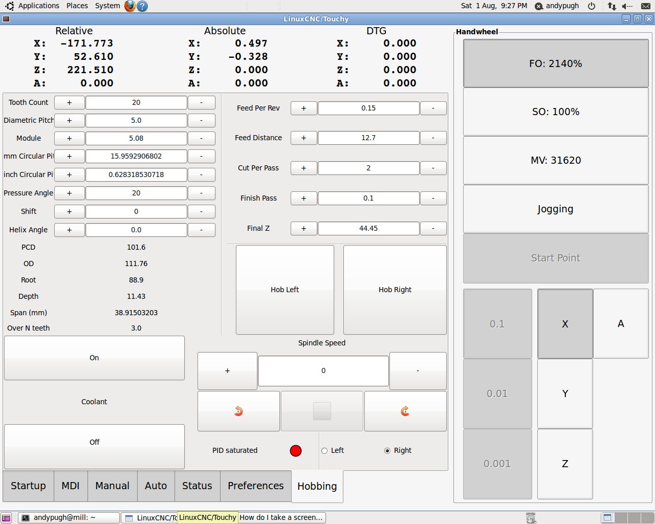

15 Apr 2025 06:58 #326350
Replied by andypugh on topic ENCODER_RATIO function implementation.
The following user(s) said Thank You: timo
- timo
- Posts: 211
- Thank you received: 61
17 Apr 2025 00:03 #326508
by timo
Replied by timo on topic ENCODER_RATIO function implementation.
Thanks for the screen shot.
I think it looks "good enough" (at least for me
using it for DIY hobbing of "toy gears" )
Do I understand this right that a G-code file is generated based on the input data to run the process?
Does "shift" button refer to profile shift or is it doing a hob shift? (tangential hobbing :-O )?
Greetings Timo
Greetings Timo
- Posts: 19908
- Thank you received: 4660
18 Apr 2025 04:48 #326584
There is a fixed but parametric G-code file as part of the config that does the feeding / multiple passes.
You should definitely look at that file to see what it does, and also what it assumes. The system assumes that the tip of the cutter is touched-off to the workpiece radius (ie Z = 0 is on the work axis)
Also note that the axis assignment is a little unusual, with hobbing radius as Z and work axis along X.
"shift" is a profile shift, simply a radial offset of the hob relative to the workpiece centreline.
