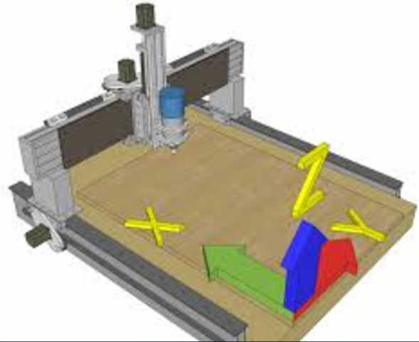

1 year 6 months ago #326497
Replied by tommylight on topic rotary axis queston
If there is no particular and very strong reason for it, i would avoid using the pictured axis designations, it will cause constant headaches with any CAM software you might use.

Ok here are the 2 files you requested, I could not find the line you said to delete (Home_'''_ velocity).With the choice of the Axis configuration, has not caused any problem with any of the CAD software I use.(SheetCam, Estlcam, and Lightburn) this sort of shows how it is image missing /media/kunena/emoticons/silly.png

1 year 6 months ago #326543
Well, yes and no, not the same thing.
If the arrow on the X axis shows towards positive values, it is wrong, but if it shows towards negative then all is good.
From your ini file:

In the lay out the X arrow is not correct as it is to the negative, not positive as mine is.
