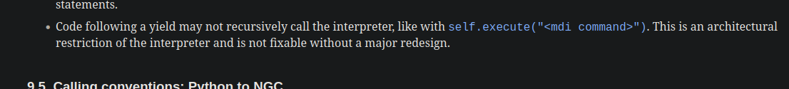

Also note this restriction for the 'yield' feature:
linuxcnc.org/docs/html/remap/remap.html
which means that code like this is not allowed:
instead you could use:
if router_down:
print("Raising Router (P14)")
self.execute("M64 P14")
yield INTERP_EXECUTE_FINISH
time.sleep(2)
self.execute("M65 P14")
yield INTERP_EXECUTE_FINISHinstead you could use:
if router_down:
self.execute("G04 P2")
self.execute("M65 P14")Premature execution of the python remap by the read ahead may also be a problem. While 'yield INTERP_EXECUTE_FINISH' at the beginning would prevent that it would also bar the use of 'self.execute()' after it (as pointed out above). My usual workaround is to call the python remap through an ngc wrapper like this:

That was it, adding the self.task == 0 at the beginning solved the read ahead issue and removing the yeilds in the middle of the g-c-code operation took care of it! Behaves like expected, M-codes execute and the tool change executes with the offset. Got quite a few commits trying to troubleshoot this one. Thanks for the help!
