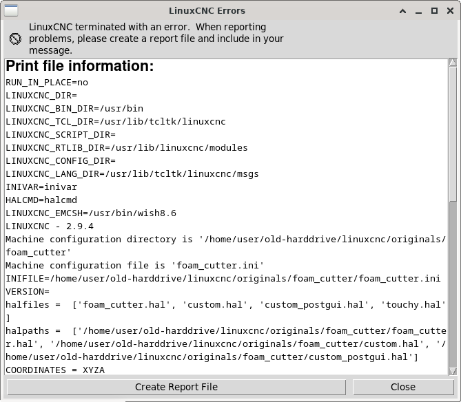

CNC doesn't work with new update
- foam man
- Posts: 65
- Thank you received: 5
13 Apr 2025 17:50 #326235
by foam man
CNC doesn't work with new update was created by foam man

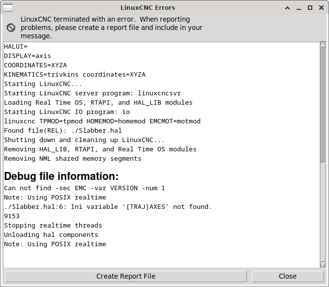

As the debug message indicates, line 6 in your 'Slabber.hal' expects a value for the keyword 'AXES' in the [TRAJ] section of your ini file.

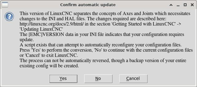

Are you sure that you were on 2.8.2? The big update was 2.8.x to 2.8.x
(but I don't think that the update script changes it's warning depending on the actual versions)
[TRAJ] AXES has always been there, so I am not sure what the updater has done to make it apparently disappear. Do you perhaps now have _two_ [TRAJ] sections in the INI?

I dont thimk so. when i checked the ini file, there was nothing under Traj, so i added AXES=4, and it worked
