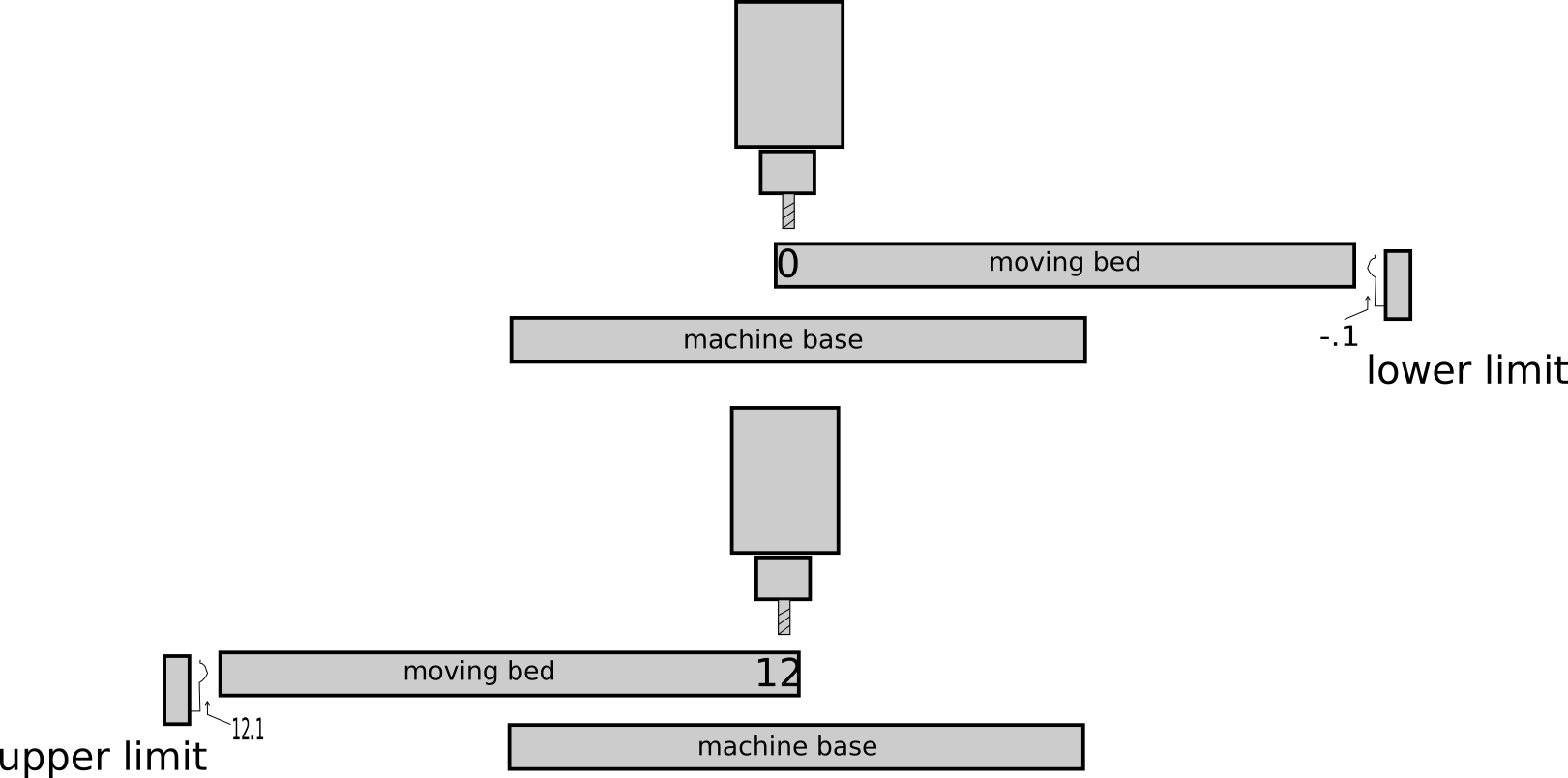

Okay, I think a picture will help.
Homing on 0 works, as in the upper diagram. But it leaves the bed far from me. In the title of the thread, I asked whether there's a way to automatically move after homing, so that I end up as in the lower diagram. I haven't yet tested whether simply setting "HOME" to 12, rather than 0, would accomplish this. That's because since homing (and even rapids, on my mill) are very slow, I'd really rather skip the extra bed travel, and have it home directly to 12, and stayed there.

Replied by spumco on topic After homing X and Y, can I auto move to a non 0,0 location?
OP-
Thank you, that helps.
Would you like the table to be as close to the operator as possible (max Y) as well as centered on X when the homing routine is complete? This is how I've configured my moving-table mill.

Replied by pgf on topic After homing X and Y, can I auto move to a non 0,0 location?
That would be great -- but I'd also be happy with simply max-X and max-Y.

Thanks for thinking so hard about this. I appreciate it.
Two things: first, because of how my switches are set up, I believe both HOME_SEARCH_VEL and HOME_LATCH_VEL need to be positive. The backoff movement is added automatically in between them. Second, HOME_FINAL_VEL isn't a signed velocity. I realized that yesterday while trying various combinations. It would probably be better if the homing code threw an error, since it implies a slight misunderstanding of the config, but instead it seems to simply use abs(HOME_FINAL_VAL).
In the end, the difference between what you propose and what I tried yesterday is the value of HOME_OFFSET. That could well make the difference. I'll try it later today.
