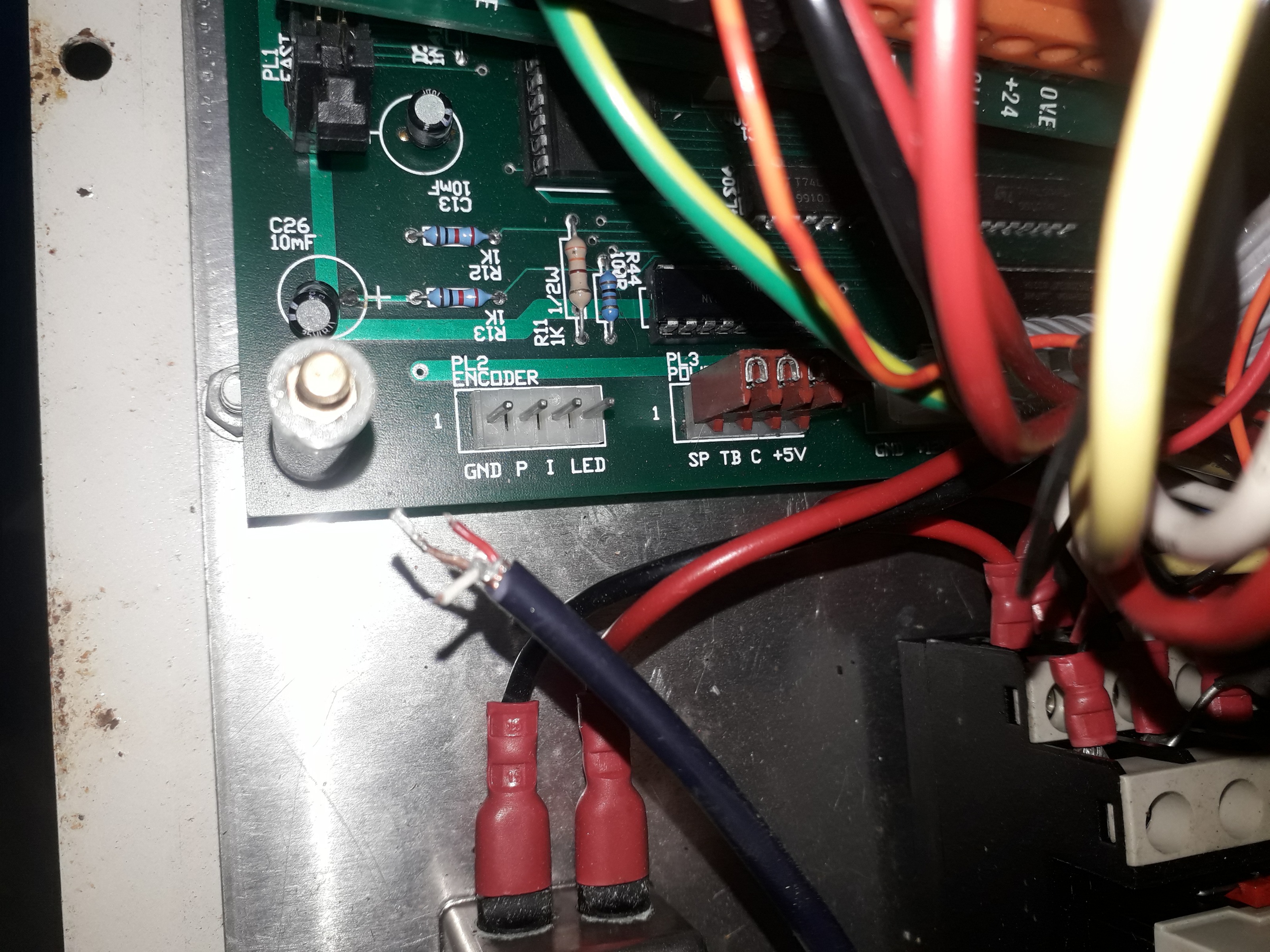

boxford 160tcl
- Turners
- Posts: 74
20 Apr 2025 07:33 #326761
by Turners
boxford 160tcl was created by Turners
- Posts: 19908
- Thank you received: 4660
21 Apr 2025 12:06 #326817
Replied by andypugh on topic boxford 160tcl
A multimeter in diode-check mode can identidy the LEDs. (almost certainly black gnd and red power) and then if the other two are wrong, swap them. P should be several pulses per rev, I should be one pulse per rev.
