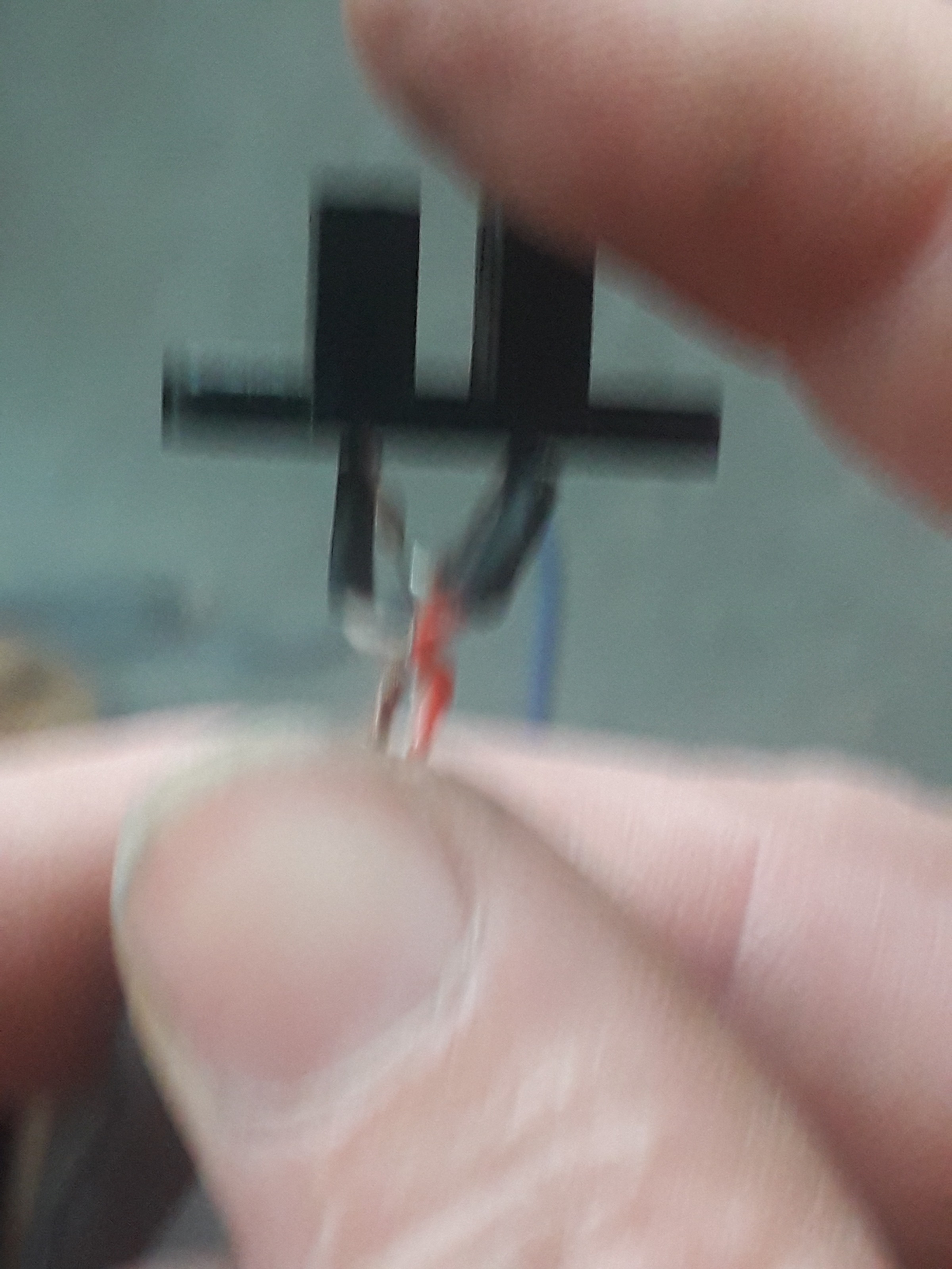

Hi all
I'm trying to piece together a boxford 160 to standard.
almost there I have all axis wired up and runing.
anyone know where I can find the correct one of these?
it's a minefield looking on rs components
it's a microsensor but looking at specs they dont macth what I think I need. any advice would be great..

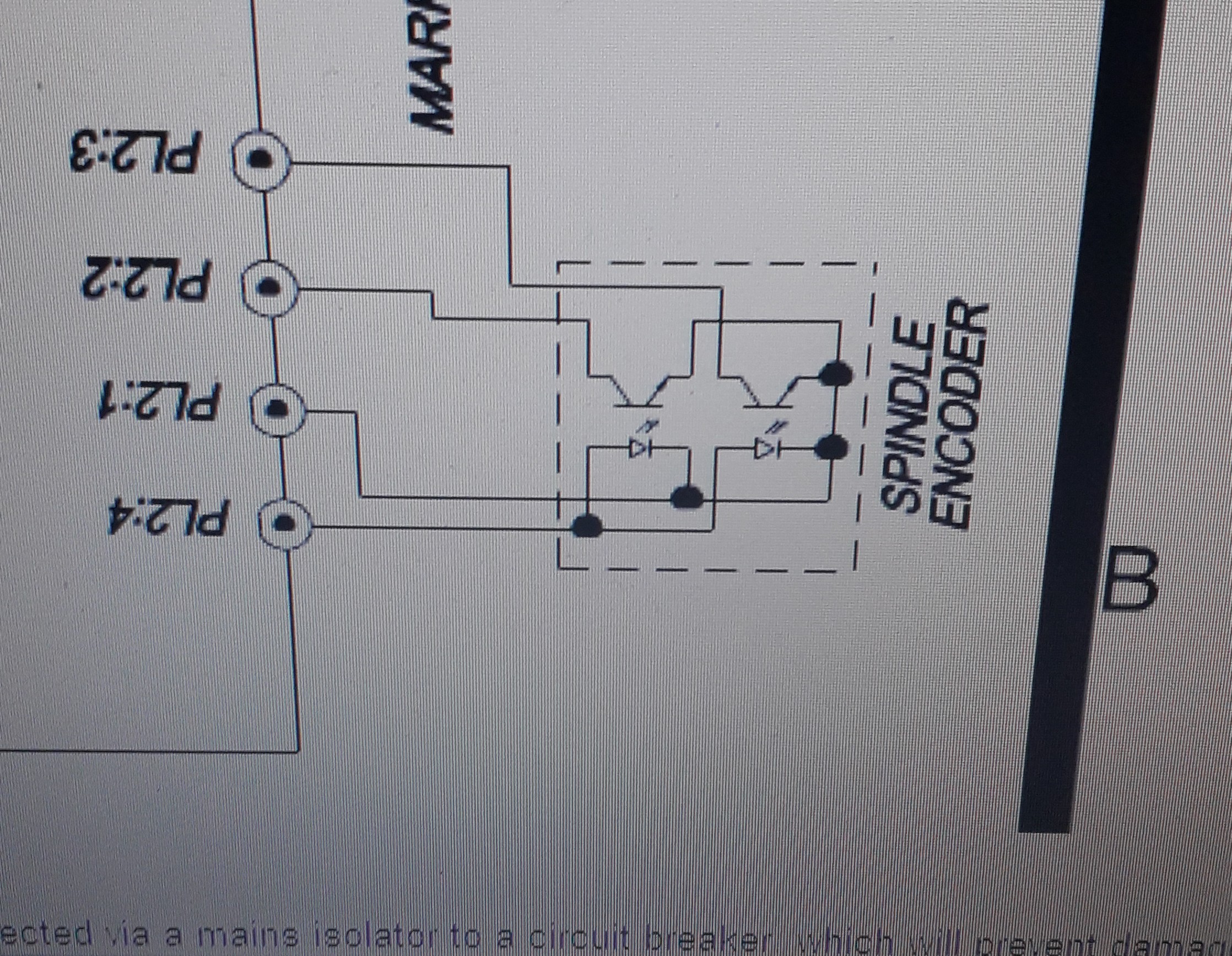

21 Apr 2025 16:43 #326841
Replied by tommylight on topic boxford 160tcl
Not sure, your pictures show a normal single led/sensor device, but the schematics show a dual led/sensor device.
How many wires does yours have on each side?

21 Apr 2025 17:10 #326842
by Turners
Replied by Turners on topic boxford 160tcl
I'm unsure that Sensor I was holding is not the original for this machine. i was hoping someone had the same machine and would be able to point me in the right direction. I guess I need a dual one. it should have 4 wires 2 on each side.

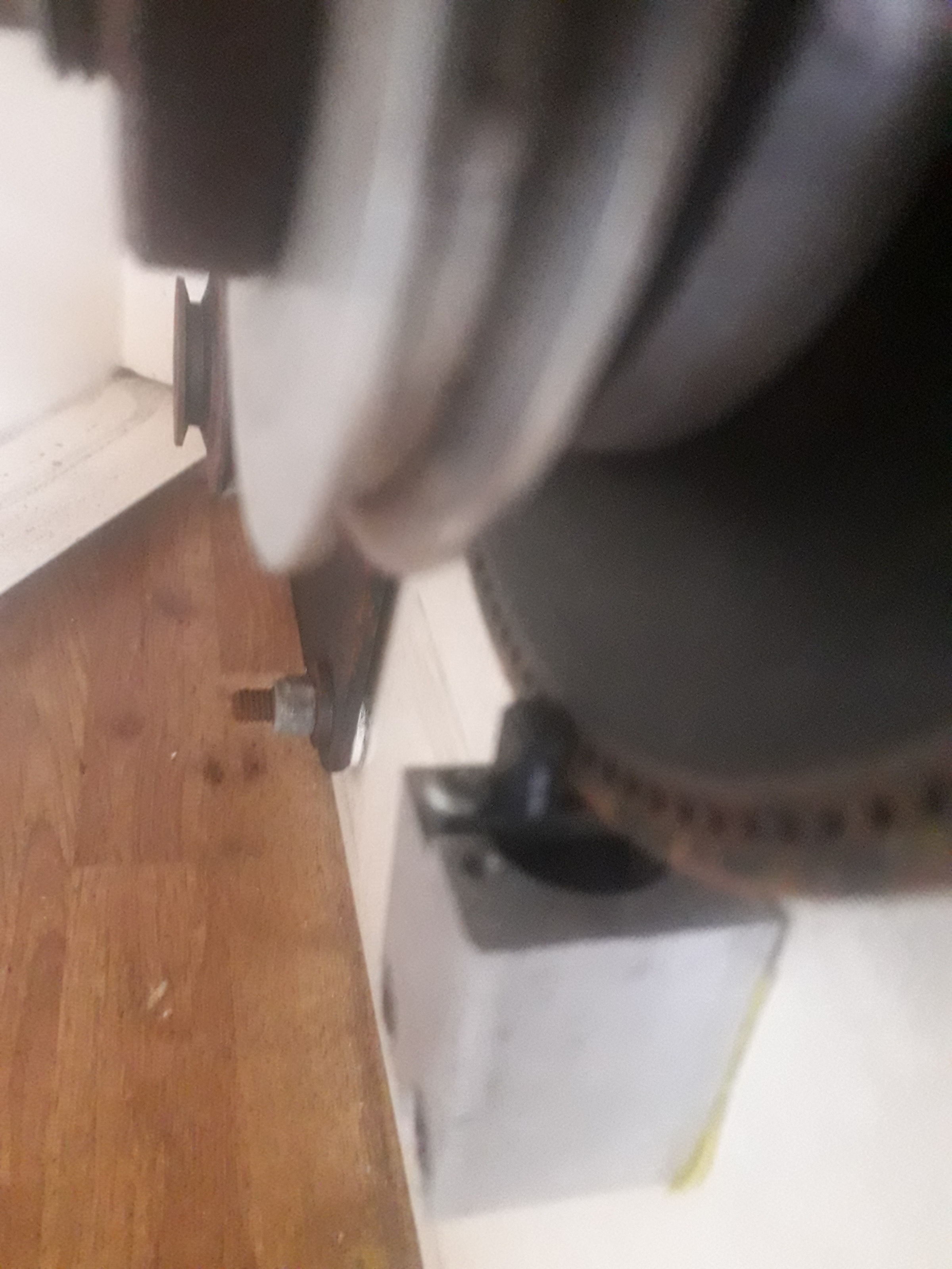

21 Apr 2025 17:44 #326846
OK, lets look at it from the other side, is that wheel with round holes on your actual machine?
where so sensor wires go and how many pins are there?

22 Apr 2025 13:24 #326904
by Turners
Hi guys just an update it should have 2 separate ones one counts the large slot and one counts a single slot. so two go one plug. still unsure what to buy something like this? but pre wired ones as my soldering ability

22 Apr 2025 15:09 #326912
by Turners
Hi guys sorry to spam I've been told I need two of these opb866t55 but as cannot solder in need the wired equivalent could
anyone recommend from rs components link please?
