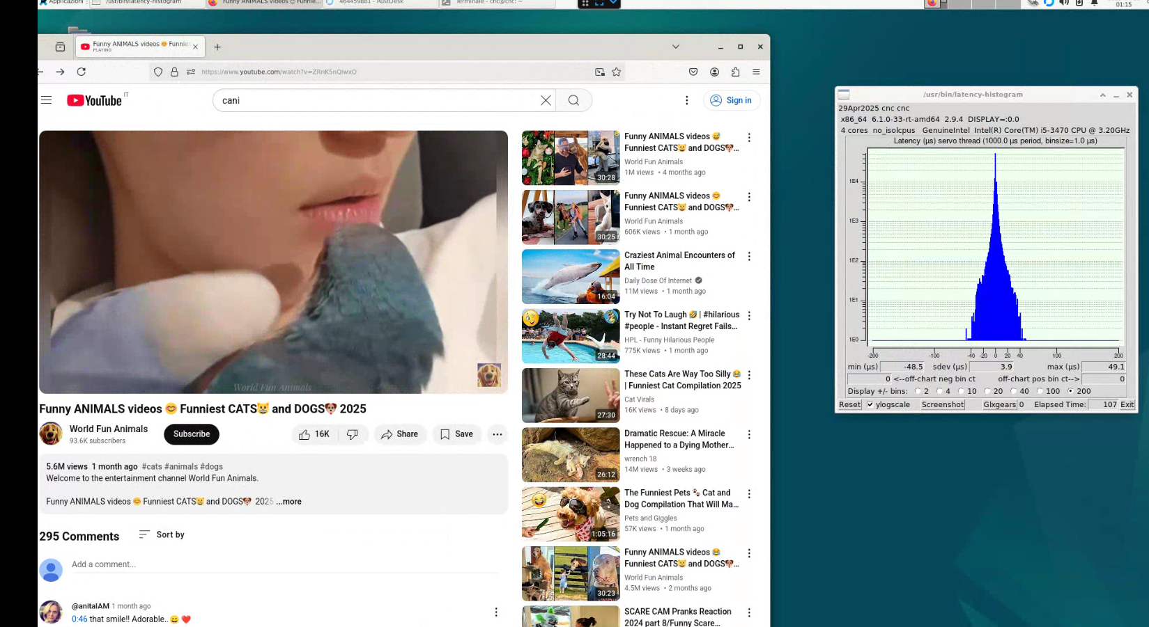

28 Apr 2025 23:16 - 28 Apr 2025 23:17 #327251
by DarkPhoinix
Replied by DarkPhoinix on topic linuxcnc Latency test ambiguous results
Last edit: 28 Apr 2025 23:17 by DarkPhoinix.

28 Apr 2025 23:36 #327253
Replied by tommylight on topic linuxcnc Latency test ambiguous results
Looks perfectly fine, so do some tests with Mesa card attached and again do copy some stuff around, play video, etc, see if it drops the link.
If not, move on to making chips!

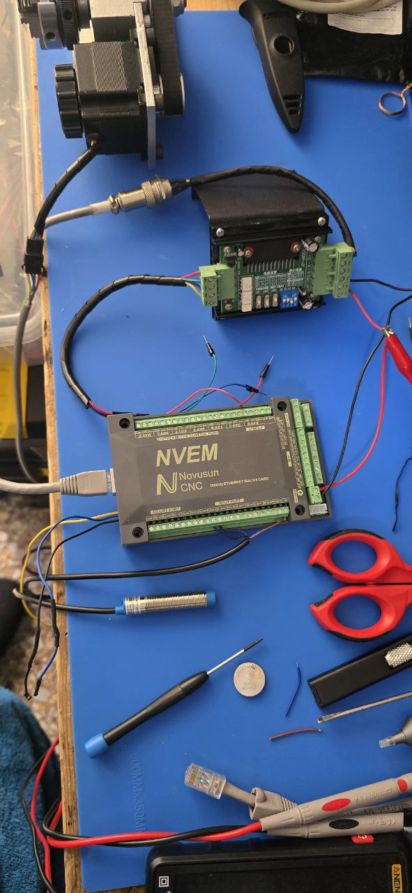

I still don't have the steppers or the drivers, I hope they will arrive soon, for now I have tested with only this stepper and driver connected:
thinking this was the problem I disconnected the stepper and left the card alone but the error is the same as soon as I start a video on YouTube or if I start chrt 99 ping -i .001 10.10.10.10 -c 40000000
the file conf:
driver:TB6560 JP-1635A
stepper: 57HD0401 15SB
controller: NVEM V5
Stepper and driver is only for test not final hardware.
the file conf:
controller: NVEM V5

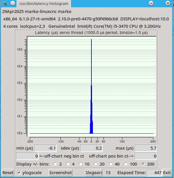

- MarkoPolo
- Posts: 319
- Thank you received: 90
29 Apr 2025 14:48 #327295
by MarkoPolo
Replied by MarkoPolo on topic linuxcnc Latency test ambiguous results
The following user(s) said Thank You: DarkPhoinix
- DarkPhoinix
- Posts: 107
- Thank you received: 6
29 Apr 2025 15:42 - 29 Apr 2025 15:45 #327300
by DarkPhoinix
I was just going down that road, I found a post where it was talked about, For now I did this:but I would like to try to add: rcu_nocbs
can you share your lspci result?
BOOT_IMAGE=/boot/vmlinuz-6.1.0-33-rt-amd64 root=UUID=e5282ae9-3e96-4f4e-9c6c-19b3dd421c80 ro initrd=/install/gtk/initrd.gz quiet isolcpus=1,2 r8168.EEE=0 pcie_aspm=off nohz_full=1,2 can you share your lspci result?
