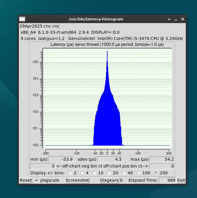

Is it working? I don't understand what cat /proc/interrupts does maybe there are old values before the switch to core 3?

That looks like its working since you are only getting interrupts on CPU 3
(CPU 2 interrupt count is not changing)

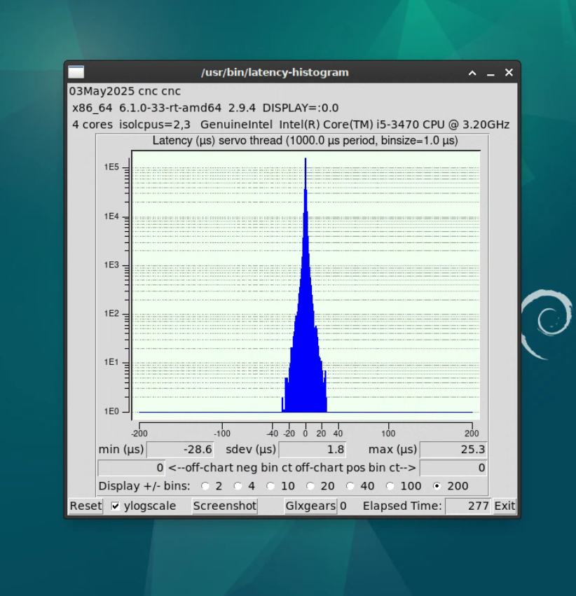

03 May 2025 13:41 #327625
by DarkPhoinix
Replied by DarkPhoinix on topic linuxcnc Latency test ambiguous results
- DarkPhoinix

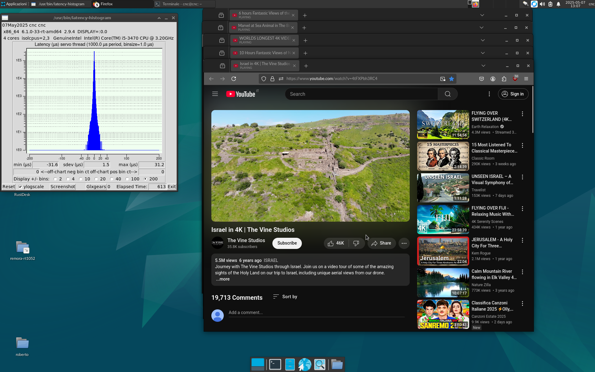

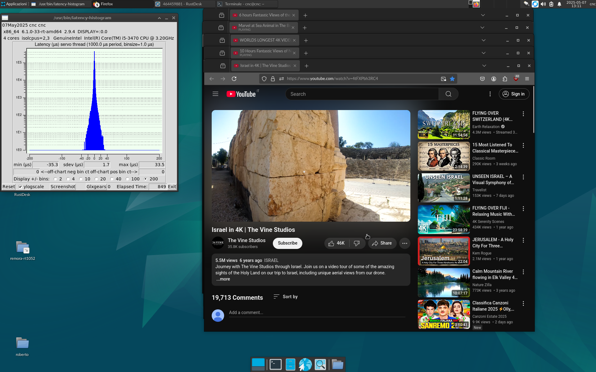

07 May 2025 05:48 - 07 May 2025 08:19 #327937
by DarkPhoinix

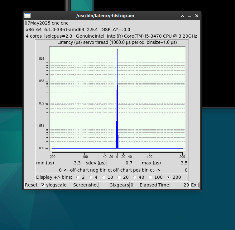

Next i upload the DMA txt version for mi NVEMV5 RT1052 the problem is back and now need only 5 videos 4k without rustdek opened to see junction error!
I don't know what else to do. Except look for a motherboard that has video output.
Or maybe buy new hardware?
No activity
5 youtube video 4k windows
5 youtube video 4k windows and rustdesk connection
No activity
Last edit: 07 May 2025 08:19 by DarkPhoinix.

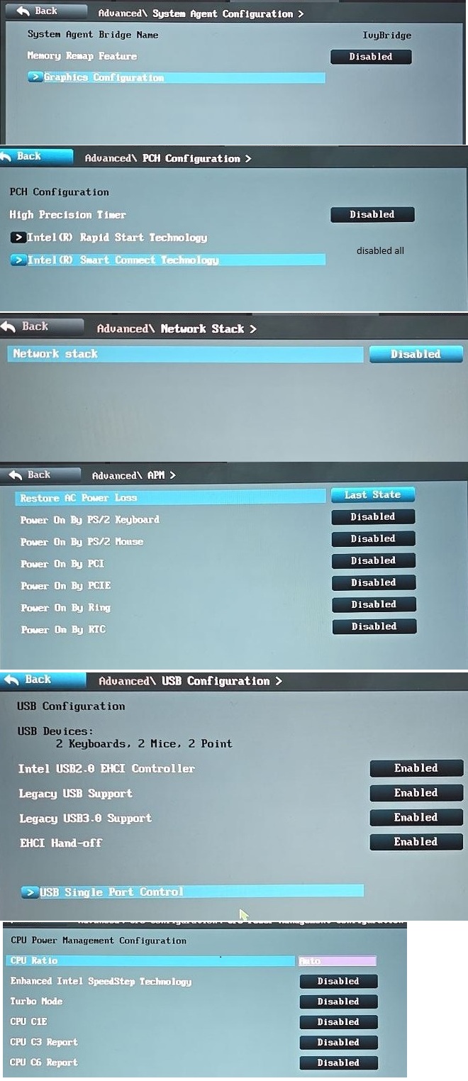

I've tried everything:
in the ini I put:kernel parameters:
it doesn't work, I get improvements and delays in the error but while using YouTube sooner or later the job fails.
I'm understanding that LinuxCNC only works with specific hardware systems and it's not possible to use it everywhere. I have also tried 3 completely different hardware setups, and the other 2 have impressive latencies.
One of which is new hardware with integrated video card, Alder Lake N95 CPU, and 16GB of RAM.
So the question is: what hardware supports LinuxCNC? What hardware should a user buy who wants to use LinuxCNC?
in the ini I put:
#SERVO_PERIOD = 1000000
SERVO_PERIOD = 2600000
#SERVO_PERIOD = 700000
#SERVO_PERIOD = 777777
#SERVO_PERIOD = 1000000#GRUB_CMDLINE_LINUX_DEFAULT="quiet isolcpus=2,3 r8168.EEE=0 pcie_aspm=off nohz_full=2,3 acpi_irq_nobalance noirqbalance irqaffinity=0 processor.max_cstate=0 intel_idle.max_cstate=1"
#WORKS WELL#GRUB_CMDLINE_LINUX_DEFAULT="quiet isolcpus=2,3 r8168.EEE=0 pcie_aspm=off nohz_full=2,3"
#GRUB_CMDLINE_LINUX_DEFAULT="quiet splash isolcpus=2,3 r8168.EEE=0 pcie_aspm=off nohz_full=2,3 acpi_irq_nobalance noirqbalance irqaffinity=0 processor.max_cstate=0 intel_idle.max_cstate=1 radeon.dpm=0 idle=poll"
#GRUB_CMDLINE_LINUX_DEFAULT="quiet splash isolcpus=2,3 r8168.EEE=0 pcie_aspm=off nohz_full=2,3 acpi_irq_nobalance noirqbalance irqaffinity=0,1 processor.max_cstate=0 intel_idle.max_cstate=1 radeon.dpm=0 idle=poll"
#GRUB_CMDLINE_LINUX_DEFAULT="quiet splash isolcpus=2,3 r8168.EEE=0 pcie_aspm=off nohz_full=2,3 acpi_irq_nobalance noirqbalance irqaffinity=0,1 processor.max_cstate=0 intel_idle.max_cstate=1 idle=in"
GRUB_CMDLINE_LINUX_DEFAULT="quiet splash isolcpus=2,3 r8168.EEE=0 pcie_aspm=off nohz_full=2,3 irqaffinity=0,1 processor.max_cstate=0 intel_idle.max_cstate=1 idle=poll"it doesn't work, I get improvements and delays in the error but while using YouTube sooner or later the job fails.
Last edit: 08 May 2025 07:00 by DarkPhoinix.

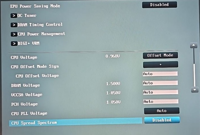

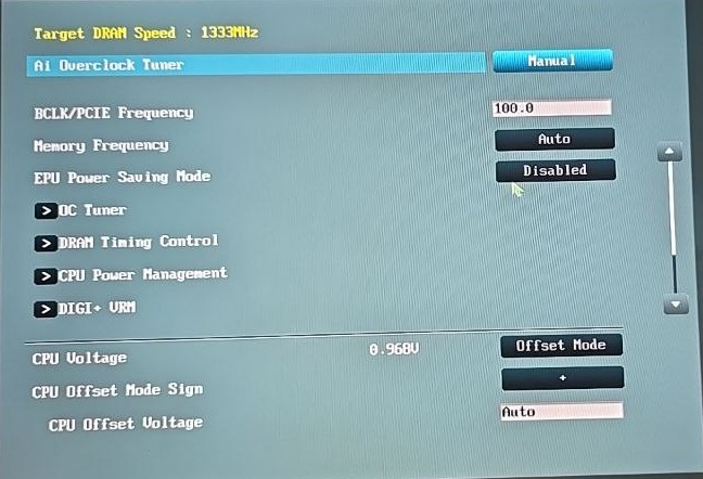

08 May 2025 07:18 - 08 May 2025 07:21 #327987
by DarkPhoinix
Last edit: 08 May 2025 07:21 by DarkPhoinix.
- DarkPhoinix
- Posts: 107
- Thank you received: 6
08 May 2025 12:08 #328017
by DarkPhoinix

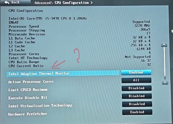

Thanks,

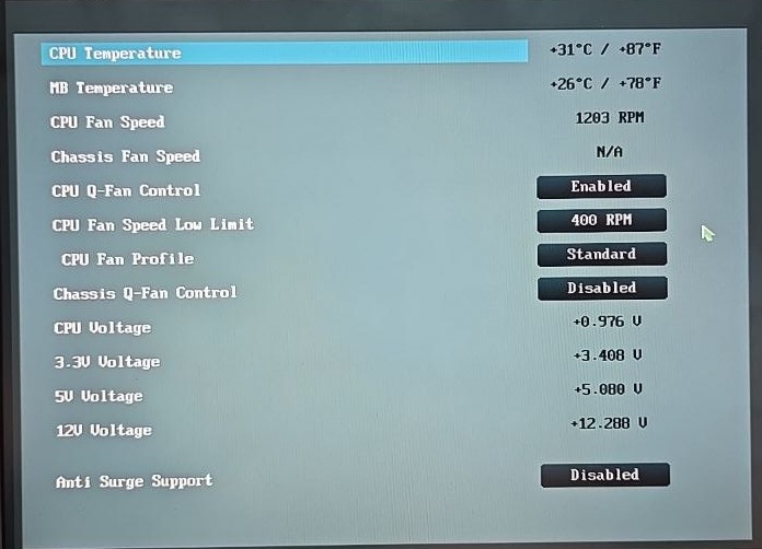

intel adaptive thermal monitor need set disable? i dont want burn CPU!
