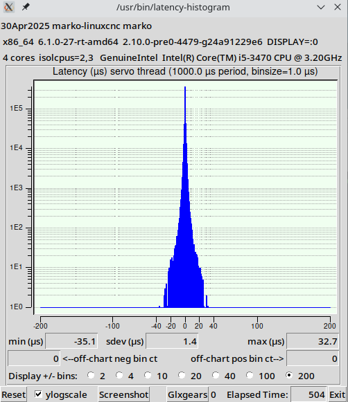

- MarkoPolo
- Posts: 320
- Thank you received: 92
29 Apr 2025 13:17 #327306
by MarkoPolo
Replied by MarkoPolo on topic linuxcnc Latency test ambiguous results
I have these kernel parameters set "quiet isolcpus=2,3 acpi_irq_nobalance noirqbalance irqaffinity=0 processor.max_cstate=0 intel_idle.max_cstate=1"
From what I remember, better results are when you isolate 3rd and 4th core.
The "stress" test should not affect core 3 and 4.

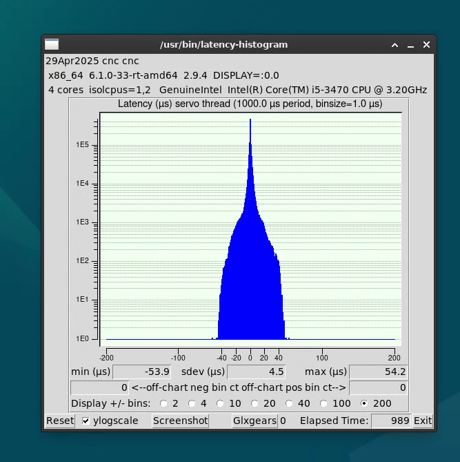

- DarkPhoinix
- Posts: 107
- Thank you received: 6
29 Apr 2025 13:45 - 29 Apr 2025 14:00 #327308
by DarkPhoinix
Replied by DarkPhoinix on topic linuxcnc Latency test ambiguous results
You have integrated VGA i have a NVIDIA 610 i think is this the cause of high latency , my motherboard don't have vga output!
can you try use Rustdesk remote desktop with youtube video and try another time latency test?
Last edit: 29 Apr 2025 14:00 by DarkPhoinix.
- MarkoPolo
- Posts: 320
30 Apr 2025 04:49 #327331
by MarkoPolo
I don't use remote desktop. I did a test with three working youtube videos

- DarkPhoinix
- Posts: 107
30 Apr 2025 06:31 #327336
by DarkPhoinix
Hi tommylight, have you seen my configuration? is a default conf.No, not yet.
Now is that point where you upload your configuration files here so we can have a look, joint errors are usually miss configuration on stepper systems.
What board are you using?
