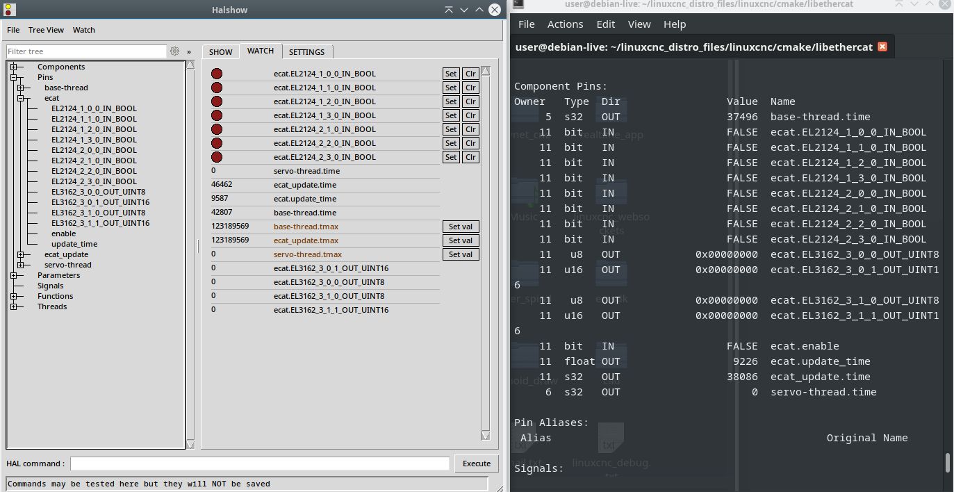

Hi all,
I was wondering why lcnc don't have the data types U8, U16, S8, S16 to use with ethercat lcec?
To me it looks like the lcec is some times loading S32 types (bigger data types) when it could load a U8.
The result is in-effiecient memory management. Don't get me wrong if this is not the case.
This issue came to light when i made a few tests to automate the ethercat hal pin setup for lcnc.
After automated hal pin setup worked i added new hal data types into the lcnc source code : U8, U16, S8, S16
Now the ethercat data types can be used 1:1 with lcnc.
For example a ethercat U16 is loaded into a hal pin off type U16 and
not as a U32 as before. This saves us the memory size of a U16 i guess?
Mention the automated hal pin names and the new data types:
In above picture, a component called ecad.so is loaded in hal. (lcec replacement)
The component name: ecad.so
When the component start's up, it load's c++ code that has a automated hal pin setup under the hood,
looking what kind off data types are used etc.
Setting up the hal pins : hal pin setup
And at runtime update the hal pins every cycle :
Update hal pins: hal_pin_update
So far above situation works quite well.
In the ecad.so component we don't need any .xml config file anymore.
As the component just throws out all hal pins from the ethercat bus by itself.
What i didn't code yet, is time dc synchronisation. I tested a stepper config in axis, and steppers run just
as fast as using the linuxcnc-ethercat config. However i am on a really bad desktop pc.
Axis stepper config, driving one stepper motor: axis config

halType is limited to the data type that are in hal: bit, float, s32, u32.
Whatever comes from ethercat will be shoe-horned into one of those.

There is no point in having 16bit numbers from ethercat, because to connect to subsequent components they will have to be converted to 32bit anyway by loading additional components to convert 16->32.
The LCEC component does this automatically in the XML configuration. pdoentry
In practice, there will probably never be any memory problems, as the number of pdos and sm is quite limited.
There have also been suggestions in the forum to make all HAL pins 64bit for standardisation, as encoders have a problem with overflowing 32bit numbers.

Yes that 64-bit integer data-type is missing in hal, but I think I heard that might change for next release. Don't quote me on that though.

Andy wants to replace 32 bit pins with 64 bit pins in 2.10. Some people don't agree with this as it could result in unexpected consequenses (me included). for example I can see it breaking the Ethercat driver.

I got 64-bits float implemented in the EtherCAT driver when I asked for it, lcec and lcec_conf. Quickly and not a big problem.
64-bits integers are needed for EtherCAT. When there is a push to move to 64-bit integers in linuxcnc,
we should jump on that opportunity.
"Don't know the consequences" is the worst reason ever, one finds out the consequences and then decide.
