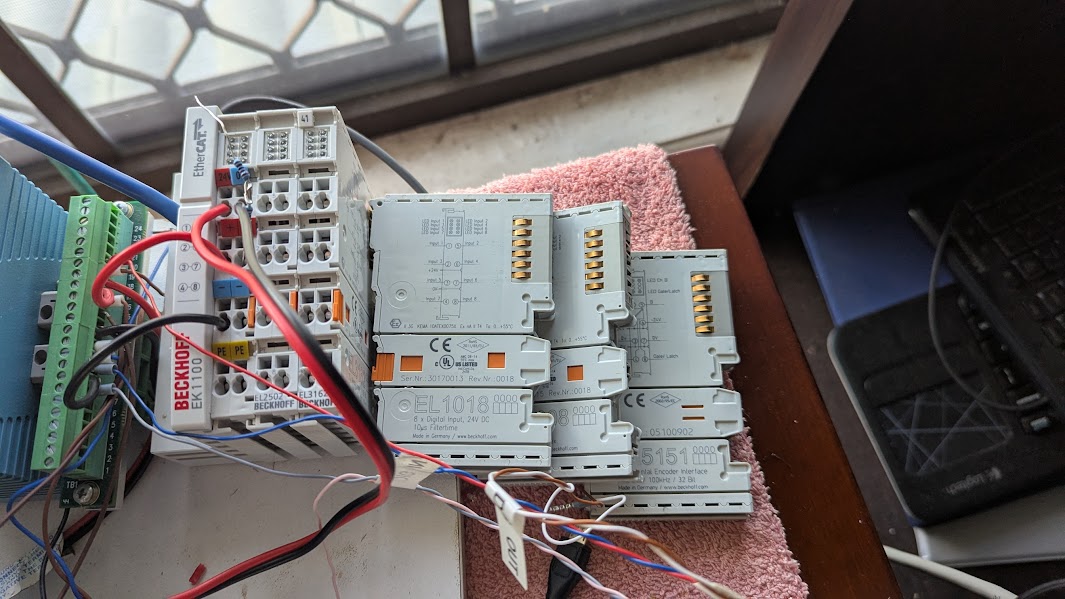

- Posts: 12178
- Thank you received: 4155
10 May 2025 15:28 #328178
Replied by rodw on topic Ethercat LinuxCNC board for a 4 axis router
Yes, there are generic Ethercat IO modules but many of them will require you to write a driver for them.
An alternative is to look at a Beckhoff EK1100 and add modules to it to unit your needs
These can be pretty expensive but man of them are supported in the Ethercat hal driver.
You can find them second hand reasonably priced on ebay

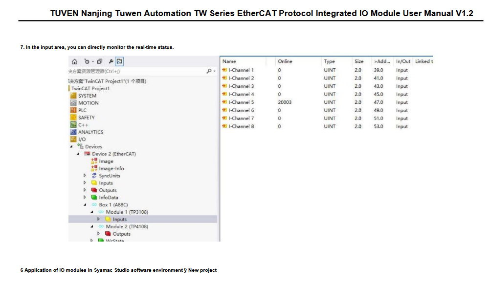

- Hakan
- Posts: 1348
- Thank you received: 497
11 May 2025 03:23 #328190
by Hakan
Replied by Hakan on topic Ethercat LinuxCNC board for a 4 axis router
The device linked to from aliexpress should work, it is a simple interface that is easily configured with the generic device.
But be prepared to learn the translate tool in your browser, documentation is all in chines.
Here is a translated screen shot from the manual
If you understand what this is, go right ahead. If you don't understand it, take a safer and easier path.
