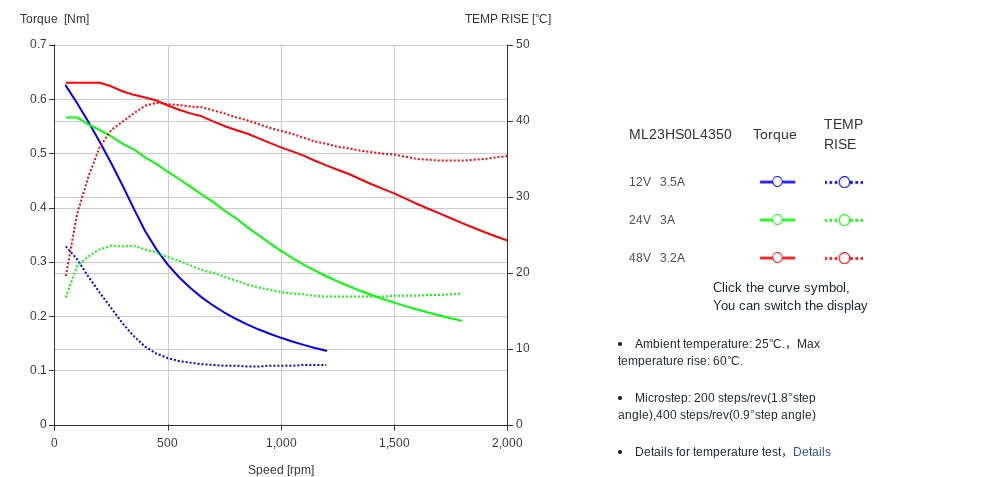

Linuxcnc wood lathe insufficient torque
- Posts: 12178
- Thank you received: 4155
25 May 2025 03:47 #329094
www.moonsindustries.com/p/nema-23-standa...0-000004611110011244
The temperature rise was a max of 60 deg C (40 deg in the graph) so still at a very safe level.
Replied by rodw on topic Linuxcnc wood lathe insufficient torque
There is more on the table yet! Have a look at the green and red lines here showing the torque difference between 24v and 48v for a 3.2 amp nema 23 stepperThanks rodw, I had ordered a DM542 from Steppersonline and it arrived today. Even with the 24v and 270OZ stepper and DM542 set at 3A I now have plenty of torque. Problem solved. I guess the TB6600s weren't up to the task.
Great to hear. I really don't know why people ever recommend TB6600's. They have been known to be cr@p for years.

26 May 2025 09:32 #329165
by jimboh2
Replied by jimboh2 on topic Linuxcnc wood lathe insufficient torque
Great info thanks. I will most likely go with the 48v supply I bought , although I will then have to add another step down supply as the board max is 24v so I will need a 48v to 24v and then 24v to 5v I already have. Worthwhile though going by the graph. I don't expect to drive at high speeds either.
