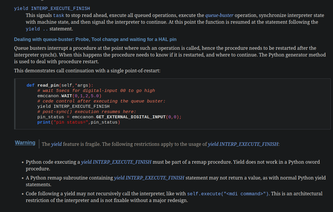

I have a couple of user defined remaps that do read and insert timestamps to a SQL database.
The problem is the interpreter executes these M-codes before the action is actually performed.
Is there a way to tell the interpreter to only execute these when they actually happen?
The remaps are python routines, hoping that a flag can be set.
Tried setting the remap modalgroup to no avail.
I have 6 machines that can make use of this.
Any help appreciated.

you can use
NOTE: No 'self.execute(..)' command can be used after this.
linuxcnc.org/docs/html/remap/remap.html
yield INTERP_EXECUTE_FINISHNOTE: No 'self.execute(..)' command can be used after this.

Thanks that worked perfectly
I was using the following which does not work for my purposes.
if self.task == 0: # ignore the preview interpreter
After removing (if self.task == 0: ), it works.
