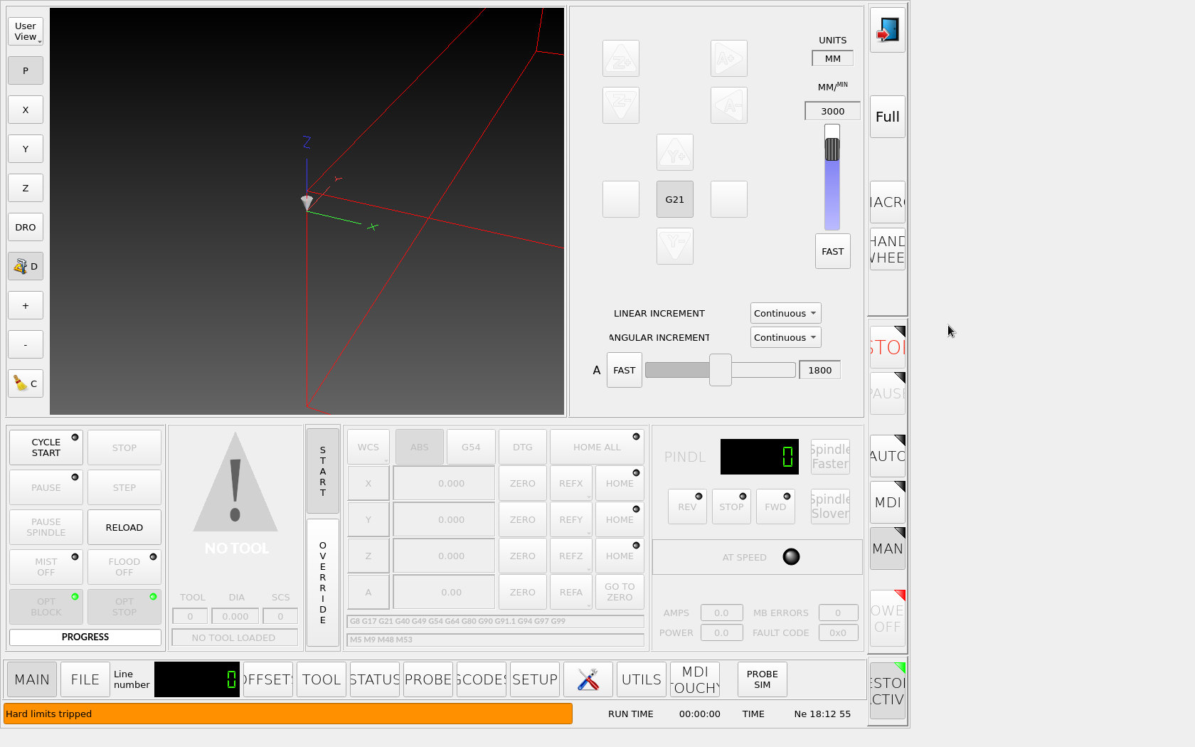

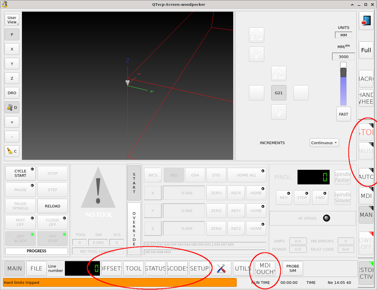

08 Jun 2025 11:18 #329959 by zz912
Replied by zz912 on topic woodpecker.ini - cant be loaded
I made tests:
woodpecker.ini works now, but need maintenance:
woodpecker_auto_tool_probe.ini doesnt work:

woodpecker_xyz.ini works now, but need maintenance like woodpecker.ini
woodpecker_xyza.ini works now, but need maintenance like woodpecker.ini
woodpecker_xyzab.ini works now, but it is in some weird full screen:
woodpecker_xyzy.ini works now, but need maintenance like woodpecker.ini
woodpecker_xyzya.ini works now, but need maintenance like woodpecker.ini
