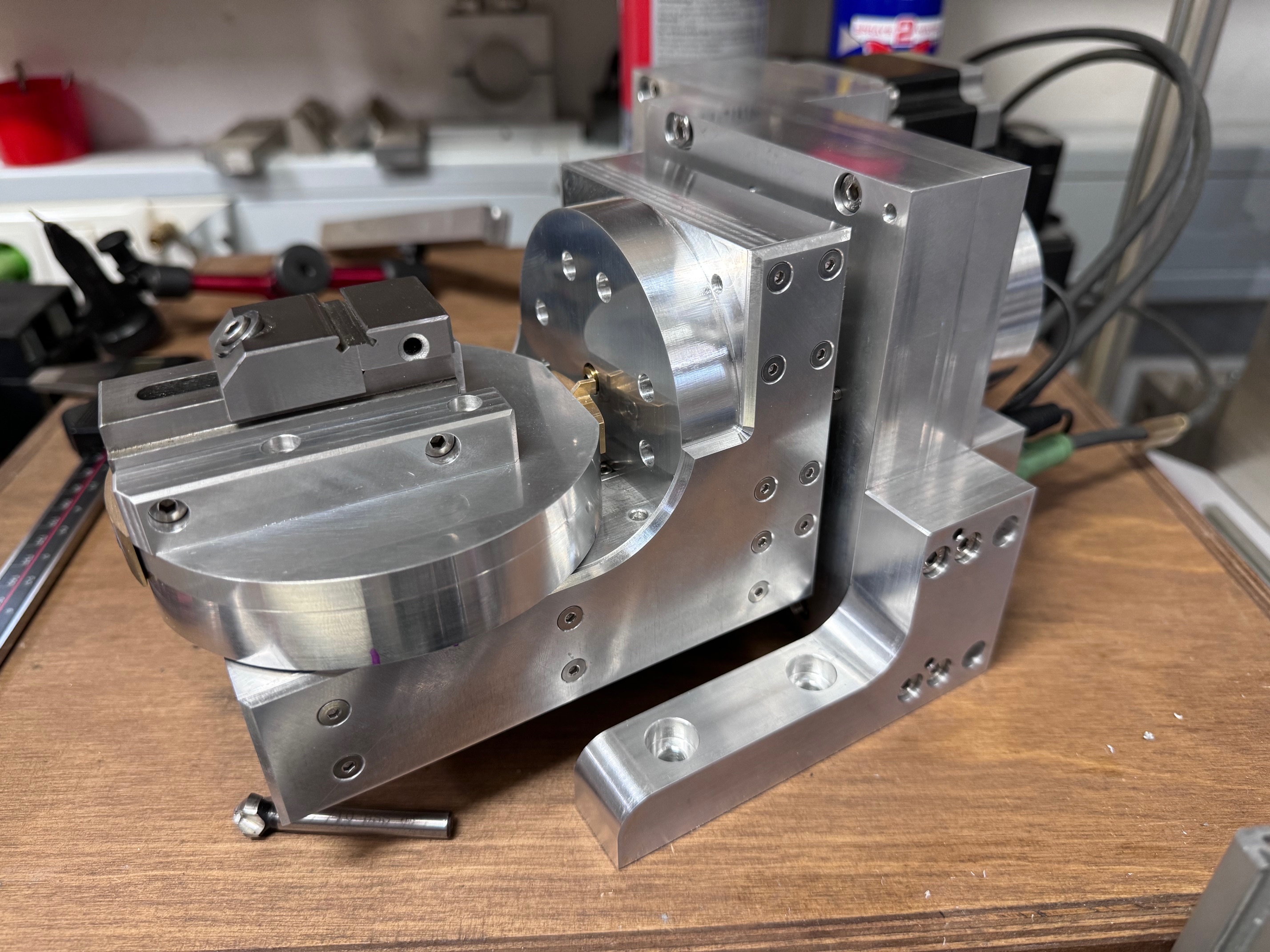

Hello dear forum, (Translation GER-ENG Google)
Short introduction:
I've been a fan of LinuxCNC for over 15 years, and unfortunately due to a lack of time (I'm sure many of us have) I've neglected my hobby a bit in recent years. I'm a bit out of programming in HAL and am looking for some food for thought or a solution to the following problem:
Compensation between B and C axis required.
I built a rotary/tilt table for my milling machine. Since my installation space is very limited, the whole thing had to be relatively small.
Harmonic drives were used for this purpose, the shaft runs through the HDrive of the B axis to rotate the HDrive of the C axis. The whole thing is solved via belt drives. Since the motor of the C axis does not pivot, it rotates when the B axis rotates. Now I need a compensation that compensates for the position of C every time the B axis moves. For one revolution of the B axis I need about 1/51th of compensation at C. My idea is to compensate for the whole thing using moveoff.
Are there already solutions that might be better, or has anyone done something similar?
I would appreciate any help and tips.
Kai

31 May 2025 03:45 #329427
Replied by Aciera on topic Compensation between B and C with moveoff?
Personally I would add the compensation to the kinematics model but if you feel more comfortable using a hal solution then why not give that a try.
There is also the external offsets feature:
www.linuxcnc.org/docs/devel/html/motion/external-offsets.html
The following user(s) said Thank You: rodw, mille5

Hello Aciera, thanks for the reply.
I haven't had anything to do with the kinematics module yet. I'll stick with the experiment in the HAL for now.
(but that will definitely happen sometime...)
I've been experimenting a bit with "moveoff-external." With a fixed offset value, it looks quite promising.
Now it's about creating a variable from the B-axis value to put it into mv.offset-in-4 (C-axis).
For the calculation, I'll use mult2 with a fixed constant of 1/51
mv.offset-in-4 = mv.pos-3 * (1/51)
I've looked at some values in the HAL show and I'm not quite sure which would be the best:
bpos-cmd, bpos-rel, or mv.pos-3.
I'll play around a bit more.
