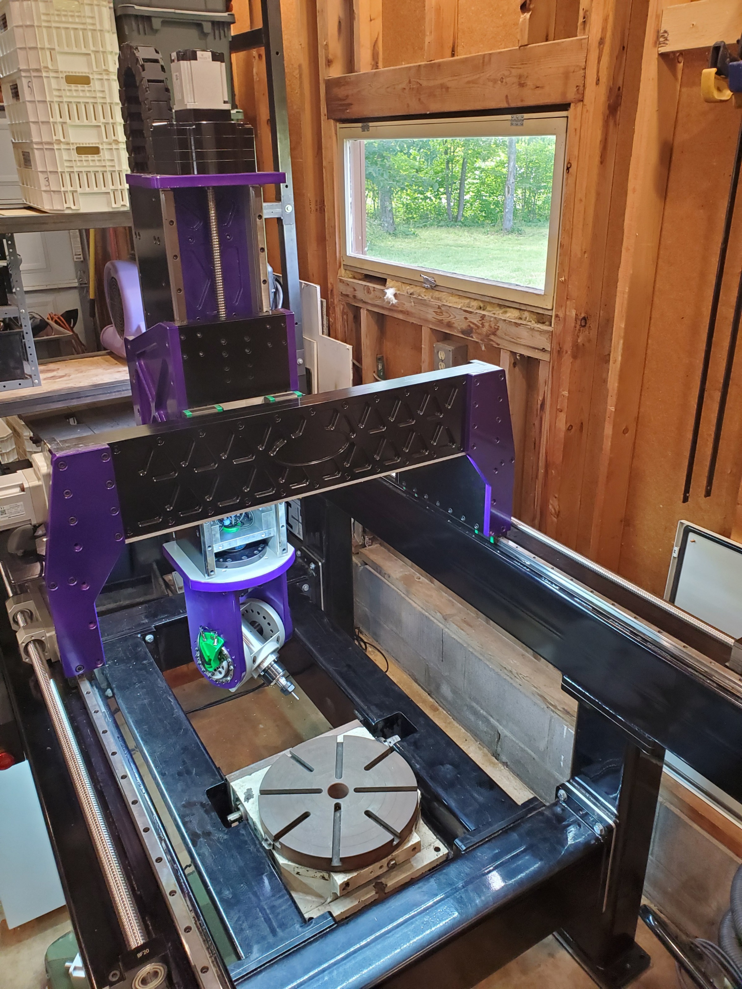

I was hoping somebody might be able to help me with modifying the 5axiskins kinematics to rotate the B axis 90deg and rename it to A axis. I have everything moving and working with the 5axiskins and switchkins, but to match up with my machine setup I have to rotate and offset the B axis 90deg.

As an alternative have a look at
'sim/axis/vismach/5axis/table-rotary_spindle-rotary-nutating/xyzbca-trsrn_twp/xyzbca-trsrn.ini' which uses 'xyzbca_trsrn.comp'
Set 'xyzbca_trsrn_kins.nut-angle' to 90°

Added photo: This is how my machine is setup. It's a bit silly because I have two "C" axis setup. Specifically I want to use it to make drums so I wanted the rotary table to keep round things more concentric than just interpolating a circle.

Ah, yes, I forgot, that sim config and kinematic is only available in the 'master' version.
[Edit]
you could install 'xyzbca_trsrn.comp' in your current version 2.9.4 using the 'halcompile' tool (you might need to install the 'linuxcnc-uspace-dev' package first):then you can change to the folder containing 'xyzbca_trsrn.comp' and run
The 'xyzbca_trsrn' kinematic is now installed on your system and you could copy the simulation folder
github.com/LinuxCNC/linuxcnc/tree/master...ndle-rotary-nutating
to your system.
[Edit]
sudo apt-get install linuxcnc-uspace-devsudo halcompile --install xyzbca_trsrn.compThe 'xyzbca_trsrn' kinematic is now installed on your system and you could copy the simulation folder
to your system.
