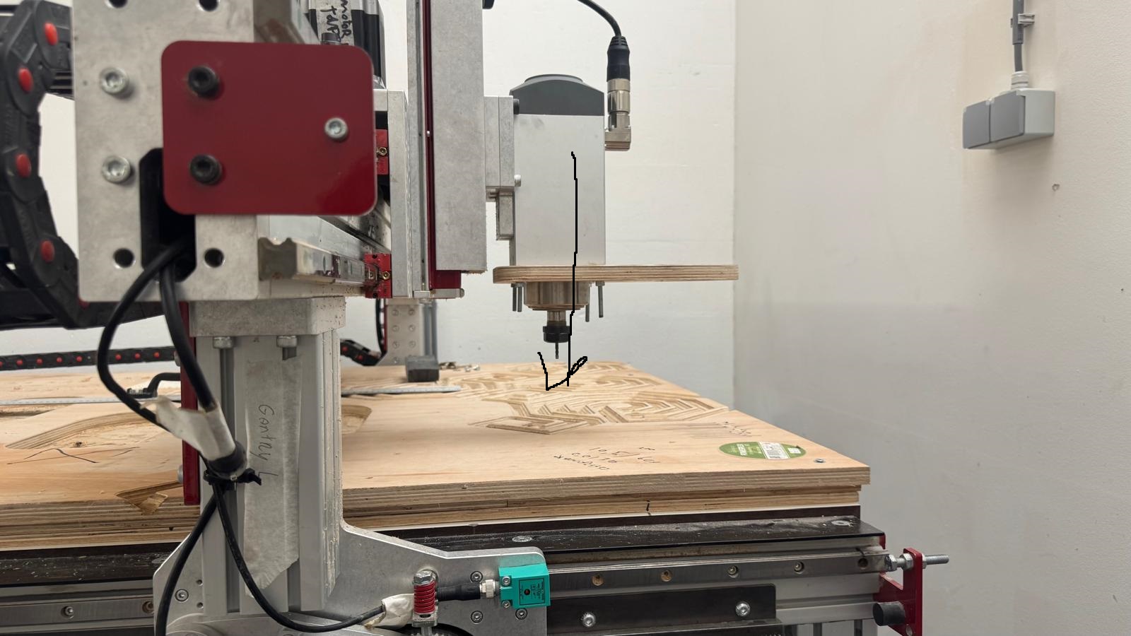

I have avidcnc from 2017 from wich i recently replace the breakoutboard with a mesa7i76EU to make it work with linuxcnc.
Everything seems to be working fine,
The only problem i have is that it doesn't seem to use the WCS coordonates after i zero my machine But keeps using only the absolute coordinates when im running my gcode
This causes the machine(zaxis) to move into the bed when starting the program.
can somebody help me please.

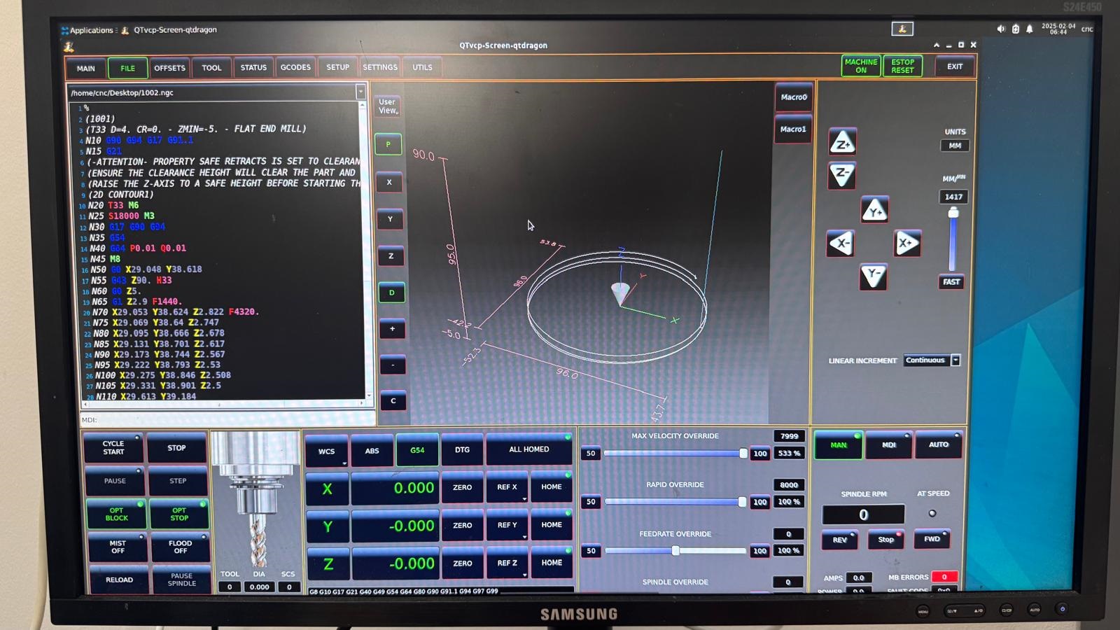

Because we had problems with mach4 and our hardware wasn't compatible with linuxcnc.
and oops i see i frogot to f11 in my picture but there isn't that much more info only the status bar. but maybe you can see someting extra, im very new to linuxcnc/qtdragon so to me everything looks normal.
i added a picture with the fullcreen gui

Does t3 have x or y offsets in the tool page?

no it does not have any offsets

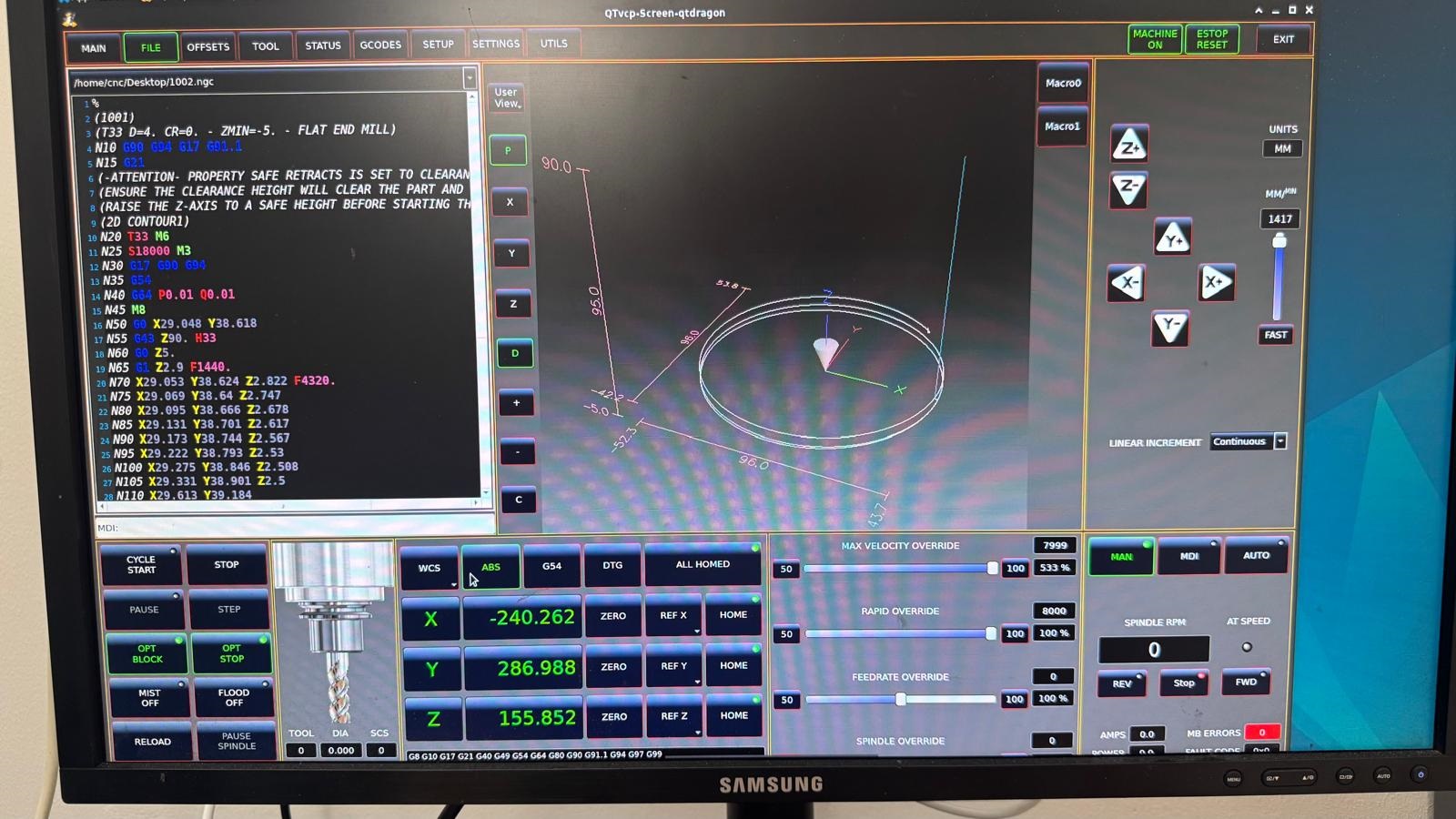

it also moves down before the spindle even powers up. my g54 wcs is activated and i removed tool offsets. i also removed all probing actions. i'm so lost

Your Z configuration seems to have zero at the bottom, normally not recommended.
I would change Z machine home to top, something like
[AXIS_Z]
MIN_LIMIT = -350
MAX_LIMIT = 0.001
HOME = 0.0
[AXIS_Z]
MIN_LIMIT = -350
MAX_LIMIT = 0.001
HOME = 0.0

correct, i'm gonna change that, it's the safer option. sadly this isn't a fix for the problem.

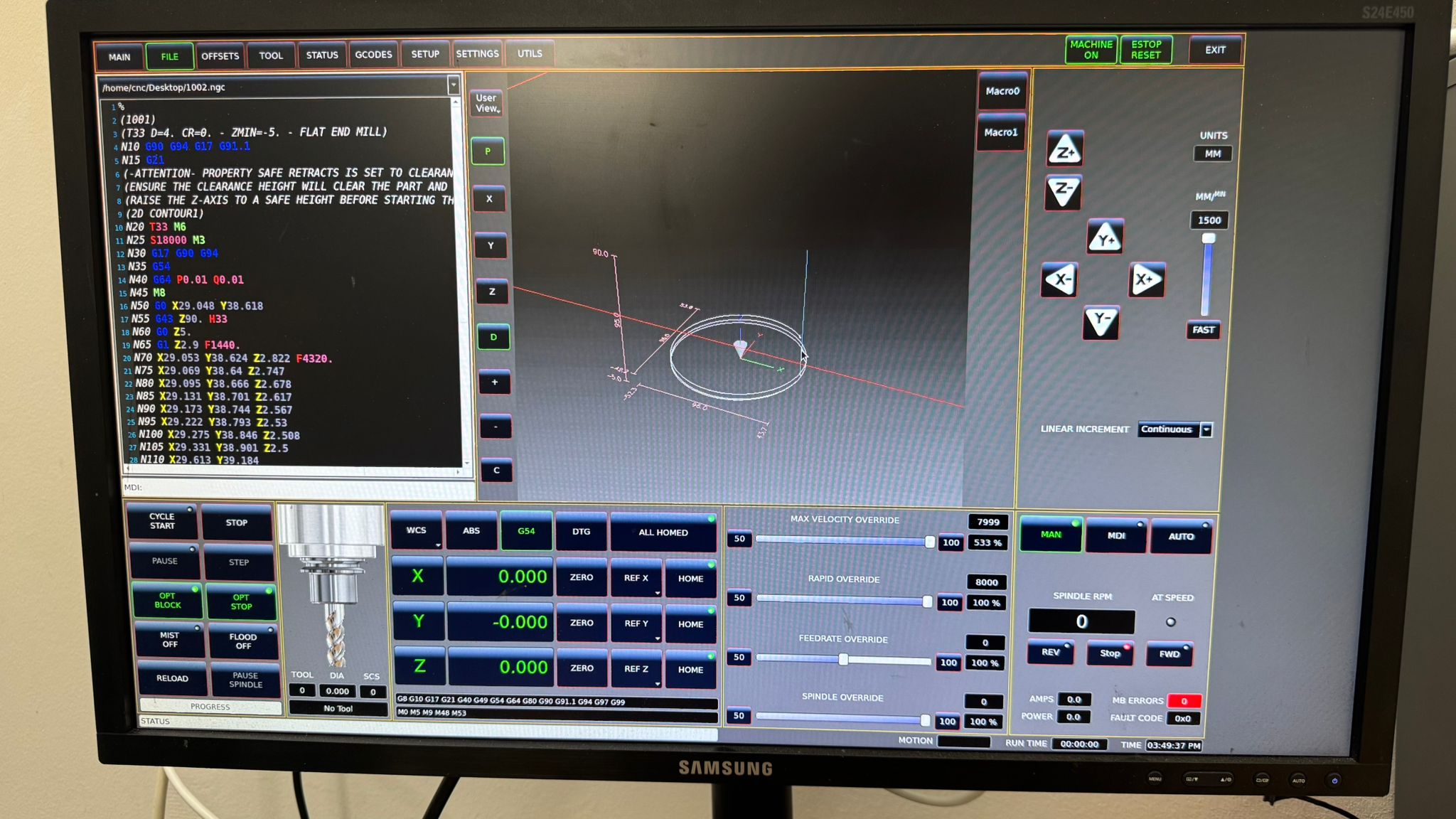

Normally you would home the machine and then touch off on the workpiece origin. the buttons are there to do this but you can do it in gcode with G54
Maybe with your machine you always machine a full sheet but you still need to set the part origin.
