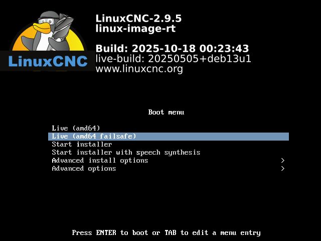

But it seems pretty unstable on my test motherboard. Also, the LinuxCNC splash-screen isn't showing behind the boot menu (where you get to choose to run the live image or to install)
The latter issue has me a bit puzzled. Did that show on your image? Was your starting point linuxcnc-live-build or did you find the official Trixie config set (I haven't found that)

Was replying to you on the laptop but didn't have the ISO there so had to swap machines. Well creakily walk upstairs, I swear I've skipped old age and just gone straight to decrepitude......enough banter.
I guess this is what your are referring to. I would say it appears as it should. Mind I haven't had a chance to test on real hardware yet.
Basically I started with a fresh fork from your repo and made the changes I thought would be required.
Me repo and branch can be seen here, I've tried to comment the changes made within the files and within the commits as well. I think I've even mentioned using the live-build version as well.
github.com/ozzyrob/linuxcnc-live-build/tree/ozzyrob-trixie-test

I am using the Trixie version of live-build, and building on Trixie.
(I basically did a search-replace for "bookworm" in linuxcnc-live-build and swapped to Trixie. though manually and checking surrounding code.)
So I am puzzled where the splash has gone to..
