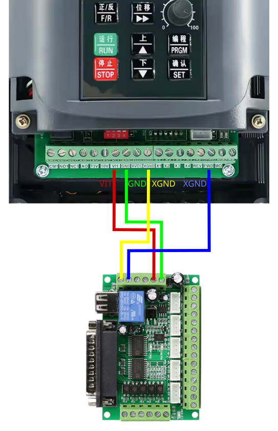

What you need to do depends entirely on your interface hardware.
What interface hardware do you have?

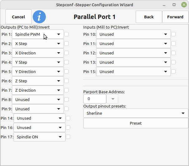

If this is for a parallel port interface with the particular breakout card pictured,
you would use stepconf to add a spindle PWM generator to pin 1 for the spindle
analog speed control, and perhaps use the breakout cards relay output for spindle
enable (pin 17)
enable (pin 17)

Yes, I have the same breakout board from the picture. I thought that the spindle speed is controlled by an analog signal with 0 V to 10 V. I found about this in the documentation (spindle control) but I don't know how to implement it.

So I have to connect pin 17 to the VFD? Thank you!
- Posts: 18122
- Thank you received: 5337
22 Oct 2025 18:42 - 22 Oct 2025 18:42 #336917
Replied by PCW on topic Spindle and VFD control in LINUXCNC
Pin 17 on the parallel port activates the relay on the breakout board
That was a suggestion based on the fact that the VFD in your picture
is connected to the breakout boards relay contacts.

It's working! Thank you!
