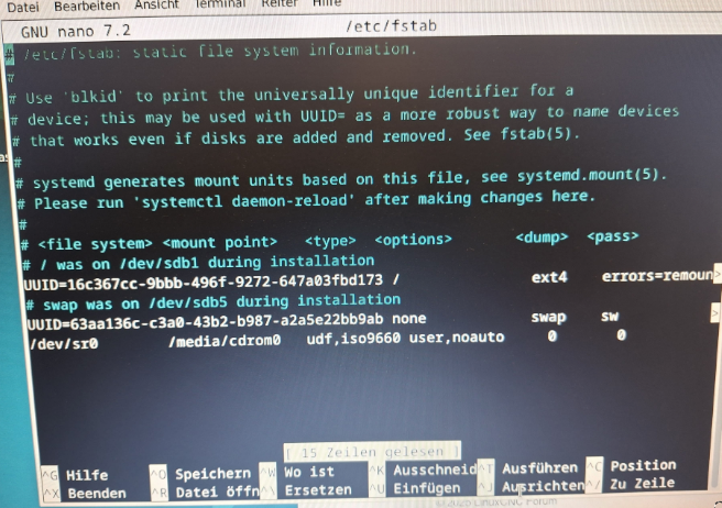

booten dauert lange 1min 30 sek , alles ok

05 Nov 2025 11:54 #337896
Replied by tommylight on topic booten dauert lange 1min 30 sek
OK, that needs editing the /etc/fstab file and omitting or deleting the line containing the uuid of the missing drive.
In a terminal:
sudo nano /etc/fstab
edit and save with
CTRL+o and exit with CTRL+x
Do mind that deleting or omitting the wrong uuid will fail to boot completely.
In a terminal:
edit and save with

07 Nov 2025 07:34 - 07 Nov 2025 08:15 #338025
by karlhe
Replied by karlhe on topic booten dauert lange 1min 30 sek
Hallo tommy,ich habe sudo nano /etc/fstab ausgeführt und
das sieht dann so aus:
siehe Foto
der uuid / ext4 errors=remoundas sollte der sein. der gelöscht werden kann?
karlhe
siehe Foto
karlhe
Last edit: 07 Nov 2025 08:15 by karlhe.
- Posts: 22043
- Thank you received: 7506
07 Nov 2025 09:14 #338030
Add # in front of the line starting with
UUID=63aa136.......
save and exit, then reboot.
UUID=63aa136.......

08 Nov 2025 03:43 #338074
by karlhe
Replied by karlhe on topic booten dauert lange 1min 30 sek , alles ok
Hallo tommy ,
vielen Dank, das hat funktioniert....
karlhe
