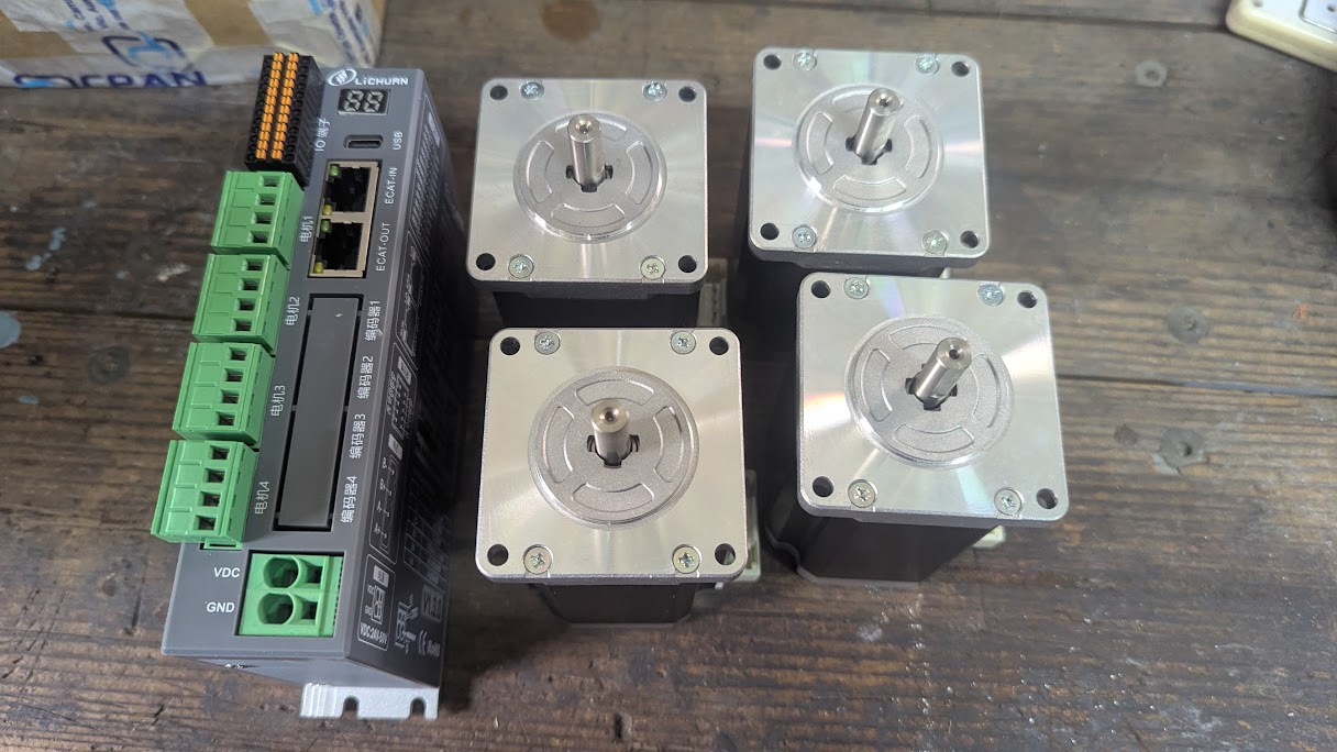

At the risk of adding far more complexity, you could consider Ethercat. There are some interesting options emerging. eg The Lichuan 4 axis stepper driver in a single package. I only hope I can get this going, Also available in closed loop. At USD $92 plus shipping, it competes on price depending where you live.
