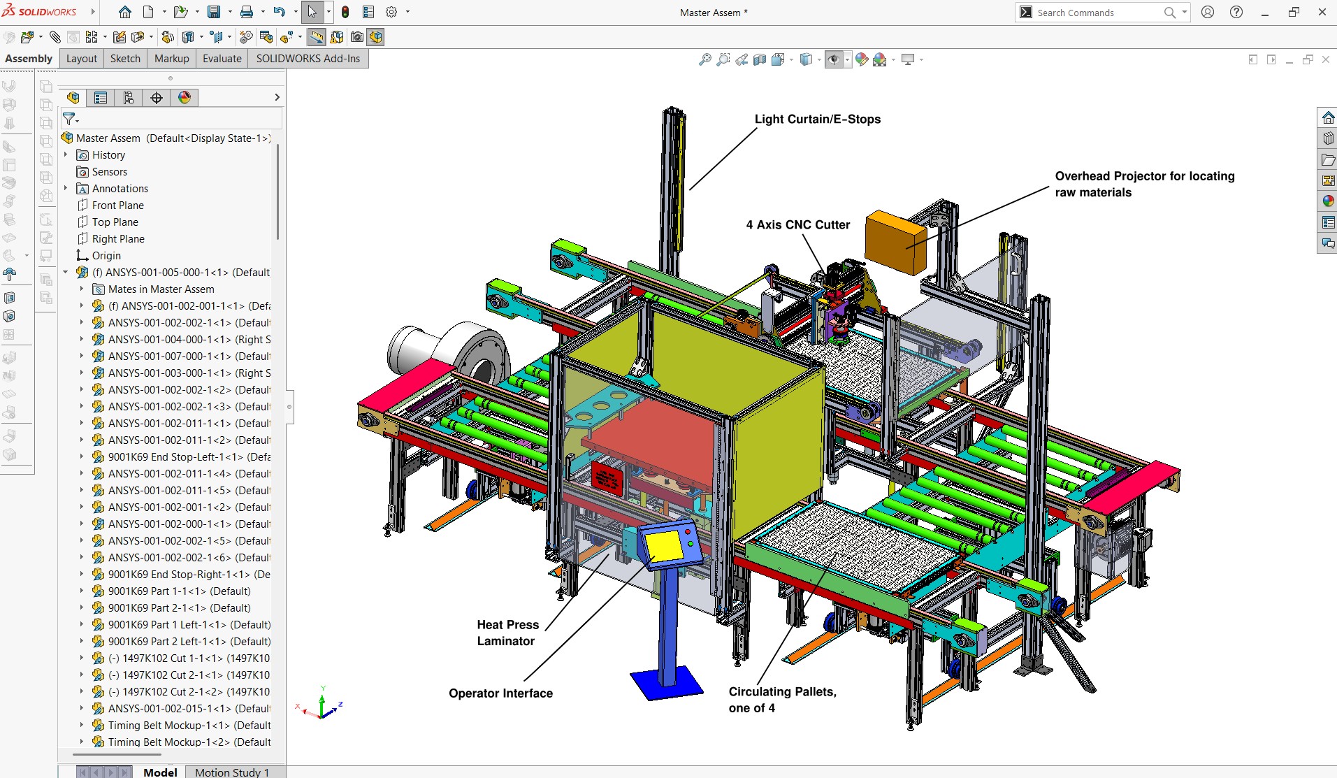

06 Feb 2026 01:58 - 06 Feb 2026 02:08 #342531
by hhscott
Replied by hhscott on topic PLC + LinuxCNC for industrial machine with simple HMI (non-G-code operators)
A few more details:
Because you will have 2 separate controllers (PC with LinuxCNC and a PLC) startup handshaking has to be worked out. In my case, I set up the linux pc to autostart on power just like a PLC does. Then, on the linux PC I set LinuxCNC to Auto Start on boot. After a few seconds of delay, I Auto Start the "Python Bridge" script. The Python bridge requires that LinuxCNC be up and running before it starts because the python linuxCNC module goes out and looks for linuxCNC to be running. This all takes less than a minute.
Once the Python bridge is up and running it does two things, checks the status of LinuxCNC and starts setting and unsetting a bit in the PLC via modbus. The bit sets and then resets every 250 ms. This is my heartbeat that lets the PLC know that everything is up and running. LinuxCNCs status concerning "Power On", "E-Stop active", and "Axis Home Status" are all read by the Python bridge and this information is passed to the PLC through registers and bits. The PLC then directs that power be turned on, after confirmation that the power is on (again through the python bridge) the PLC issues a "Home All Axis" command. After all axis are homes the Python bridge sets a bit in the PLC that lets the PLC know its ready for operation. In this control scenario, the PLC is always the Master controller, it just checks on and commands LinuxCNC through the Python bridge script.
Safety is handled like any other industrial set up. A separate safety controller (not the PLC or LinuxCNC) disables all motion and potential in the machine including disabling the CNC servos. The PLC and LinuxCNC are both wired into the safety output so they both stop any motion in the event of an emergency stop. When the safety status is cleared, the PLC issues a "Power back on" command to LinuxCNC and then a re-home command.
It sounds like a lot, but it is really straightforward and pretty simple once you get the workflow sorted out.
The machine as it is today can produce 28 unique product variations (potential is almost limitless) and the operator only has to select the
product number via the HMI. Everything else is handled in the background automatically. The operator doesn't have to have any knowledge or CNC experience to run the machine. Training takes less than 30 minutes for a new operator.

07 Feb 2026 02:29 - 07 Feb 2026 05:42 #342588
by Marcos DC
Replied by Marcos DC on topic PLC + LinuxCNC for industrial machine with simple HMI (non-G-code operators)
Congratulations on the project, the PLC + LinuxCNC integration looks really nice and the machine layout seems very well thought out and organized.
Looking at the machine layout (heat press laminator, 4-axis CNC cutter, pallet transport, and the overhead projector), I was curious about the main application: is it aimed at processing sheet/panel materials in general (plastics/polymers, MDF, composites, laminates), or is it focused on a more specific material or process?
In my case, I’m working on a different kind of machine, more focused on laser cleaning and painting, with a modular gantry-style structure (about 2 m modules, extendable up to ~16 m on X, with ~2000 mm usable Z and ~300 mm Y). So it was really interesting to see how you handled the integration and the production flow in your system.
Regarding the integration approach: I started by trying to validate the same PLC-as-master / LinuxCNC-as-motion-controller model using mb2hal / Modbus directly, just to keep things simple and close to the field. In practice, I ran into some interoperability issues with the specific setup I have (mainly around protocol framing and what the HMI/PLC side actually exposes as “Modbus TCP”).
In the end, I validated the architecture using a Python bridge as well, but instead of Modbus TCP I used OPC UA as the integration layer between the HMI/SCADA side and LinuxCNC. With Python (using an OPC UA client library) talking to a running LinuxCNC instance, I can exchange status, commands, and recipe parameters in a very similar way to what you described: the operator never interacts with LinuxCNC directly, everything is driven from the HMI/PLC side, and LinuxCNC stays focused purely on motion.
Conceptually, the control model ends up being very close to yours: PLC/HMI remains the master, LinuxCNC is the motion controller, and the Python bridge handles the handshake, heartbeat, status propagation, and command flow between the two worlds. The main difference is just the transport layer (OPC UA instead of Modbus TCP) due to the constraints of my current hardware/software stack.
By the way, for systems like yours, do you usually integrate them with a SCADA layer, or do you prefer to keep it as PLC + HMI + LinuxCNC only? And if you do integrate SCADA, have you ever used or evaluated any open-source solutions?
Thanks again for sharing the real-world experience — it’s very valuable to see these hybrid architectures working reliably in production for years.
