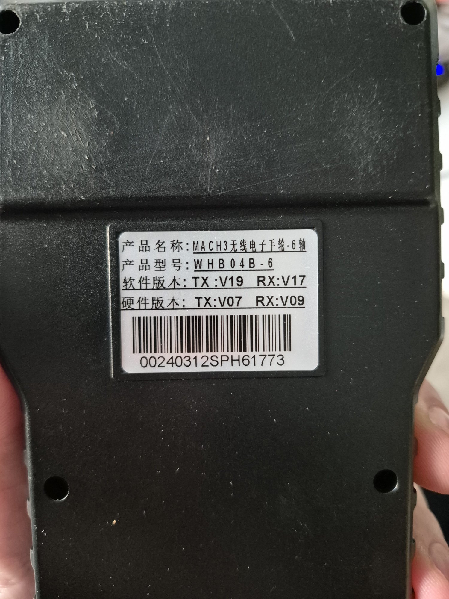

24 Feb 2026 19:42 #343423 by Finngineering
Replied by Finngineering on topic XHC WHB04B development?
I used the mill for a couple of hours today with my firmware in the pendant. I tried my best to cause some issues, but no disconnects from the dongle nor any other issues as far as I could tell. To be honest, I'm surprised that it works this well already.

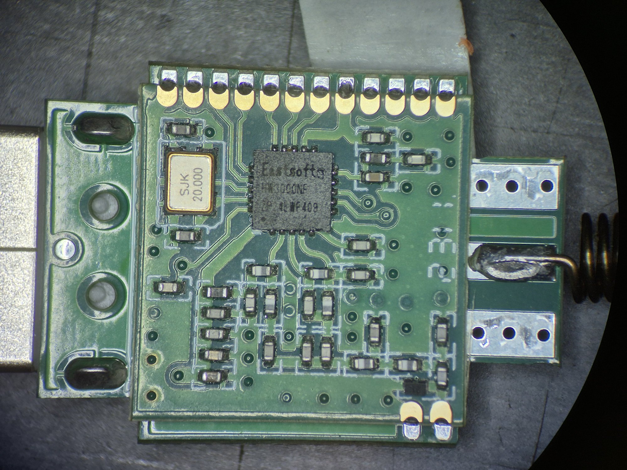

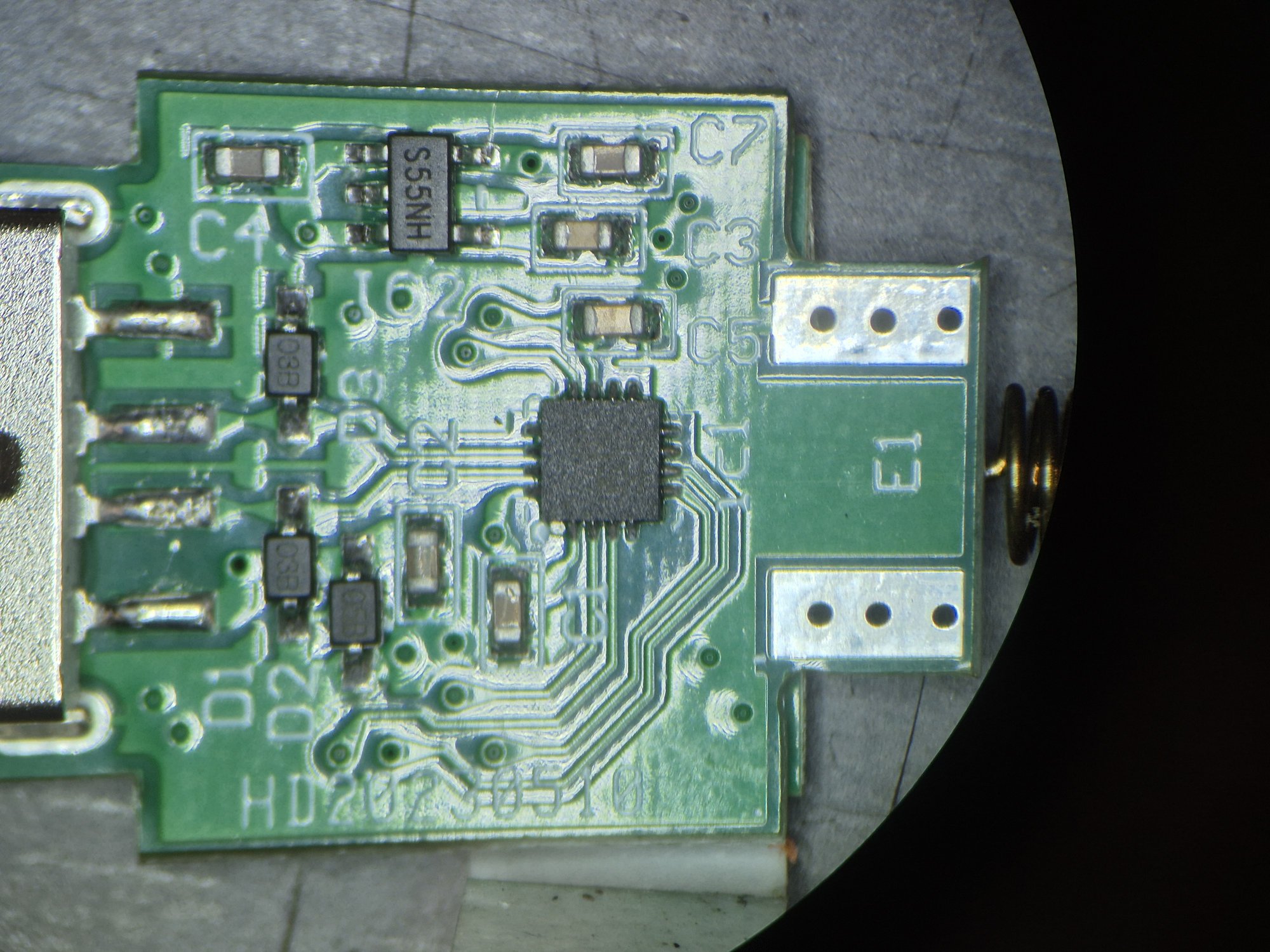

I found a sticker with version information on the back on my pendant (underneath the rubber):
The top row is the firmware version and the bottom row the hardware version, I believe. And the RX should be the dongle, because there is a V09 marking on the main board (underneath the RF module).
And I attach a couple of photos from the dongle as well, in case somebody wants to compare. Not the best photos. I took them through the microscope some months ago. And right now I have a thousand wires connected for debugging, so not possible to take good photos at the moment.

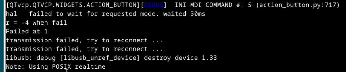

26 Feb 2026 08:10 #343522 by Hakan
Replied by Hakan on topic XHC WHB04B development?
The sticker on my pendant
Had two crashes yesterday. Mode switching. libusb_fill_interrupt_transfer() isn't the solution.
I had commented out the assert() in setupAsyncTransfer and let it continue
Failed here github.com/LinuxCNC/linuxcnc/blob/0673e3...whb04b-6/usb.cc#L541
26 Feb 2026 08:29 #343523 by Finngineering
Okay. I did not really think that libusb_fill_interrupt_transfer() would solve the issue. But that IS the correct function to use in any case.
If the disconnect happens only at mode switches, I'm pretty sure it can be solved simply by modifying the xhc-whb04b-6 component. Maybe we need to add some more (temporary) logging to the component to pinpoint the issue.
It appears our dongle firmware is different by one version increment. But of course the hardware side is the important one for compatibility. I would think that there is a good chance that the hardware is compatible or the same.
26 Feb 2026 08:44 #343525 by Hakan
I have added a bit more logging to the component..
The component is attempting to connect, it says, but I wonder if it actually tries and why that doesn't work.
26 Feb 2026 10:13 #343527 by Finngineering
Do you mean that the pendant did not recover in the above situation after you had commented out the assert line?
You could enable all logging by adding the "-a" option when loading the xhc-whb04b-6 component. It will write a lot of things to the terminal... which makes it easier to figure out if it gets stuck in some specific part of the code.

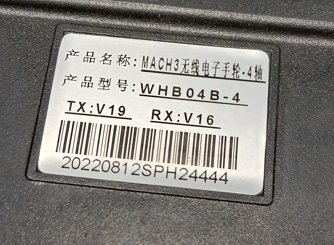

26 Feb 2026 20:23 #343565 by Hannes
Replied by Hannes on topic XHC WHB04B development?
@Hakan:
Strange. Mine doesn't show anything. But it's an LHB04B-6 TX V3 (Wired version)
As much as I read, it should work the same, but might be not.
Starting with -Ha and commenting out github.com/LinuxCNC/linuxcnc/blob/master...whb04b-6/usb.cc#L209 it shows:
out 0x06fefdfe801800bc 060e0800161e0200 06008069006e0000
out size 24B hdr 0xfdfe dom 0xfe status 0x80 coord1 +0024.3772 coord2 +0008.7702 coord3 -0002.0000 feed 0105 spindle feed rate 00110
So it seams the values are sent. Might be my device has a different firmware. With Mach3, I tried already and I didn't see any value. I will try again with Mach4.
